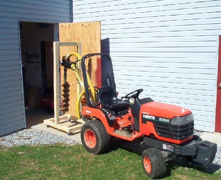

I mad a quick wooden one with a few 2x4's and a few braces to make sure that the corners are strong. I use it all of the time and I can put on / take off the PHD in less than 5 min.
Also, its nice to wheel the PHD back in the corner of the storage area.
Attached the PHD is still on the tractor.
Ken

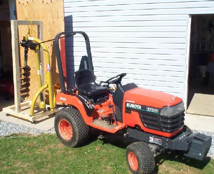

Here the PHD is now on the holder.
Ken

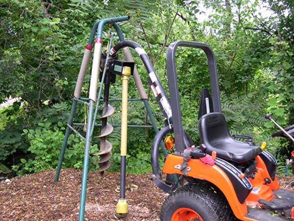

Anyway, I was doing some yard cleanup and decided to finally sawzall the old kids swing set. I put up a nice wood one last fall so it's high time I got rid of the old metal one. I was walking the cut up pieces to my dump trailer and kept passing by my poorly stored post hole digger. (Laying on the ground actually). I wanted to get it up in the air. I ended up using a part of the swingset that was sort of a tripod shape. (see attached pics). A small ratcheting tie down was used to hold the assembly off the ground. There is about 6 inches of clearance. That'll do until I can get the garage built!

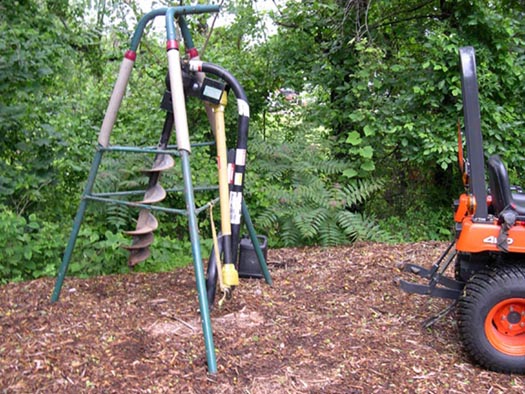

Another pic with the PHD off the tractor.
