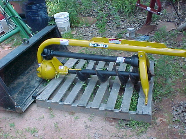

EagleEye,
<font color="blue"> Anybody have a wooden solution (like the wooden dollys)? </font>
Here is my "wooden solution". It's cheap (free actually) and no assembly required. It I had the luxury of storing it on concrete, I would add casters. Since some of my implements are stored on dirt, casters wouldn't work well...instead, I just "fork" them around as needed.
A pallet is not my ultimate solution, but works OK for the time being.

OkieG, that's what we did when I was growing up on the farm.... I have come to find that my general lack of ambition drives me to strive a more ...... "facilitative" solution /forums/images/graemlins/smirk.gif..... Heck man, that looks like to much lifting and work. The good lord knows that I do plenty of work already (my wife is a slave driver ...but I love her). I sure as sugar water attracts bees don't need any more lifting to do... I just came in and it's after 10pm. Thanks for the idea though. I appreciate every one of them!!!!

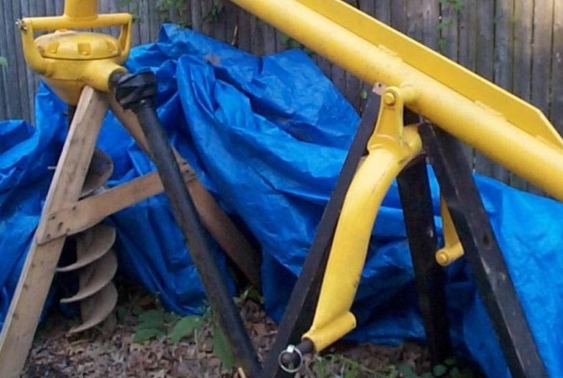

EagleEye:
Finally got the pics. Had to crop to keep within the 100k file limit. This set-up is quick, easy and relatively painless. You could, of course, make them as fancy as wanted. These are light weight, the arms are held together with simple gussets, the concave cut at top was done with simple jig-saw. You can lean the supports up against anything when not in use. The only limitation is you can't move it around. On the other hand the thing is ready for easy mount when needed. Just back up attach pins & PTO shaft. I keep mine stored outside covered by tarp as don't want to build a machine storage shed here as plan on moving. Can't believe some of the comments by those living in **** occupied America about not being able to store your own stuff on your own property however you want.
JEH
PS The PHD is a 50 year old Danuser F series. Bot at auction for $450 (new ones-they still build to the same quality-are $1500-$1700). I have visited their factory in Fulton, Mo-it's run by the grandson of the founder & the company has been around since 1910 and they've been building these since 1943. Only thing wrong was a seal. When I took the head apart, the gears showed no wear & the spindle gear was nearly 12" in diameter, the castings were excellent, etc. This is one lifetime (actually many lifetimes) piece of equipment.
