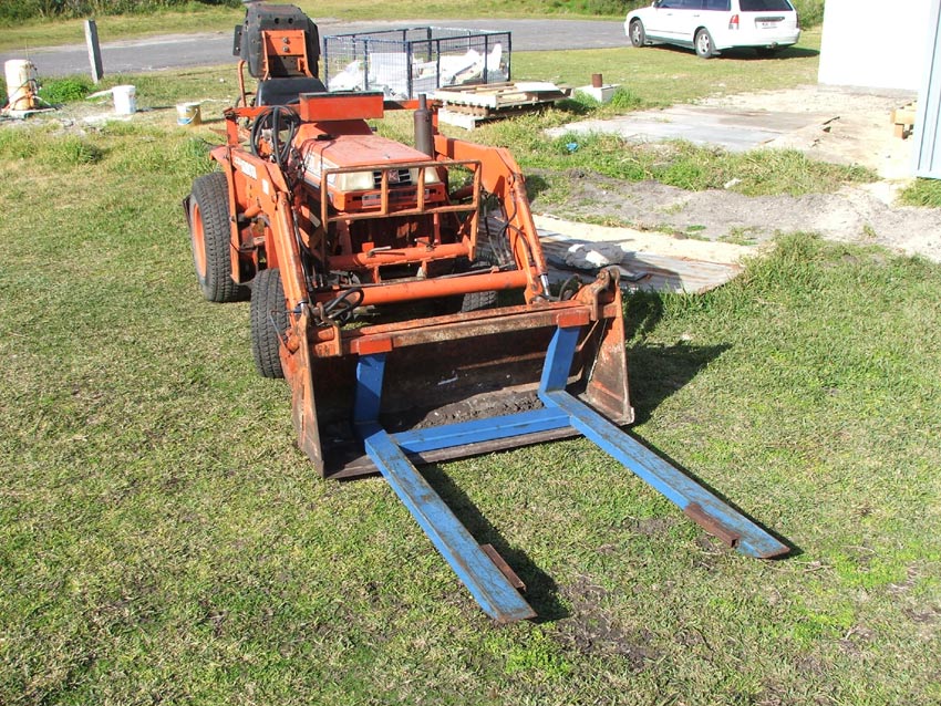

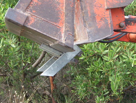

Quick and dirty ripper I attach to the 4in1. Made from scrap in about 60 minutes. Handy for cutting through the thatch of Kikuyu grass that grows very thick and tough here. The forks were pretty cheap but probably cost more than $50 in metal alone.

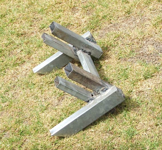

Here is my version of something like that.
That's pretty darn close to what I did instead of a board I bolted on the plow. Thanks for the pictures

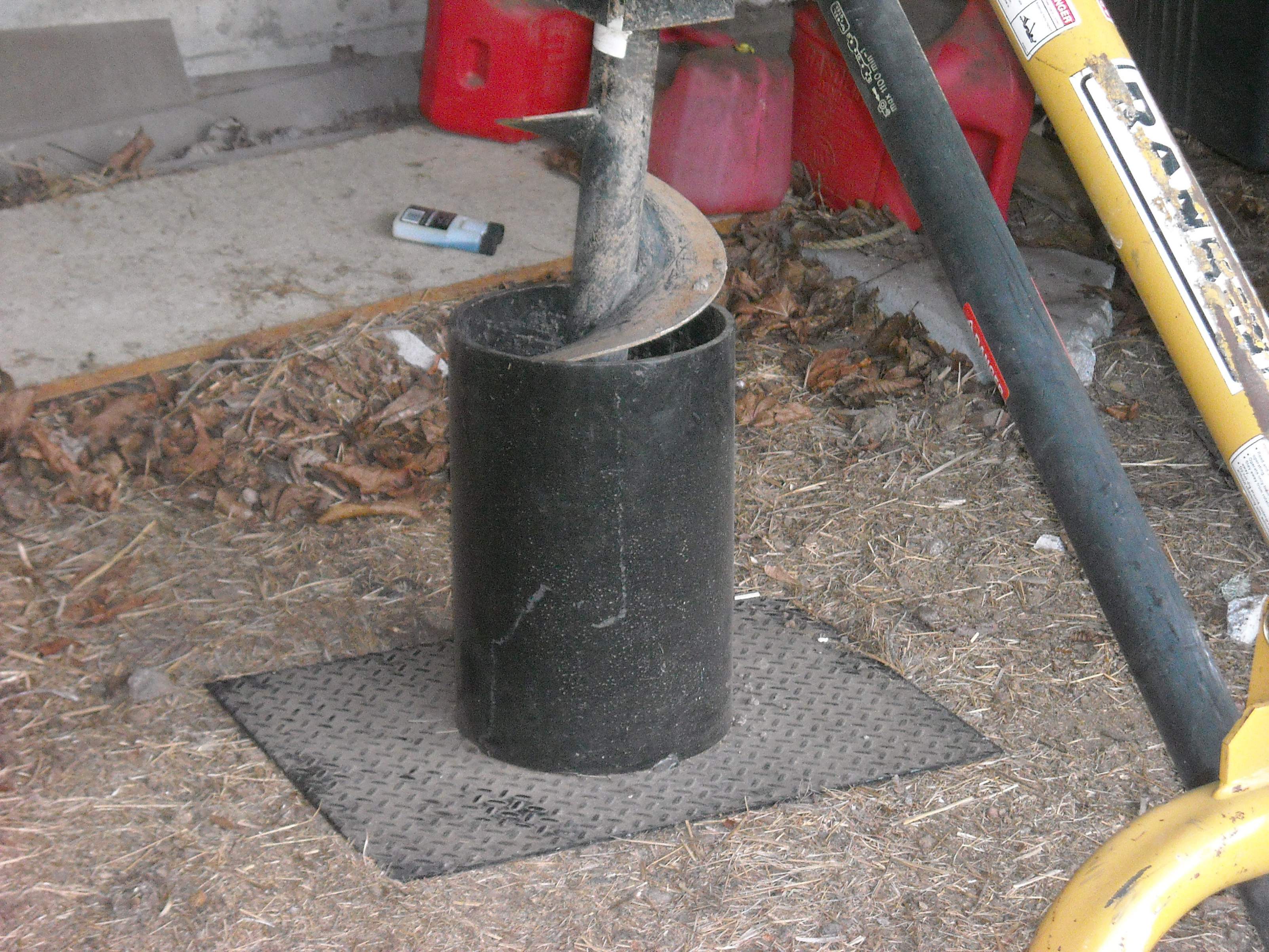

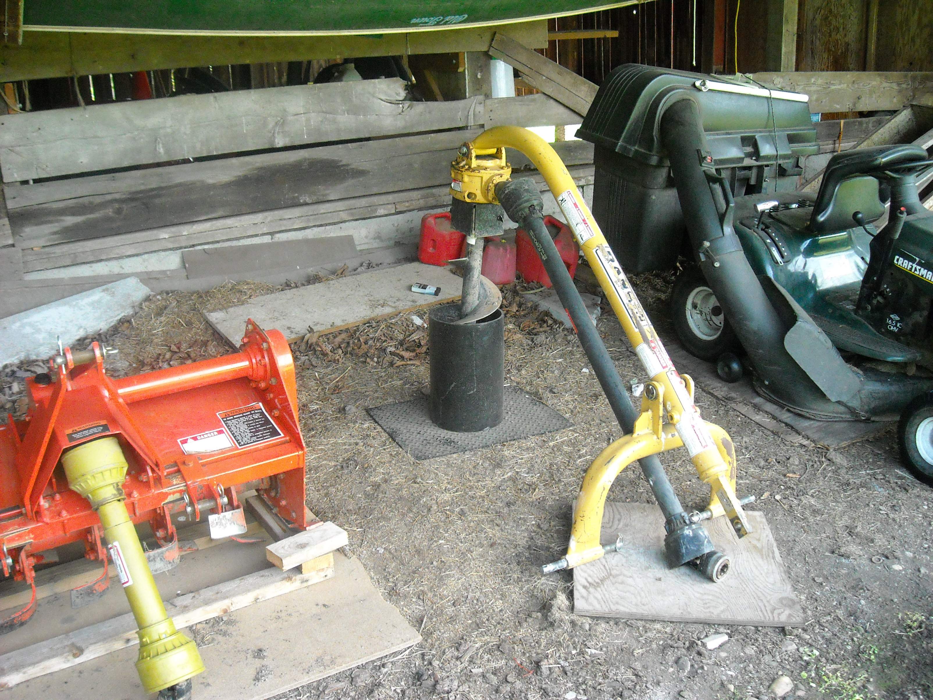

Might be a stretch to call this a tool, but how nice it is to see my auger out of the dirt. Easy on / easy off with no strain on your back. Could easily be mounted on a dolly if you have a concrete shop floor. Mine is made from 1/4" diamond plate, and 1/2" x 10" steel tube (fits a 9" auger). I even had a local shop fabricate it - cut with a plasma torch and welded - including materials for $40.
Auger stand
