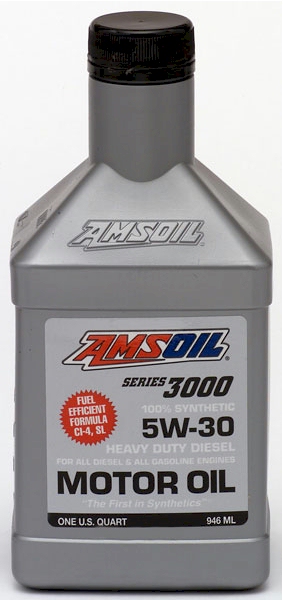

I have recently purchased a Kubota B7800 and i want to use the Amsoil synthetic motor oil. My question is i don't know which one to use for my tractor. Are there any Kubota owners out there that use Amsoil in their tractor?
If so what weight do you use or would recommend.
My tractor has 20 hours on it now and the engine is diesel.
The Kubota manuel recommends SAE30, 10W-30 or 10W-40
above 25 degrees.
Engine oil: API Service classification CD, CE or CF
Thanks in advance,
Piper

This large picture certainly looks like a product endorsement advertisement to me..... /forums/images/graemlins/grin.gif

Piper—I use their 15w-40 HDD&M oil. I feel their series 3000 is overpriced and it is not worth the extra money, nothing really added for the price. Used it (15w-40 HDD&M ) in all my diesel toys since 1997 and works great!
Plus the freeze point is like –45 so pour point is around –20 degrees. Also I think the 15-w40 has a better additive package then a 10-30 or 10-40
If their Series 3000 is so great, compare it to their 15w-40 HDD&M oil and see what the results are.
…Just my slanted pitch.

I would not use a 5w-30 in a diesel since there is no need and a 15w-40 does have a better add' package. I believe in Amsoil's case the freeze temps are very close so what does there 5w-30 Series 3000 get? Only a higher invoice or bill.
