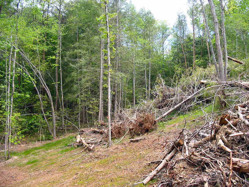

How many hours are on your PT?
I'm running reversed wheels AND I've loaded them with windshield washer fluid (and tire sealant). I loaded the tires about 100 hours ago and reversed them about 50 hours ago.
Personally, unless this becomes a chronic, "high failure item" from doing that, I'll trade the increased safety and stability for the increased cost of maintenance. I bought my PT to work on hillsides, because it is one of the best machines to work on hillsides, and these changes increased its capability to do so. I've attached a picture of the kinds of areas I'm using it...
If I can't safely use it on my slopes, then I don't need the PT -- it's really that simple...
