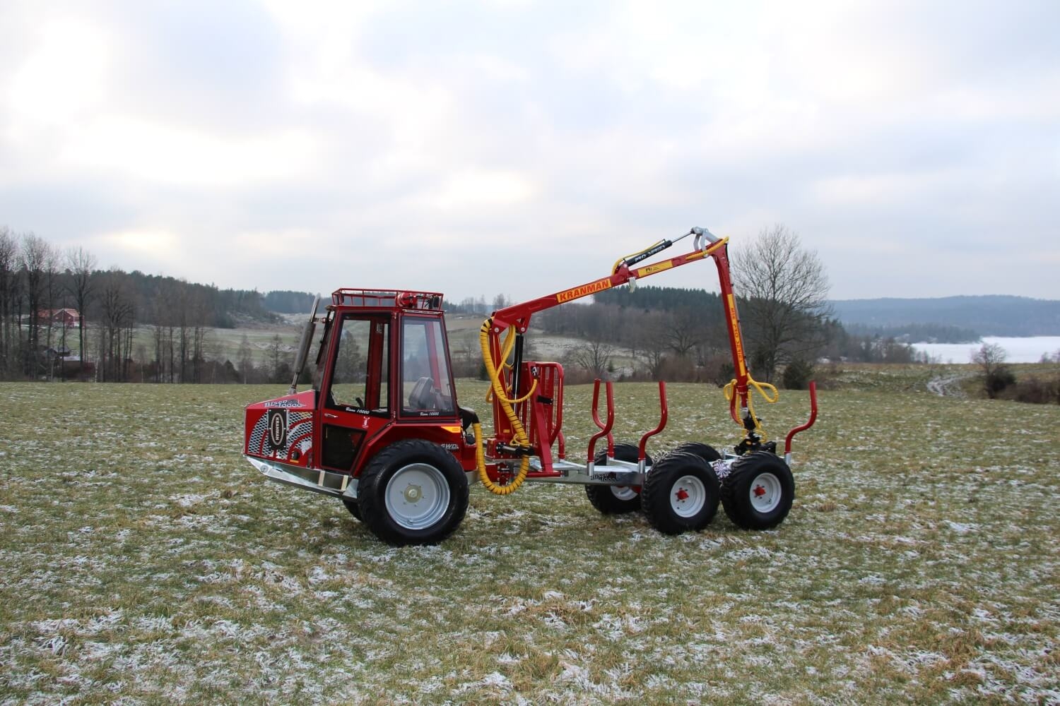

You're looking to build a forwarded similar to the Kranmann's ones right? Like this:
   / Wheel motors for forwarder
#13
Thanks again, good info and I am starting to understand a bit better. Yes it is just like the Kranman machine I want to build but with all 6 wheels equal size. I could build it with differentials and this would be much more within my skill set as I have built several competition offroad trucks. I think if I end up going down the differential route I would just do a conventional automatic transmission and 4wd transfer case and ditch the hydraulic drive idea. I just like the simplicity and robustness of a hydraulic wheel motor at each wheel, but maybe I am kidding myself.

I am going to build myself a timber forwarder with crane. It is going to be 6 wheel drive and I would like it hydraulically driven. I am thinking of using these for wheel motors : Silnik hydrauliczny BMR chłonność: 200cm3/obr obroty: 300obr/min z łożyskowaniem do rębaka
I am after some advice on a pump for this and also how you plumb up 6 motors like this. Do you plumb them up in series ie. feed goes into the first motor and then out of the first and straight into the 2nd, and so on. I need all 6 motors to turn all the time. Engine will be a 2.5 litre turbo diesel with around 110hp
