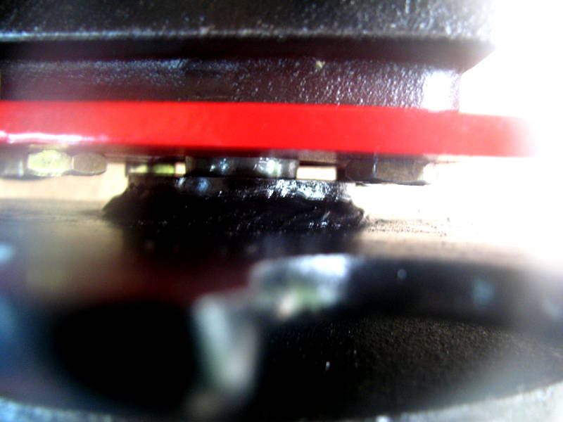

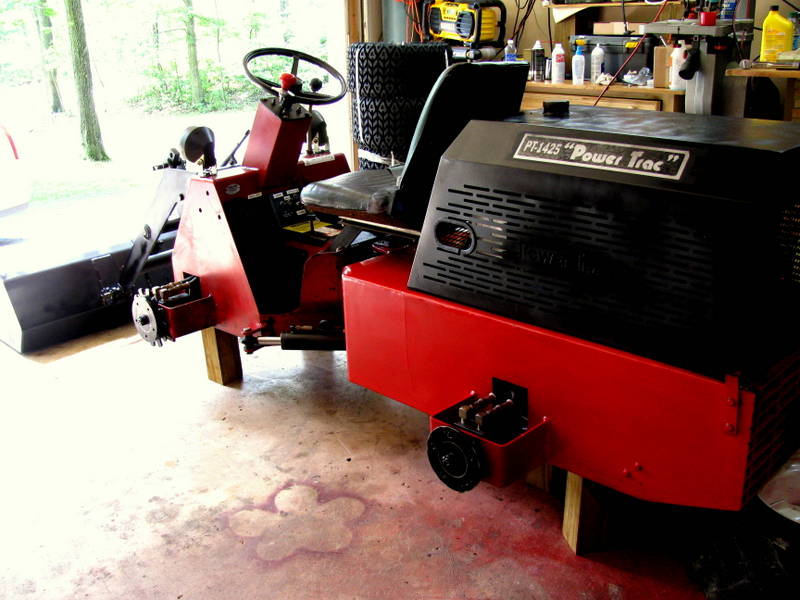

Knew when I bought it It I might have to do some work, guess this will be my first test.

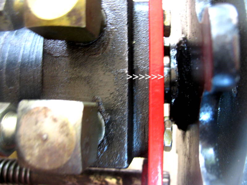

Getting ready to replace my old tires so when I took off the old bars. Noticed a little oil spot on the floor next to the front right wheel motor guessing the seal.. I was thinking maybe when I sprayed lube around to clean off some of the dirt, It might possibly be left over lube.
But now looks like straight motor oil. So guessing I have a leaking seal.. I did notice a slight vibration early on going up hills.
Could a leaky seal also indicate a bad bearing and thus vibrating under load. I know there's threads on here about wheel motor replacement but if anyone wants to chime in on the routine of rebuilds and cost I'm all ears.
Doesn't look like a bad leak but guessing If I drive it for any length of time it will get bad quickly..

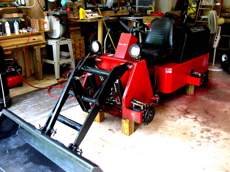

Also I started the machine up on blocks and noticed the front right motor turns and the left rear turns.. The other two are stationary. Is this normal or do the other two kick in when the others come under a heavy load.
Guess I will be giving Terry a call in the morning.. See what they charge to rebuild it.. Understand the brake disk is pressed on..

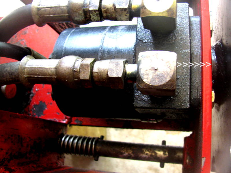

I see that your wheel motors have a case drain.
/ Wheel Motors
Still newbie to hydraulics J.J...
Plan to start doing some reading .. By your statement guessing some PT wheel motors do and some don't ? .. Is there an advantage to having a case drain..
/ Wheel Motors #4
I found this.
advantages are : Contamination control ---flushing the motor case .
Cooler system ---- exiting oil draws motor heat away .
Extend motor seal life ---maintain low case pressure with a preset restriction installed in the case drain port.

I didn't think any of the wheel motors should turn if its up on blocks and the treadle is centered. I also think it should be all of them turn or none of them turn if the treadle is out of adjustment.
As I understand it (and that's dubious at best), your right front and left rear are in series, and your left front and right rear are in series. That makes two circuits and enables the tractor to turn left and right without the wheels fighting each other and skidding on the ground. Then, those two series circuits are connected together in parallel, so that they all get forward or reverse flow at the same time as called for by treadle pedal movement.
If any of the wheels are turning when the treadle is centered, your treadle is out of adjustment. No wheels should turn when its centered. Depending on your tractor, you'll have to find the correct treadle adjustment from Power Trac.
If one of the series circuits is turning and not the other, then that would indicate some greater resistance in the non-turning series circuit. Is this a problem? I don't know. It would depend on what's causing the resistance, I'd guess. Maybe its just that there is so little resistance that only one is turning. It it a really slow movement?
I'd contact Power Trac and ask them how to adjust your treadle for center. It could just be right at the hairy edge of perfect. Once they tell you how to adjust it, you'll be able to make the wheels turn one direction, then not turn at all, then the other direction. Once you find the exact center, no wheels should turn.
Again, only a guess, but if one series circuit has more resistance than the other, I'd guess that as you adjust the center for neutral, that one circuit that is creeping now will also be the circuit that creeps first in the other directions. Just a guess, though.
But I'd definitely find out how to adjust your treadle for neutral movement at center first before doing anything else.
