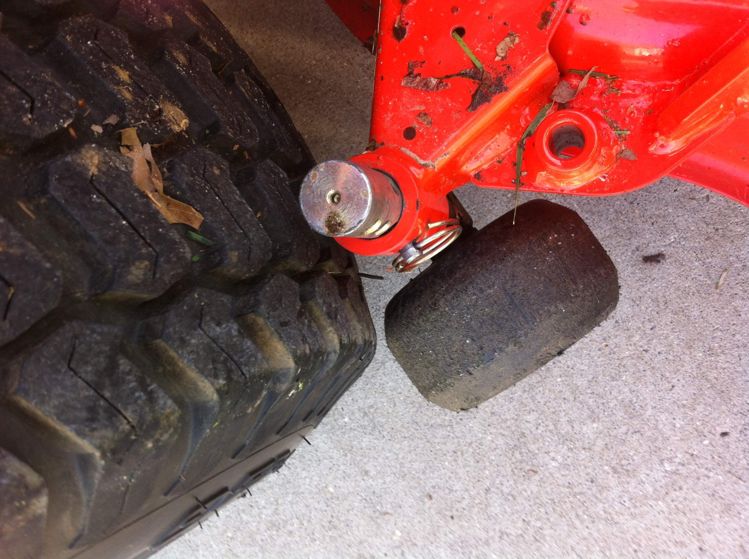

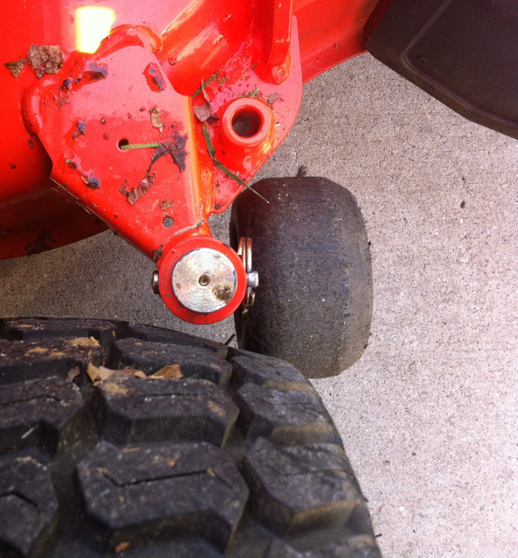

I have a 54" MMM on my BX25 and the 1.5" just barely cleared the right anti-scalp wheel when the deck is lifted, I don't think the 2" would clear for me.
You definitely aren't going to spin those puppies 90 degrees for removal!! That's a tight fit!!
They specify them as only working with the 60MMM, so I have them on my 2660 with 60MMM but never installed them on my 2200 with 54MMM
Yes there was no guarantee that it would work, but we gave it a try, and it just makes it. Only by a little bit, but by enough. There is plenty of room on the other side, no issues there. Maybe it will not work for another person with the same tractor and deck depending on deck adjustments or other variables and differences.

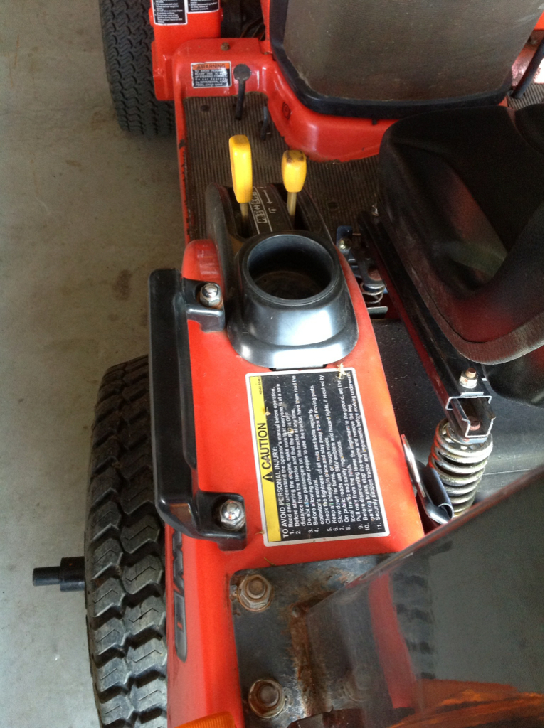

I've got a BX2230 with turfs. I have no spacers. But my tires extend beyond the fenders almost as far as the pictures I've seen of R4's with spacers, most recently 4shorts incredible mod'ing thread. I have the 60 inch mower and I have to drop the mower about 1/2 way just to get enough clearance to get the pin inserted. If the guide wheel is already turned and I don't change it, it rides up the outside of the rear tire. I'd love to put a spacer on, but there is just no way I have enough room to do it. Are turfs that much wider than R4's?
Sent from my iPad using TractorByNet
It sure looks like it from post #4.

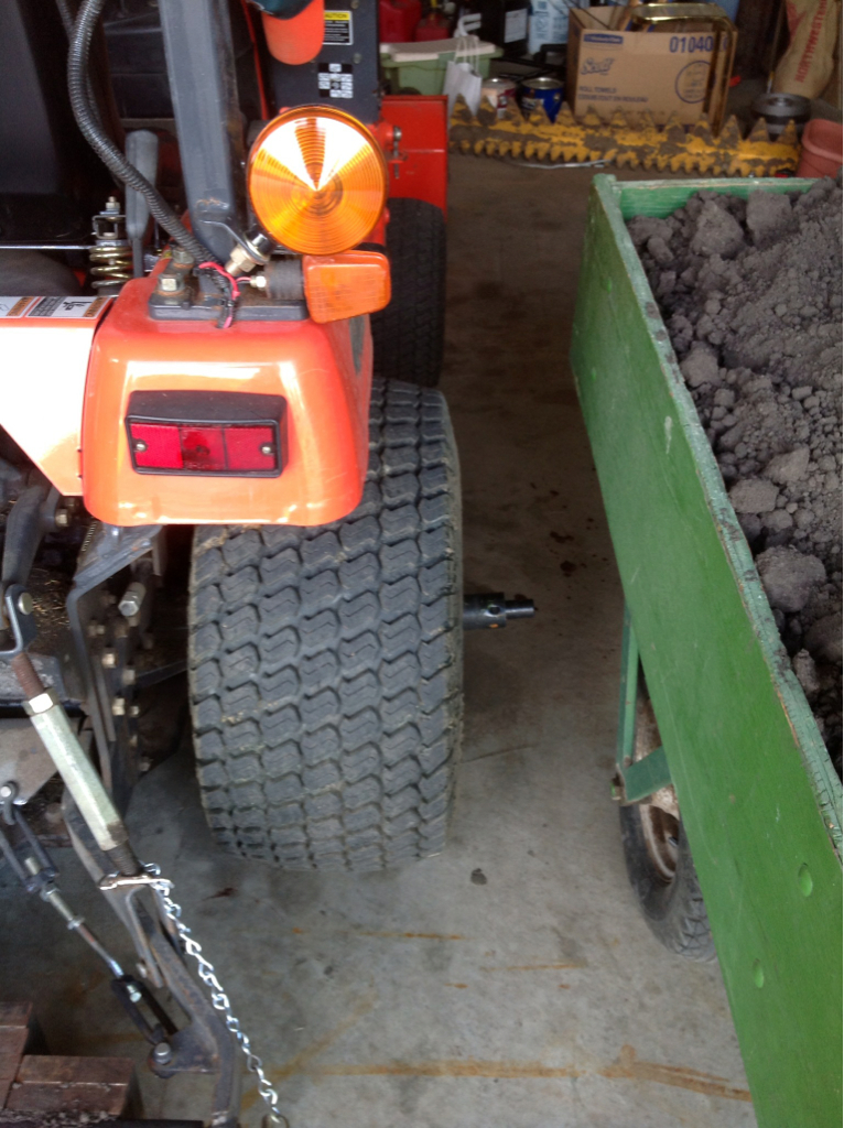

And here is min BX2230 with stock turfs. Either the fender design has changed or turfs are much wider than R4's.
They sure look wider than my Industrial or Bar tires.
