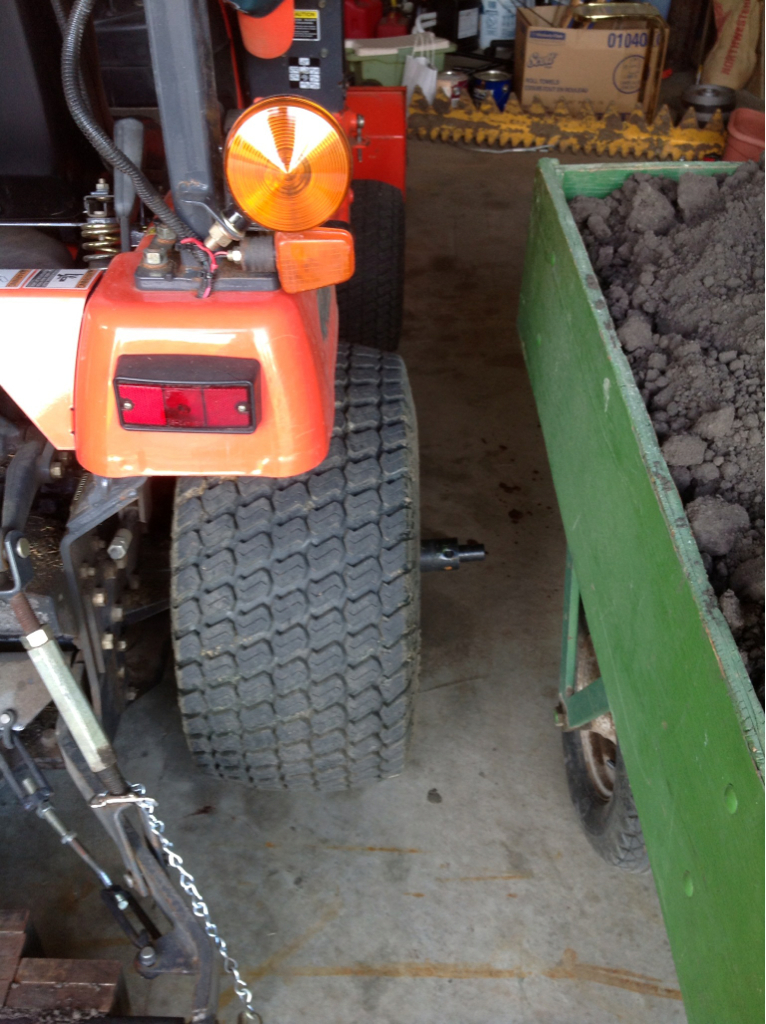

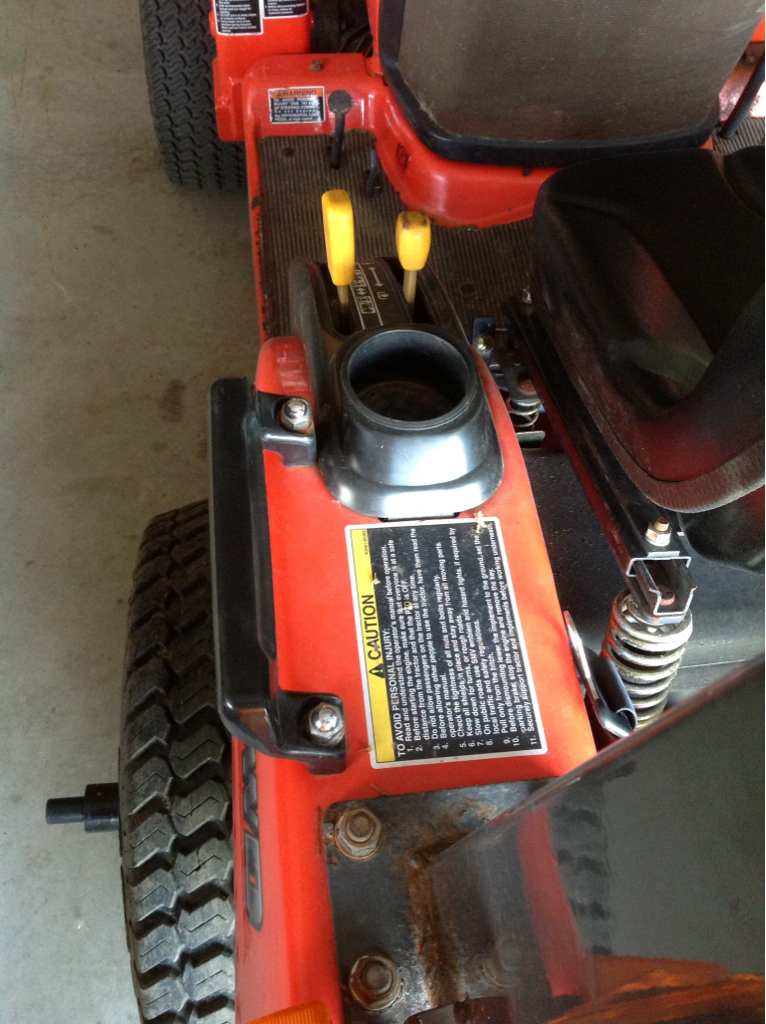

And here is min BX2230 with stock turfs. Either the fender design has changed or turfs are much wider than R4's.
Sent from my iPad using TractorByNet
I have what looks like the same tires as you on a 2008 BX25 and with 1.5" spacers installed. I just measured 47.25" outside to outside of the tires measured at the outermost point of the sidewall. So without the spacers it would measure 44.25".
