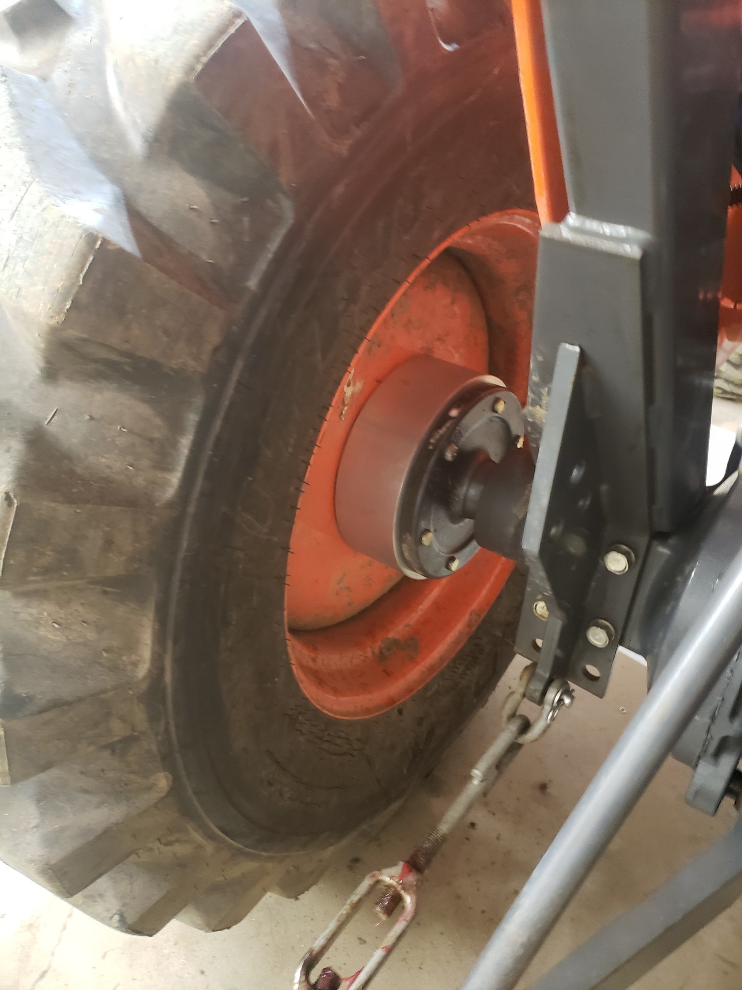

Wheel spacers arrived. They are nicely made. The fit is perfect. Here are a couple of pics of the installation. Use a torque wrench as instructed. I'm using a piece of metal rod with pvc pipe over it to lock the hub and protect the studs from damage. Just had time for 1 yesterday. The forklift is a big help. More on this later.

Got the other front done yesterday. Took me about one hour. All the old wheel studs had to be double nutted to be removed on this side. That's tideous and time consuming.
Now I'm thinking about how to handle the fluid filled rear tire R&R. Obviously the forklift but I'm concerned the tire may tip over when the machine is moved. I either need a helper to steady the loaded tire or some sort of restraint.
