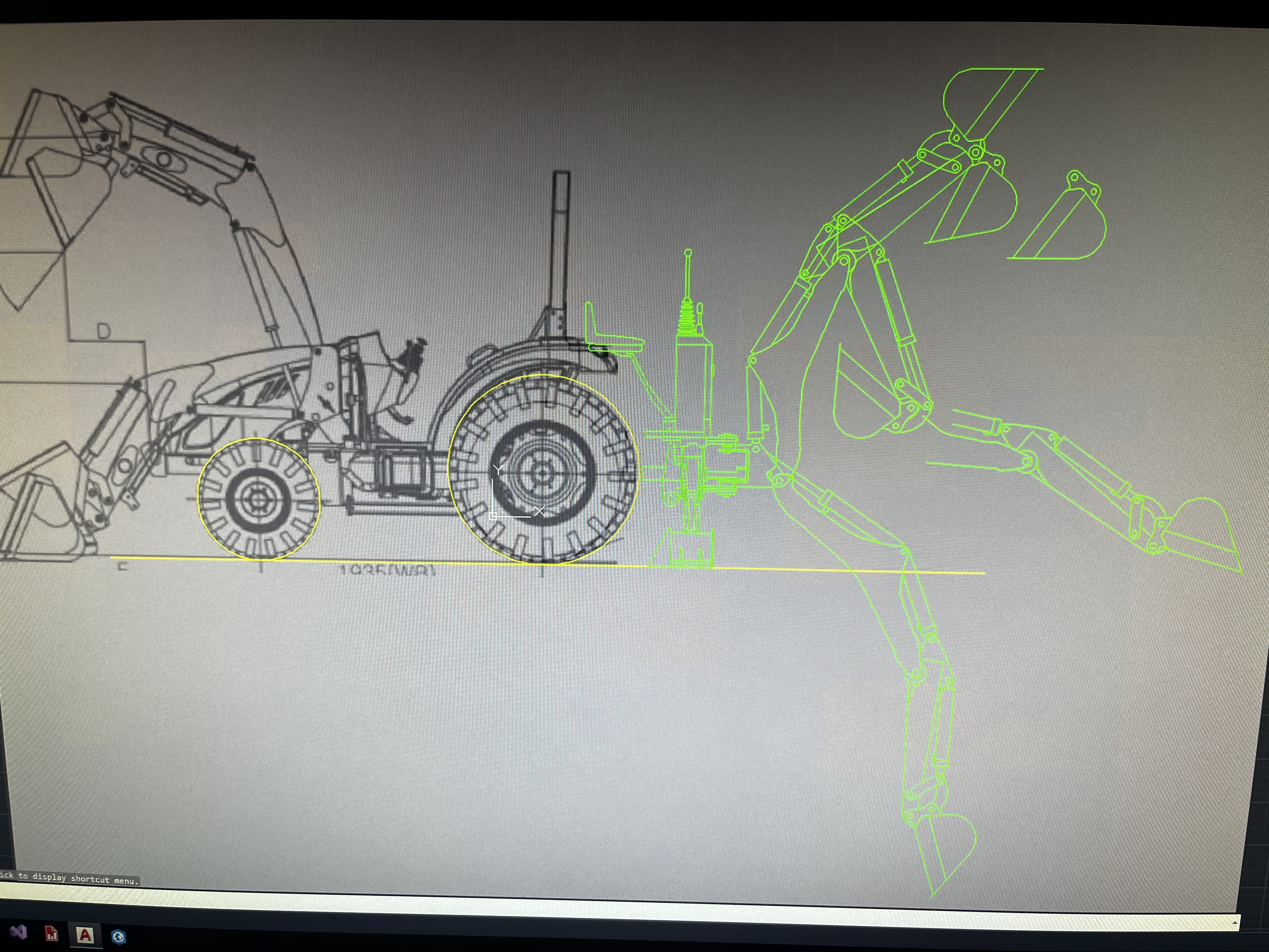

I just went through and did my best to recalculate the widely published (and generalized) CG being “two feet in front of the rear axle and 10” above its center” for my tractor at rest. With front tires filled 75%, rears filled 50%, a backhoe installed, empty and folded in and loader bucket empty tilted up at the bottom for transport, the weight parameters moved the CG horizontally toward the rear 4.87”.

Still more work to do, but this scale drawing of my TYM T574H TLB is coming along nicely! CAD guys love drawing puzzles like this.
