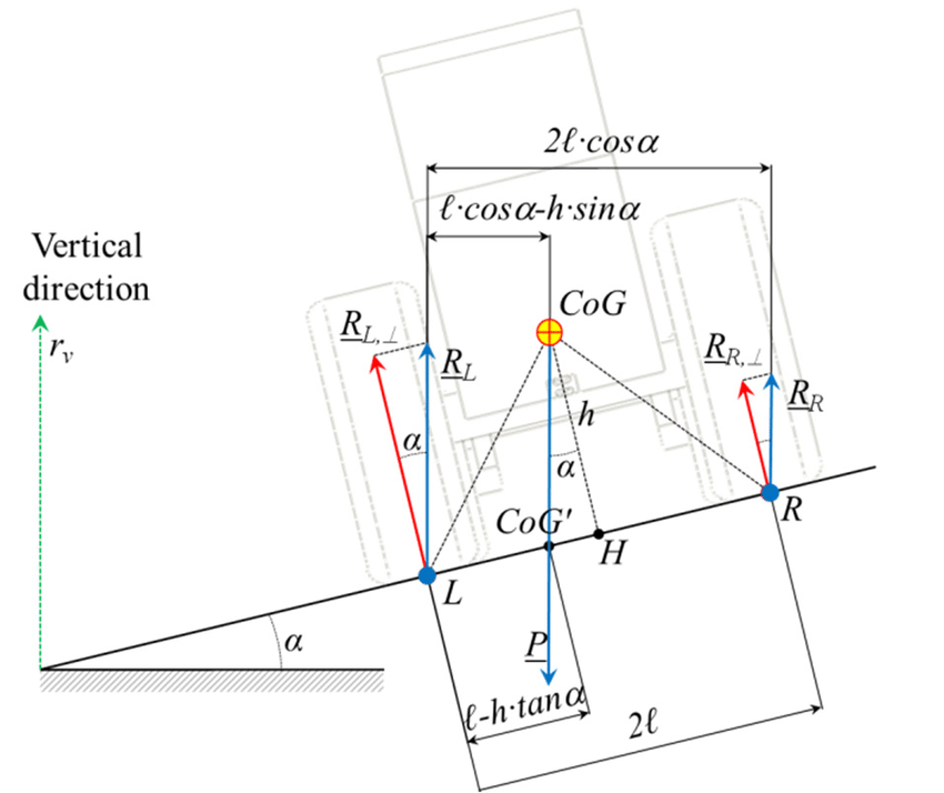

As rScotty points out, nothing beats a wider stance for hill stability.

I am trying to quantify the benefit on different spacer widths and am working on the maths. All I see on the forums is “It’s so much better!”, but no-one has any tangible information like, “On a 15% cross slope, with 2” spacers, it will take X more amount of force to tip the tractor. With 6” spacers, it will take Y amount.” I know I’m weird, but knowing the numbers eases my lack of confidence.
I had them ballast the fronts and rears, giving me about 350# up front and 1,400# more in the rear - no brainer there. And I get that this helps incrementally keeping a lower center of gravity. But, how much is actually gained from 2” spacers? I see the 6% increase in width adding to the leveraged length. But monetary outlay being similar, is it worth risking the perceived mechanical strain on the axles and getting 6” for 18% increase in leverage length?
I know a dork like me has done the calculations, I just can’t find it. If I end up creating it, I will share it. This is the closest thing I found and plan on starting here:

I wouldn't either - not without more measurements. Nor would I load the fronts. The front axle pivots in the middle, so it's a whole different situation than the rears. Adding front wheel spacers will keep the axle on the ground, but it won't prevent the body of the tractor from tilting.
   / Wheel spacers #9
We've had this discussion many times here. I believe spaced front tires do help with stability. The front axle pivots until it hits the stops. If the tires are spaced out they hit the stops sooner. Of course, to each their own.
   / Wheel spacers #10
I don’t envision that being the case. In my mind, your front tires could be 6 feet apart or 6 miles apart. In either case , the rigid tractor body and rear end will still have to rotate the same number of degrees, and lift the high side rear tire off the ground the same distance in either case, to cause contact of the fixed front axle pivot limit stops.
