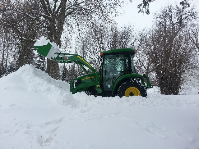

Sorry if they is a repost I'm sure it is.
If I flip my tires does it really give you a 4" wider footprint? Growing tired of the trippy feeling. Want to flip the tires and add 2" spacers to each side. Wanting a total of 8" of width. So figired I would ask if the tire rim flip is 2" wider per side.

2520 was awesome but the 3320 is amazing and not nearly as underpowered as people say. I was pushing walls of wet heavy snow dif locked on b range with good gravel traction below the 8 inches of heavy wet snow pushed like a tank at 5mph.
In a perfect world I wish I cold of kept the 2520 it could get into tight spots and it was an amazing little work horse.
Thanks again everyone for the wheel spacer questions soon as uncle sam gives me my tax money ill be ordering some.
