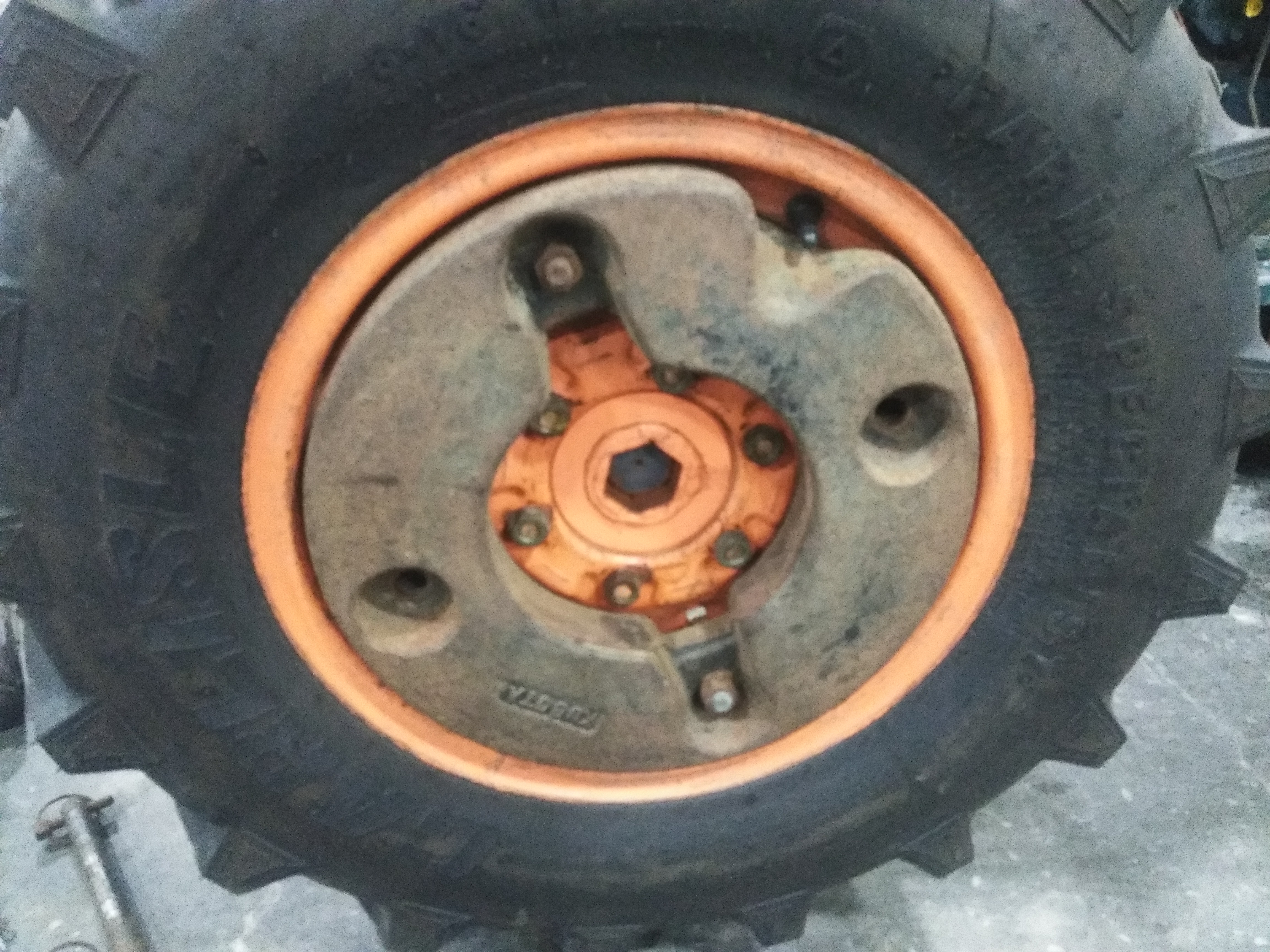

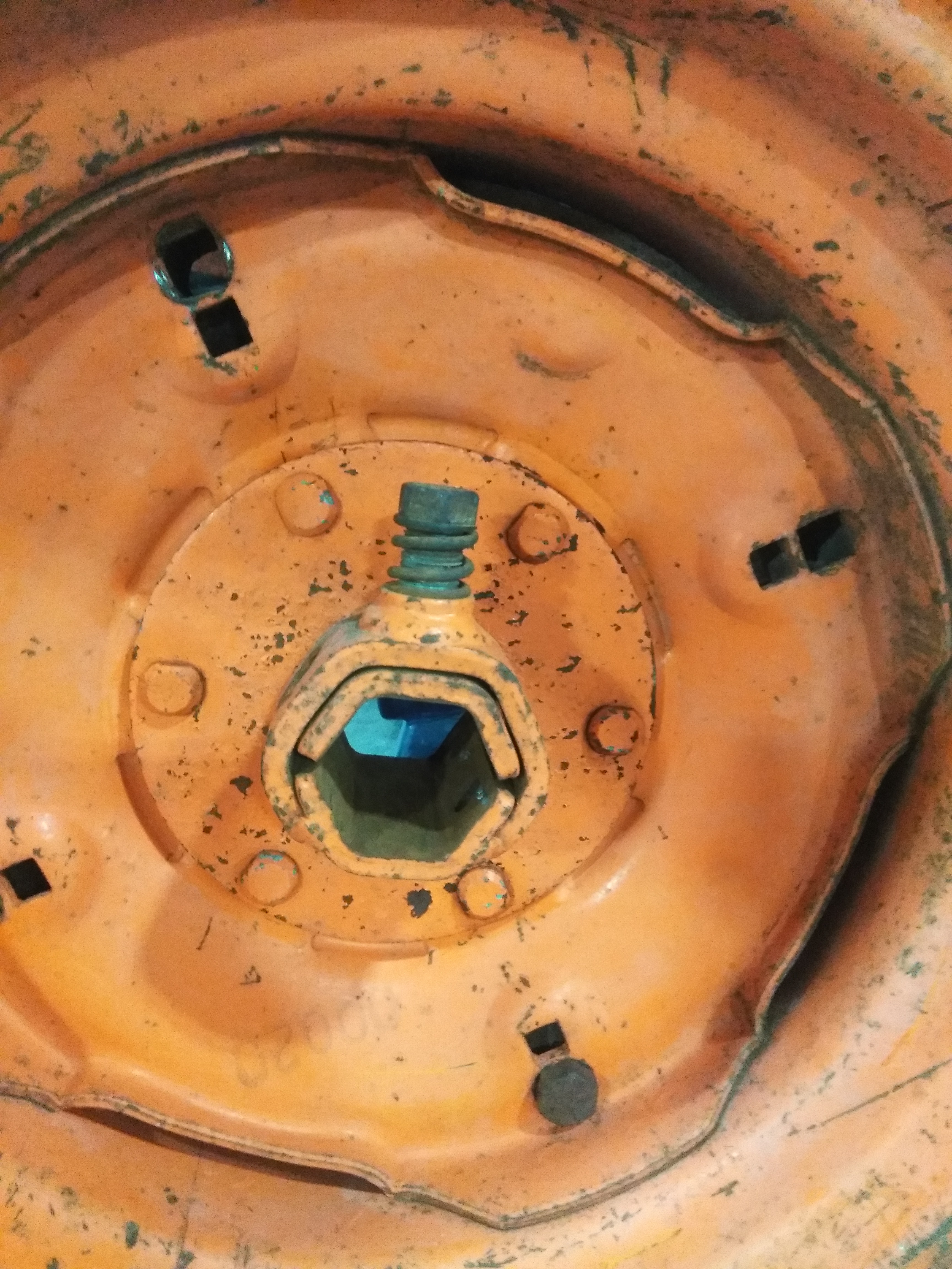

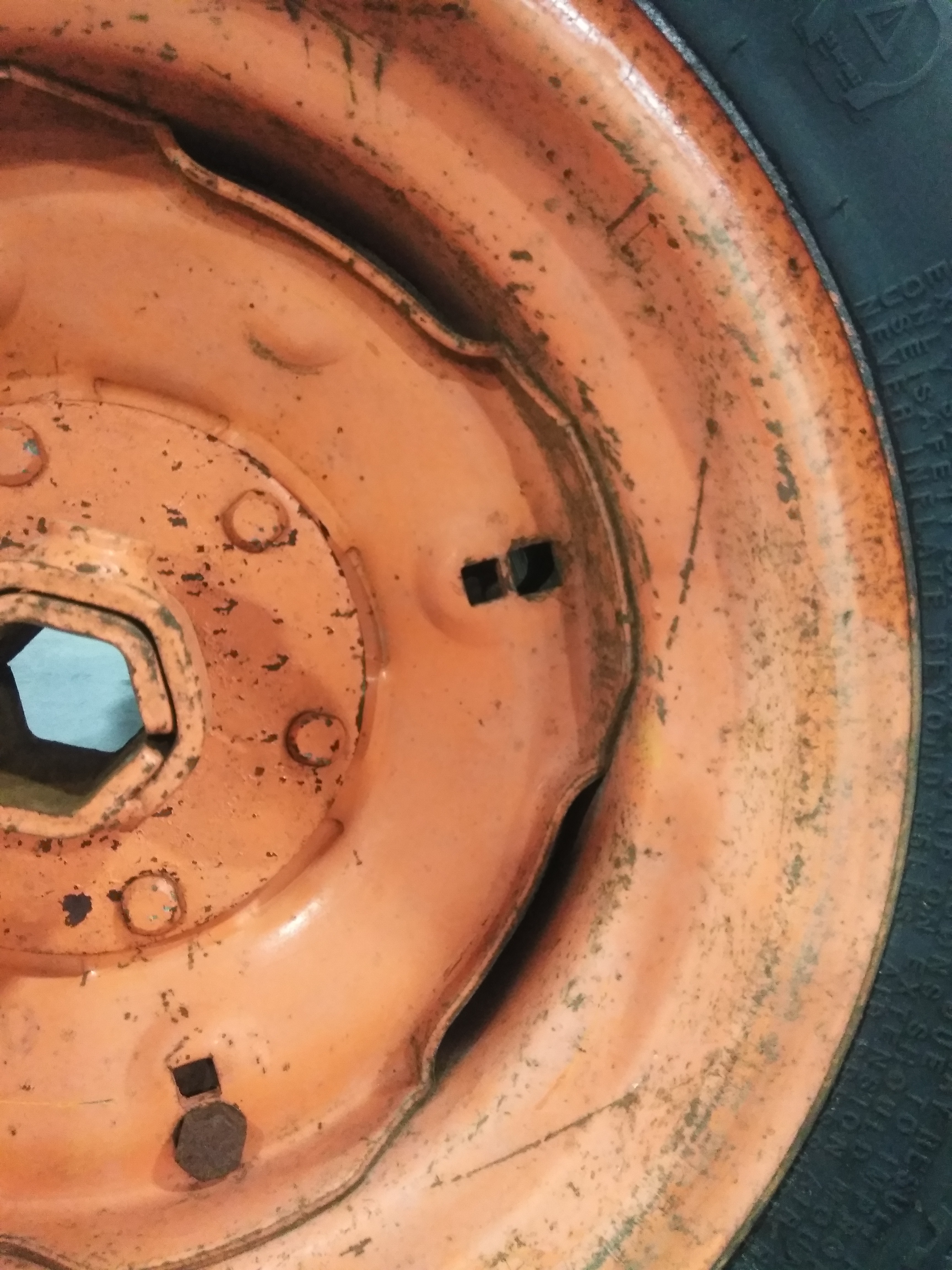

Not too hijack thread but seems like a good place for a question.
I removed my wheel weights, someone jury rigged them on there with wrong hardware, I tried using 5/8 carriage bolts but the heads to large, hits inside of rim, where can I get proper attaching bolts/hardware?
Ive tried dealer, no luck.
Tractor is a early 80s B6100E. Thanks
Also can someone tell me purpose of the large bolt with the spring in the center, maybe its to compress rim center so its tighter on axle? Still dont get why the spring? Lockwasher would have held tight
