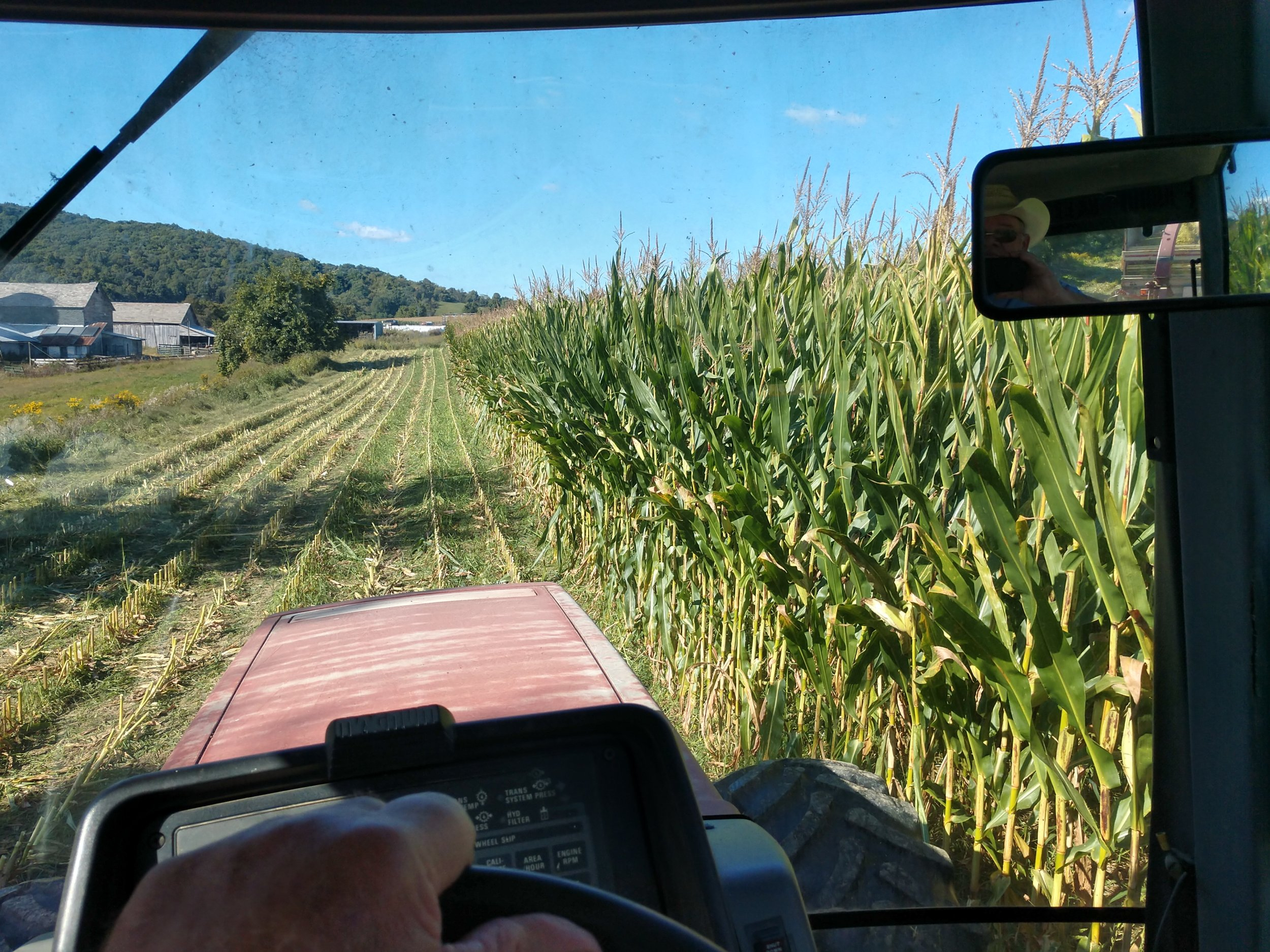

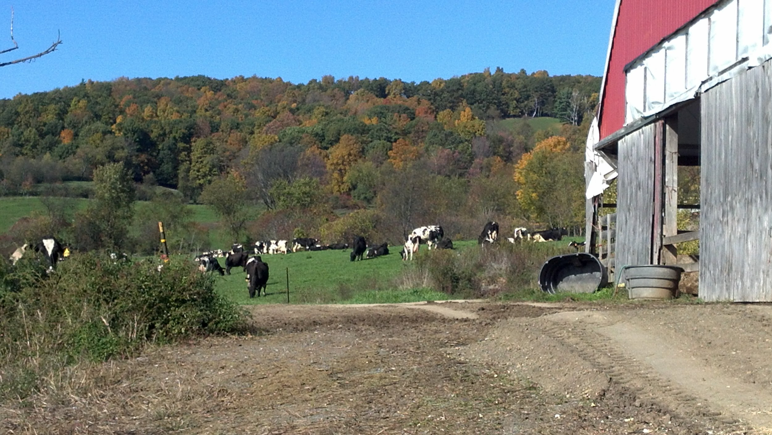

Most likely those of us who did real farming and used 2wd trctors had an implement in the ground or were pulling something heavy that did not roll well or had a 3-point implement on....
What's real farming????, I must not know what I do often????
Think that tractor stops without using the brakes?????
Care to work those fields without brakes.
As far as any REAL FARMING I think I can cover that.
