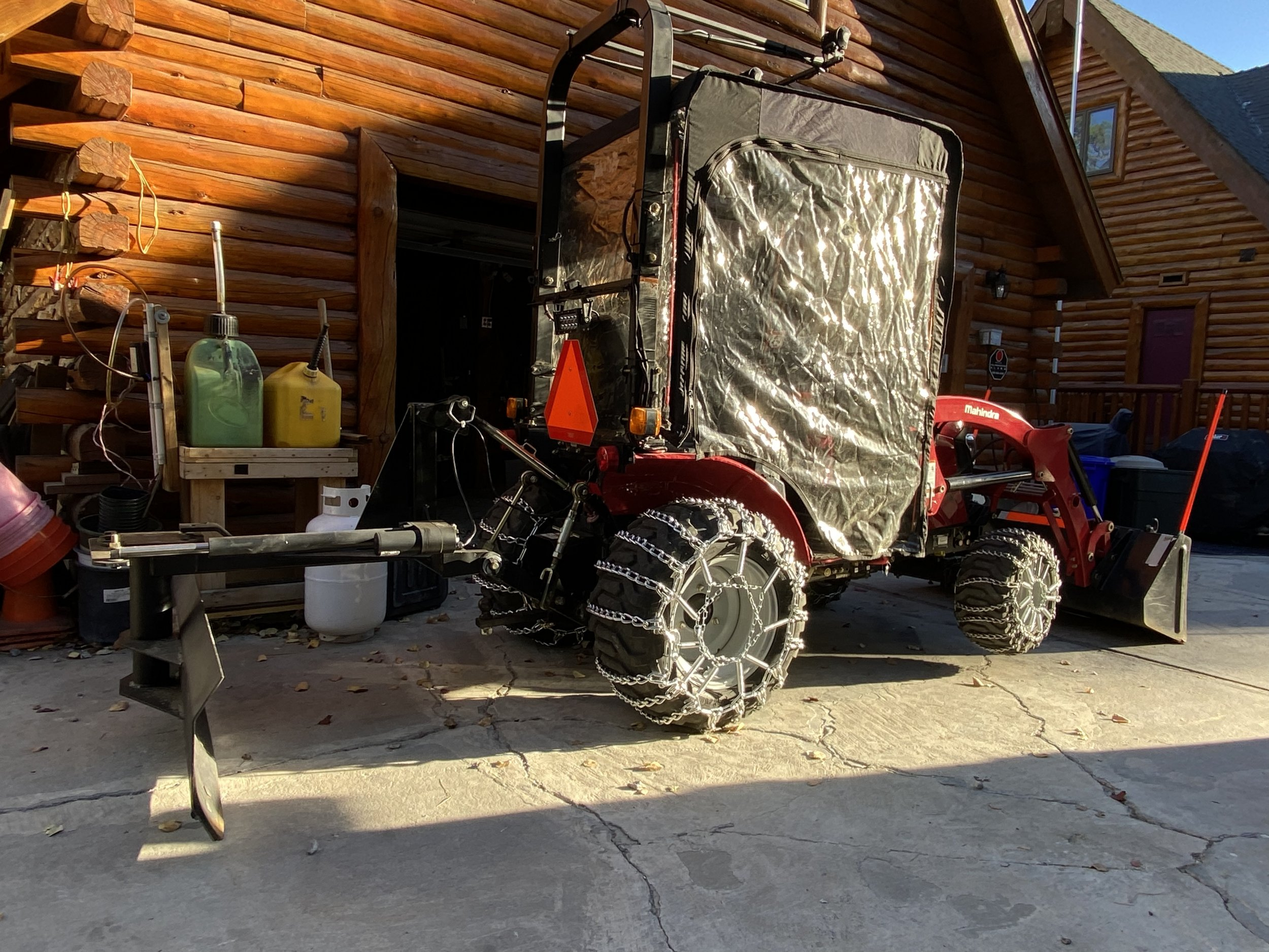

My tractor is a 4x4 Hahindra eMax 22. I primarily plow snow but with no weights and chained on all 4. I have a soft cab, rear facing camera, rear light bar, top front facing LED lamps, a rear scrapper blade that can be angled by the 2,000# linear actuator. We can get snows from 5 to 7 feet and huge icy berms both of which are no problem. 20 degree grades are common. I only use the break to stop at stop signs.
