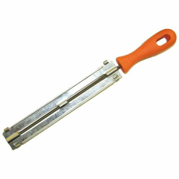

I have one very much like this. It works well. I do the same # of strokes on each tooth. And take the depth gauges down with a 4" hand grinder (there are no rakers on chain saws).
This is good for quick touch-ups in the field.

Stihl 2n1 filing guide is pretty good for beginners. I don't think you'll find better.

I will stay with my Pferd guide. Not the "best" but no set up, and no power needed. For a hack like me, good enough is good enough. No need to learn how to do it like the old timers when this simple tool does a decent job.
If I but 50 cords a year I might think differently.

Yep. They are a rebadged pferd sharpener and all I have used for years. Literally foolproof. Do rakers as you go. They do a rebadged one for husky as well.
I use to dread sharpening. The 2in1 changed my results tremendously. I won't use anything else.

Like Oaktree, we've used the style for years. Clamp on bar, no need to remove the chain. Inspect the chain before starting, find the worst link. Count the strokes it takes it sharpen it. Give all of the other teeth the same amount on both sides. Otherwise, it may cut crooked in a larger log. Used the depth gauge w/flat file for the raker's. After a while, experience will let you take so many strokes with a flat file, compared to how many you made with the round file. Mark the first tooth sharpened with a lumber crayon, or paint pen, so you know where to stop. Been using this style for 40+ years around here.
