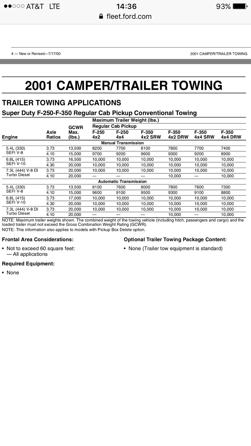

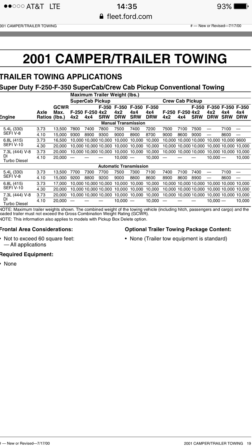

Just because the receiver is rated for 12K. Your Suburban is not rated to pull that. It is probably rated to pull 8K or so, so be careful. I'm not saying it is not capable of towing it. But if you get in an accident even if it's not your fault and the insurance companies get involved watch out. My 2001 F-250 super duty even the F-350's and dually super per the Ford manual sets max bumper pull at 10K. IMG_1324.JPGIMG_1323.JPG

Just because the receiver is rated for 12K. Your Suburban is not rated to pull that. It is probably rated to pull 8K or so, so be careful. I'm not saying it is not capable of towing it. But if you get in an accident even if it's not your fault and the insurance companies get involved watch out. My 2001 F-250 super duty even the F-350's and dually super per the Ford manual sets max bumper pull at 10K. View attachment 518420View attachment 518421
