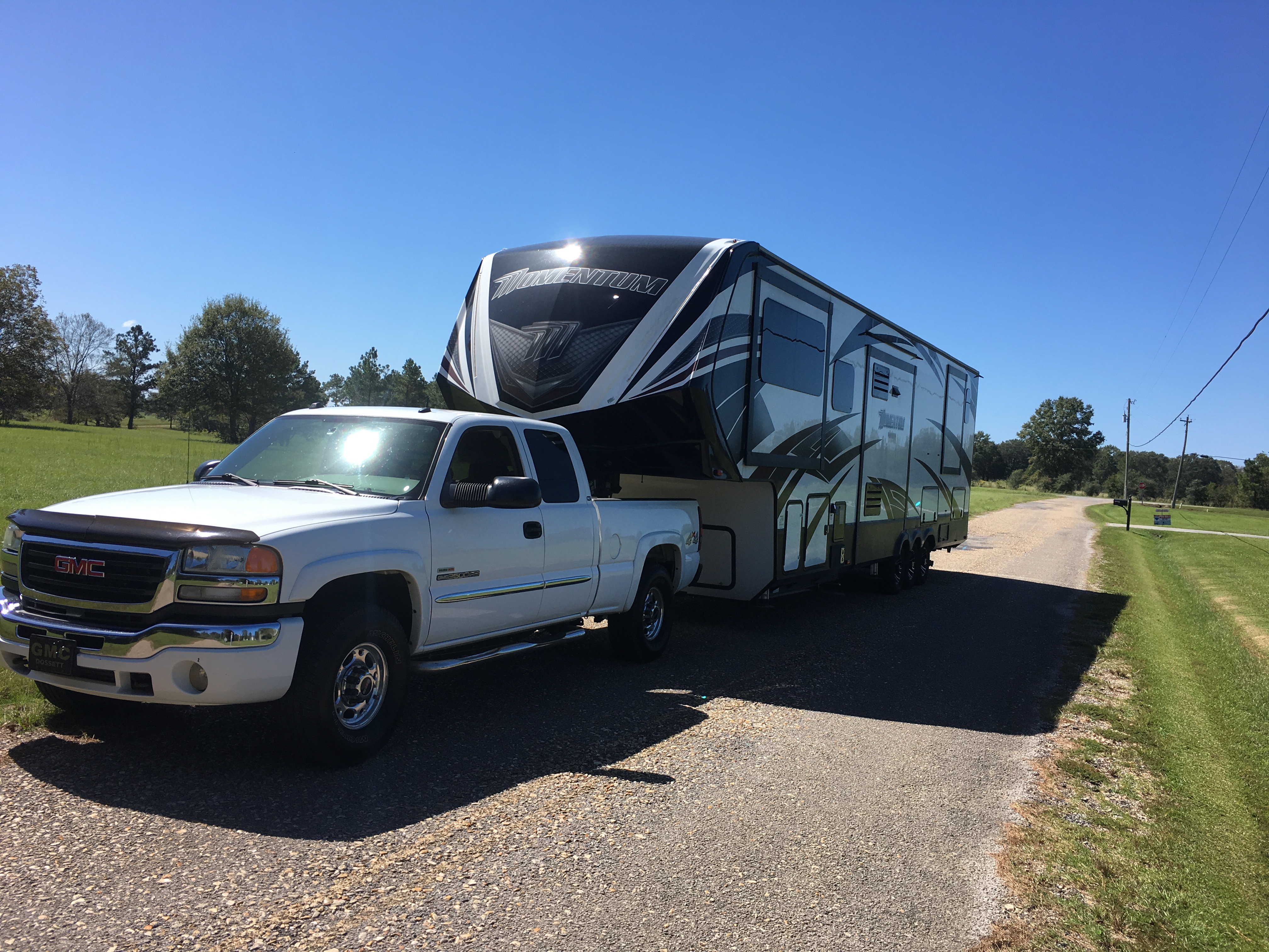

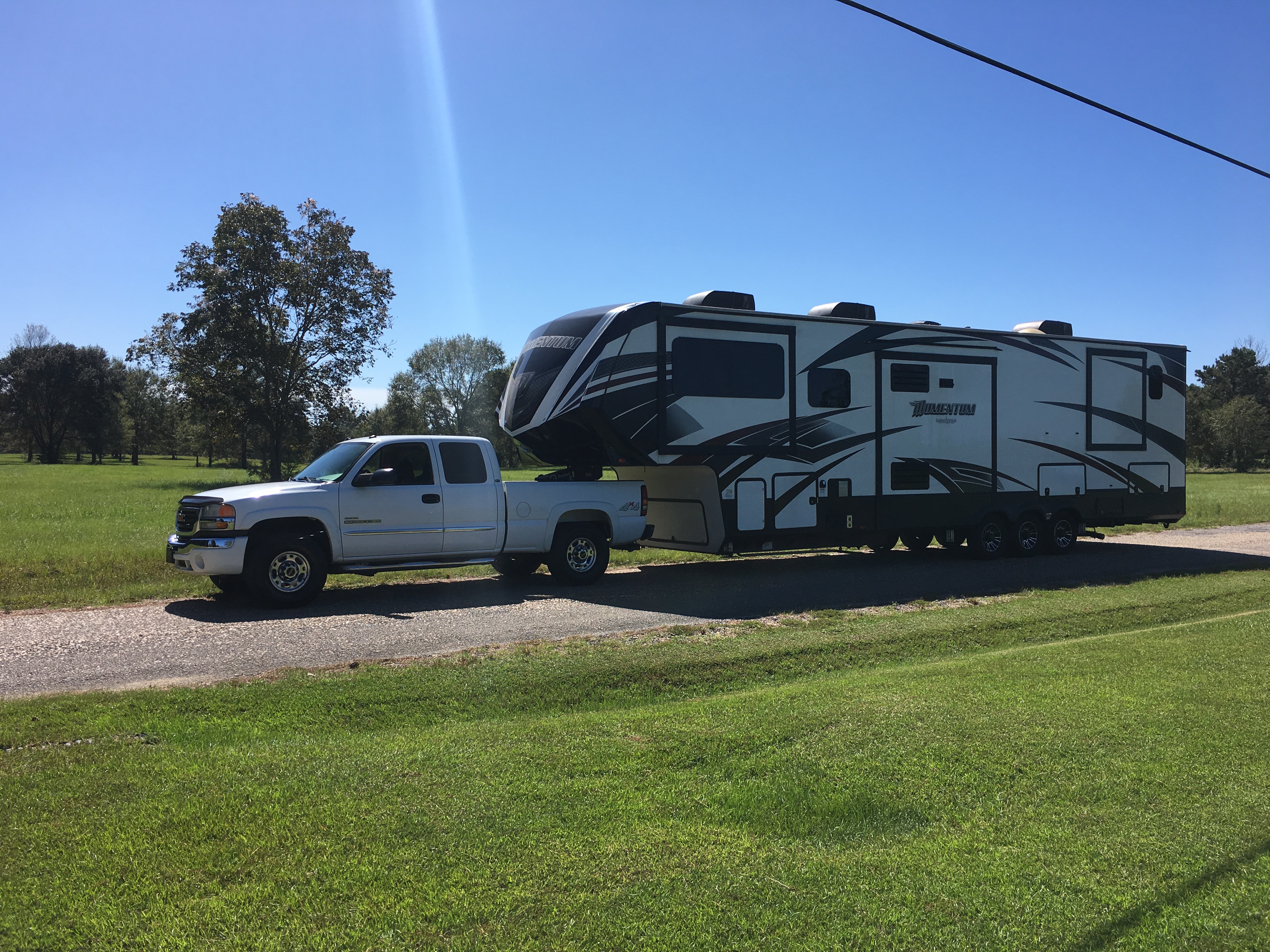

Another cheap and easy fix is adding Timbren rubber overload springs. I have ran them for years on my 2500HD and they are awesome with heavy loads and do not effect the ride when when empty. They are maintenance free too. The downside is the ride rough with light loads like 400 to 1000 pounds. Here is my truck with 3500# on the hitch and a 20K 5 slide toy hauler.
