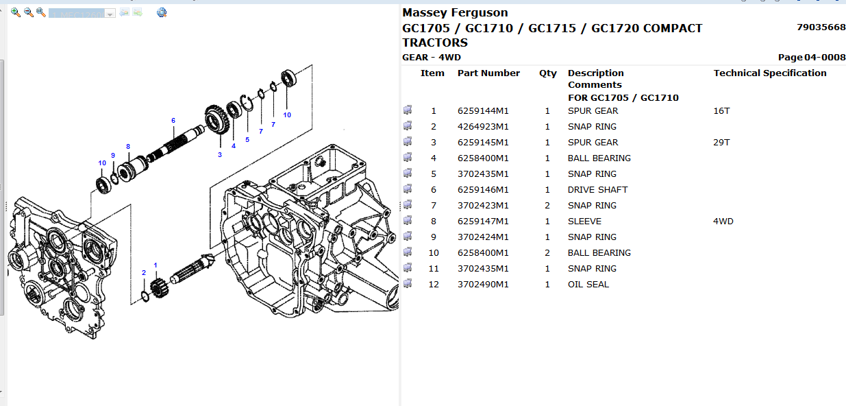

How about doing that again and trying to shift the tractor in and out of 4WD while making the tight turns? Our BX2660 has a good enough power steering that it is easy to turn in 2WD or 4WD, but it will bind and be hard to shift in or out of 4WD when turning. Looking at the parts diagram online:
566732d1534265581-when-use-four-wheel-drive-gc4wd-png
It look like you just have a sleeve (#8) to engage/disengage 4WD, so (other than the power steering and perhaps a better match between front and rear tire sizes), its not any more advanced than a 1960s era 4WD tractor.

Good stuff Aaron. Looks like a simple gear engagement system. Will most certainly bind and scuff somewhere in the combinations of tight turns and/or driving straight.
Maybe it's like that one scene in the movie "Cool Hand Luke".
What we have here is a failure to communicate. :)

Greetings aczlan,
It's illogical to try to make equipment fail just to support a faulty or incorrect opinion.
1. Why would anyone need to change in and out of 4wd multiple times in the middle of making a tight turn? It's just not something an operator does. It's not logical to try to conduct an action hoping it will fail and then claiming vindication. Either it does it as was specifically prescribed or it doesn't. The concept of testing what is not normal operational behavior is for design engineers when a problem exists . . . No problem existed before or during the testing for me.
2. How "advanced" the Massey 4wd system is was never the issue one way or another - never stated or discussed. The fact is, it doesn't create the issues and problems that overszd stated would certainly happen to all FDA units. However a far more logical conclusion exists. . and that is that possibly many units may not have the issues Overszd stated they had. His total level of experience with scuts turns out to be only 2 units, and those are not even remotely current units. So a far more logical approach than attempting many odd strange or illogical variations to try to find one variation that would fail. . . . Is to get owners of other scuts that are 6 years old or newer to report if they experience a problem when doing overszd's same test.
My original statements ended up being tested and matched my original statements exactly and completely contradicted the outcome "that was certain to happen" . . That didn't happen.
So either 1 or all 4 models of the gc1700 series are clear or maybe even the gc2300, gc2400, and gc2600s are also clear. Proper testing requires knowing about all the newer BX models and the newer JD scuts and etc. etc. etc. .
I don't believe 1960s designs apply here either as SCUT were never even initially produced until the first BX product in 1999. Comparing apples and oranges only gives you Fruit Loops. Lol.
