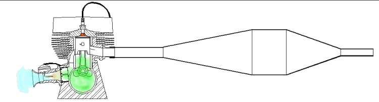

Guys on AS often go for very high compression ratios. That can be counter productive in that it adds a lot of heat to the engine. If you look at two stroke racing motorcycles they run lower compression ratios than many saws but make 4x the power per cc. They do that with better port design.
What will improve power will be closing down the squish clearance. Stock engines often have more squish clearance than needed because of the production tolerances of cylinders, pistons and rods. Any clearance beyond what's needed to keep the piston from hitting the cylinder is wasted volume- the mixture in there does not burn with the rest of the mixture in the combustion chamber. It burns later and less efficiently. Redcing that makes more power.
Most saws have the head and cylinder as one piece which makes it harder to set the squish clearance without raising the compression ratio (by maching the combustion chamber). On motorcycles, jet skis etc it's commonly done.
   / Where’s the best place or way to increase performance with a chainsaw. #30
Re: Where痴 the best place or way to increase performance with a chainsaw.
Be a man! Put an expansion chamber on it! :laughing:
