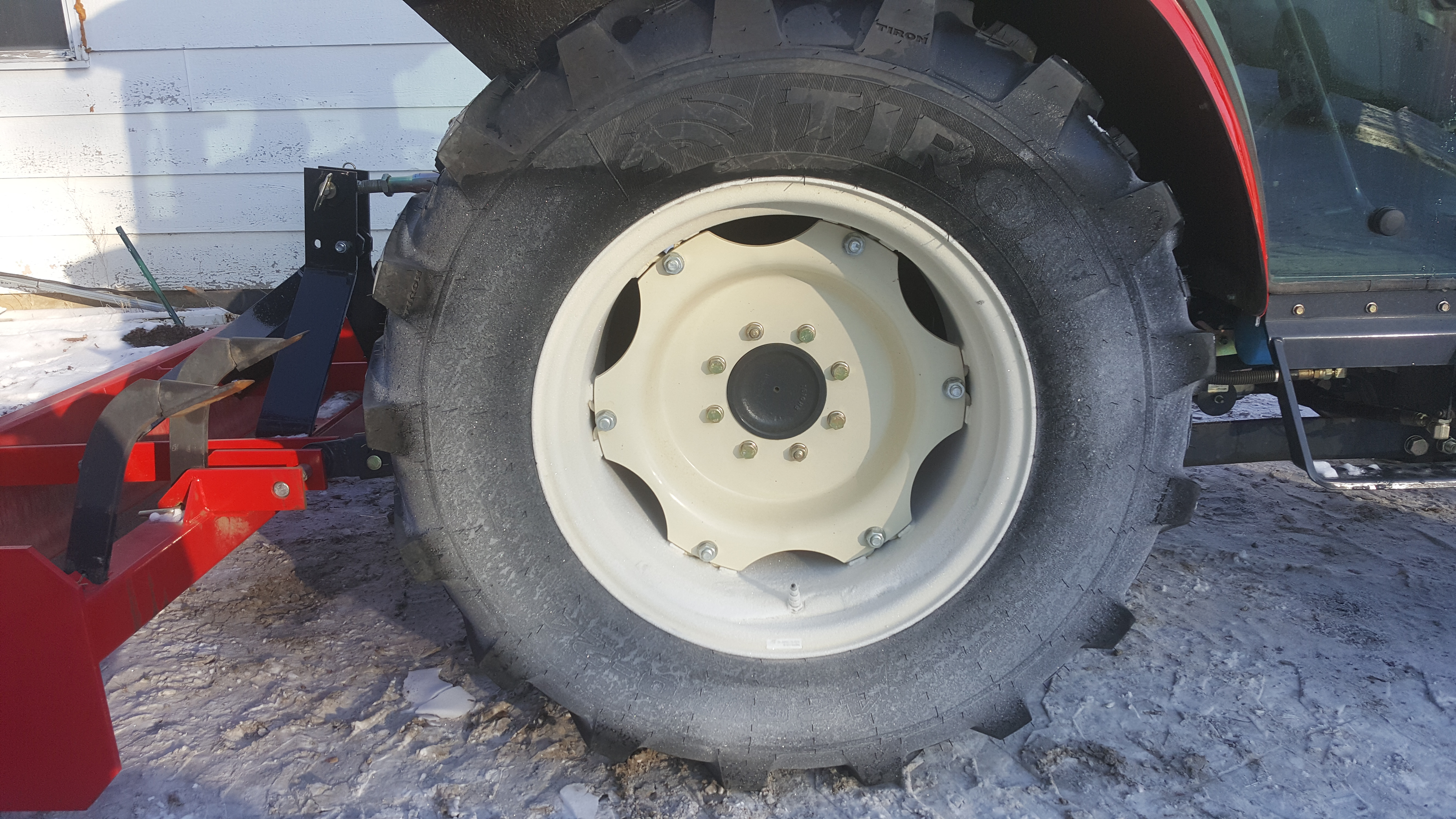

Sounds like they had the 25 series sitting there with the wheel spacing set to the narrow position. Mine is right at 70-72" from outside sidewall to outside sidewall.
This pic should show you the rim offset position that mine is set on:
Notice how the center "dish" area of the wheel is concave. There are 4 rear wheel spacing positions. Mine is the next to widest position. My front tires are on the wide (only 2 positions on front tires) position. The rear outer rim can still be flipped and set out farther than it currently is. But at least on the 25 series, that would make the rear tires track wider than the front tires can go. As mine sits now, with the fronts on the wide position, and the rears in this position, both front and rear tires have the same tire track width.

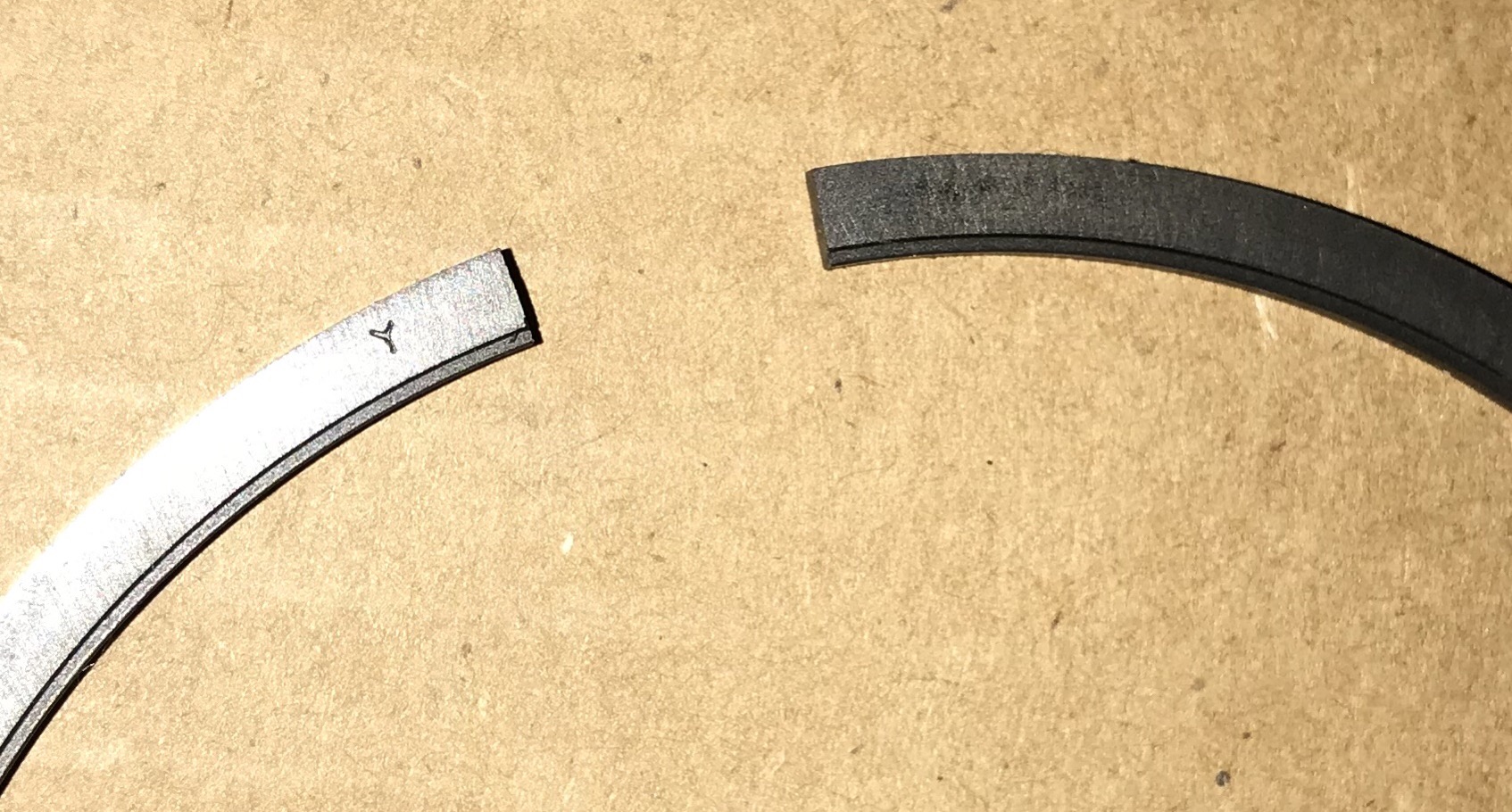

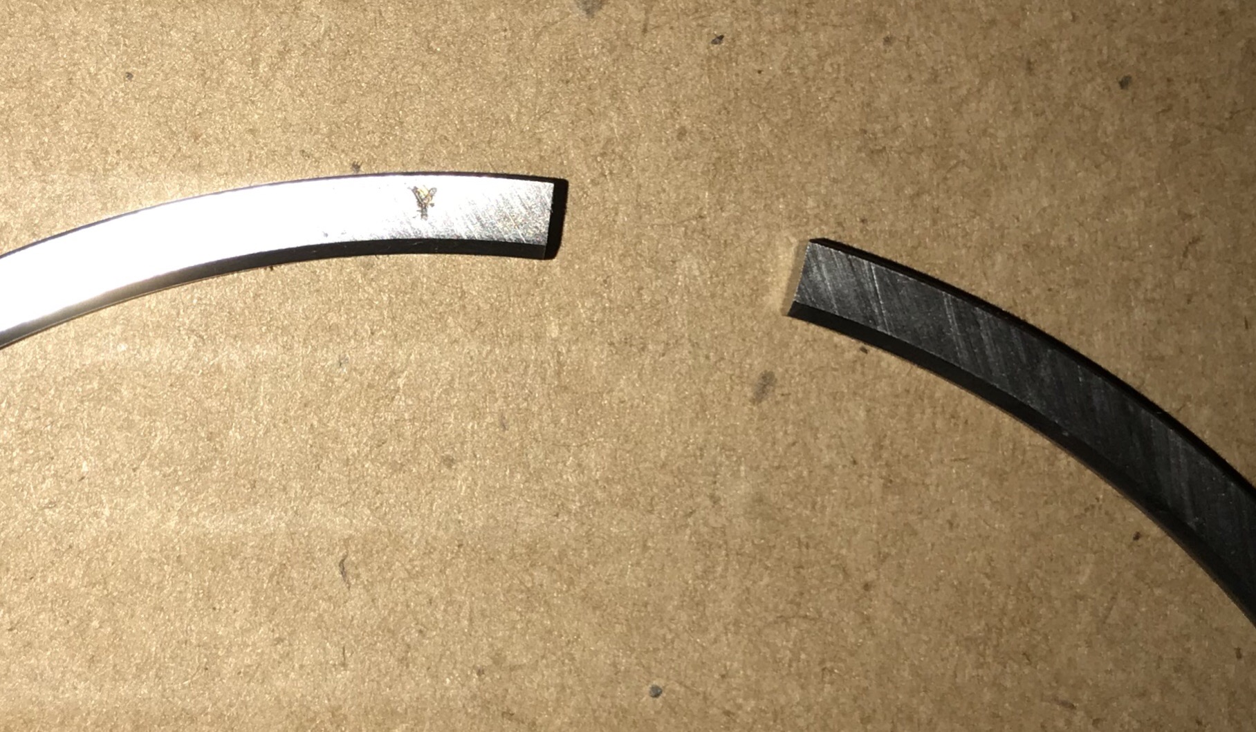

Hey group need some help with identifying which ring is my top.
I finally got my new rings but I’m having a hard time identifying which is which.
They have a “Y” stamped on the so I’m assume that is going be UP.
I have a shinny ring and with “Y” up so is the bevel.
The other is darker and with “Y” up the groove would be up.
Can I assume shinny ring is top and dark is the bottom. Because the other way around the bevel would pointing towards the top
Ring and I do not think the is right. Just about everything I have read has the bevels pointing in opposite directions
   / Where are buying your Branson parts? #30
Lhhippie
I would say you are correct. The Y must go toward the top of the piston. Shinny would be top ring.
