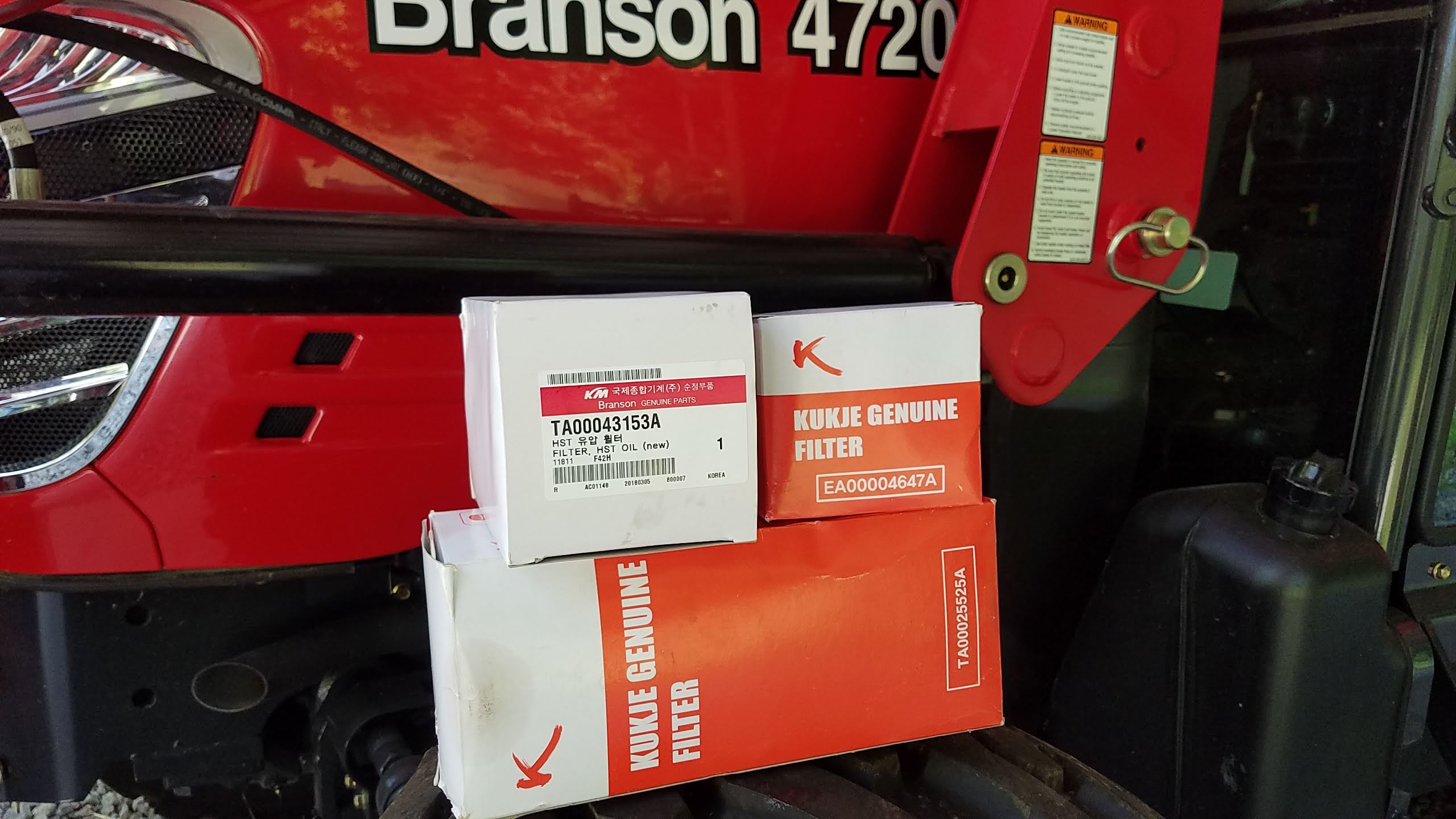

I picked up some filters today at Southern Indiana Equipment. They keep regular maintenance items in house, and the staff is very helpful.
The EA00004647A is the new oil filter that replaced the KUKJE EA00001160B (Original). The 60B is no longer made, just a FYI.
The other 2 filters are for hydraulics and Hydro-stat.

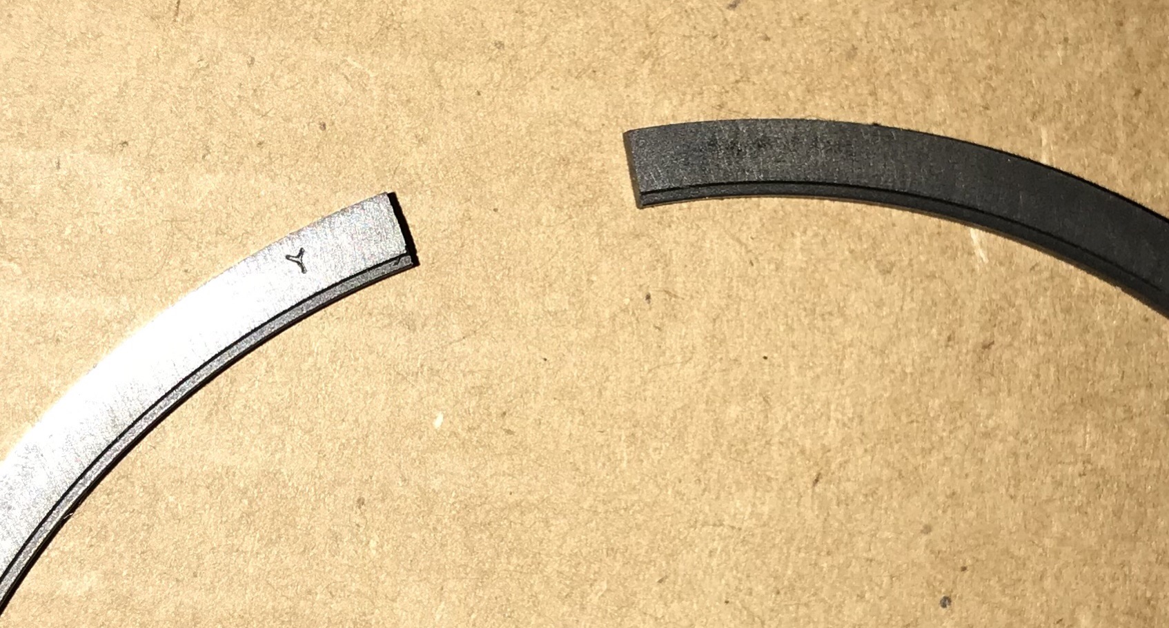

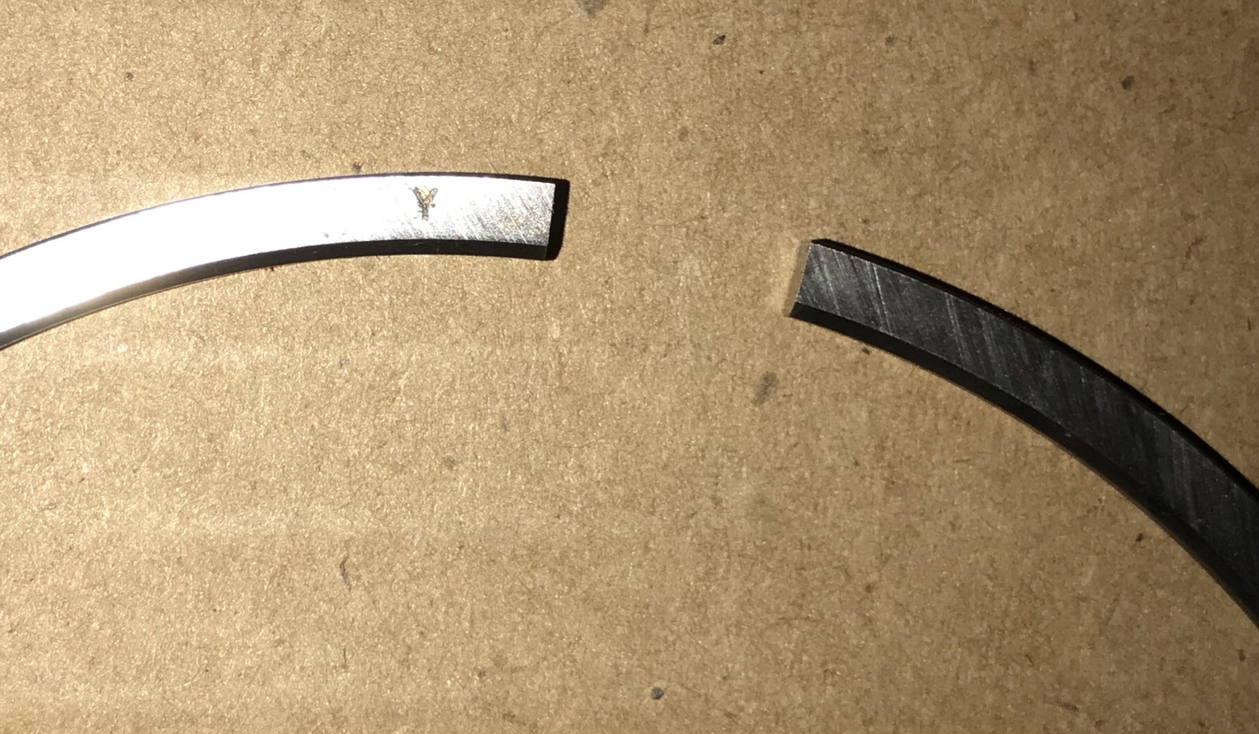

Hey group need some help with identifying which ring is my top.
I finally got my new rings but I知 having a hard time identifying which is which.
They have a 添 stamped on the so I知 assume that is going be UP.
I have a shinny ring and with 添 up so is the bevel.
The other is darker and with 添 up the groove would be up.
Can I assume shinny ring is top and dark is the bottom. Because the other way around the bevel would pointing towards the top
Ring and I do not think the is right. Just about everything I have read has the bevels pointing in opposite directions
View attachment 615742View attachment 615743
Just curious, how many hours on this engine? Please keep us posted on your progress. Good luck!

FYI I just received confirmation from Dave’s tractors service technician and he said the shinny ring is the top because of the bevel. He also noted that he has seen rings installed both ways. Both bevels pointing up and bevels opposite each other.
