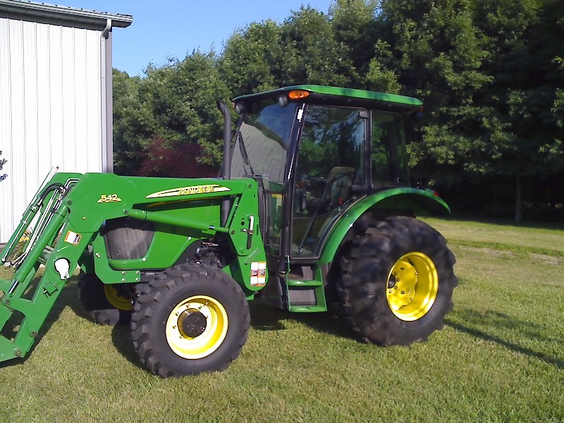

Well, tell me, do they look too small on the tractor? Please forgive the poor picture; all I had was my phone. They were the biggest R4's I could buy to fit on it and keep the correct sizes for 4X4. They are considerably shorter than the R1's, but they are wider and have much wider bars on the tires. The real good news is that I am able to mow with it now without tearing up the grass or turning it into a washboard.

DARGO: You were patient with your conversion; and got it right! I think it looks great on that "CLASSY JD." Also, I think it is a good idea to have both sets of wheels when different conditions require it. Lower height has it's advantages for mowing too.

Looks good to me. But seriously, is vanity really an issue here when you can now mow without tearing up that beautiful lawn?

The tire/wheel combo looks fine to me. The main thing is that they get the job done for you the way you want it.
I would say with hindsite if someone were going to go this route with two sets of tires it would have been a lot easier (and cheaper) to have ordered the somewhat oddball size low-profile R4's on the new tractor. Then you could have searched around for the 16.9x30 R1's which are much more commonly available.
Good luck with the new tractor.
