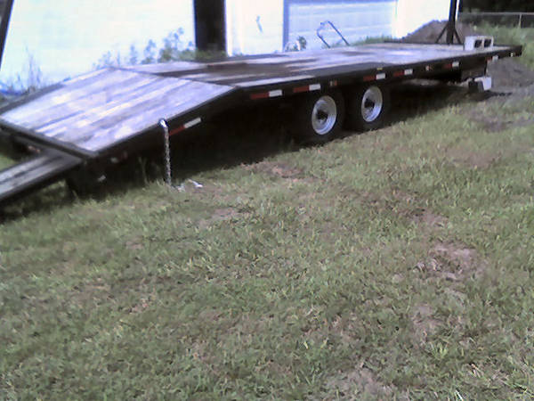

I just thught of something that you could do. Add a small beaver tail and some small ramps, which would lesson the load you have to pick up. Something like this. This was an 18 ft trailer and someone added a beaver tail and fold up ramps.
