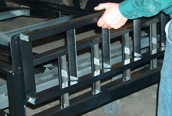

http://www.tractorbynet.com/forums/...4d1230857524-where-can-i-hang-my-ramps022.jpg
Thats how we usually made ramps for the 5 to 10 ton trailers, at my former employer.
Just with the difference that we preferrably used a stainless steel 1" stock, because it is hard to keep paint on it.
Also, we welded an extra support in the middle of the slide distance, inbetween both sidebeams of the ramps. This way the slide travel of each ramp, was just a little under the width of the ramp itself. That was more than enough for most applications, and made the construction at least twice as strong.

I have been working on a "new to me" trailer for the last month and I'm just about finished up after getting some angle iron welding on the back to keep the ramps from sliding off.
I'm down to trying to find an easy access place to mount the ramps.
I'd rather not bend all the way down and have to drag the ramps out of racks welded under the deck and I don't want to have to throw them into the back of the truck.
If you guys have come u with a good way to attach ramps to your trailers please post a picture or two.
