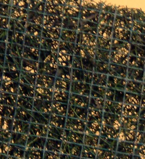

Item #2 - is there some sort of cover/netting for the grill? Last summer, I was mowing fallow fields where mare's tails had gone to seed. I had a terrible time with the small seeds going right through the grill and clogging the air filter. I overheated the tractor once. After that I had to stop multiple times to clean it out. There has to be a better option, right?

Window screen works good, get the soft nylon, cheap stuff. Cut it a little larger then you want and roll the edges up some and staple them, this will give the edge a little bit of stiffness. How you hold it on the tractor is another matter, maybe zip ties.
I use a frameless high flow furnace filter, and set it right in front of the radiator. Washable, stands up to compressed air cleaning/drying. Maybe even to a power washer, but I haven't actually tried that yet. Available at WalMart for ~4 bucks. Cuts with a scissors, enough in one package to cover both my tractor radiators.

Great Idea Greg. Thanks

Nylon screen works nice for keeping out debris. We used it for keeping out bees wings on our pickups during harvesting. Same issue, overheating.
