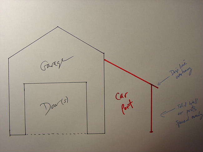

The least expensive option is to attach a car port onto the side or back of your garage. It can be done to match the appearance of the garage so as to look like it was original and pleasing.
You can match the roof line or lessen the pitch somewhat. I have seen it done both ways, and it has looked quite nice. It doesn't necessarily require a back wall and/or a front door. Very few have a front door and many keep the back open for easy access to the multiple items stored inside. You can extend the drip line far enough out so as to use only spaced posts as the outside support wall. [see attached image]
You can find MANY of these attached to barns throughout NH. And, most have farm equipment tucked inside to keep them out of the weather - especially sun and snow. I have seen some used as horse stalls where the horse cannot exit the front [it's gated], but it has the freedom to access its pasture through the open back.
Based on your garage description, this addition won't store everything, but it will certainly reduce the burden by quite a bit.
