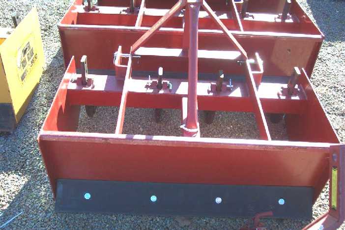

I picked up the United/Leibach box blade, 48" for around $350 (plus or minus, it was bundled with the tractor deal).
Here's a pic of it on the dealer lot. You can see in the background they make a 5' also. Make sure you are looking at the "HD" model. The 48" weighs arounds 325 pounds.
