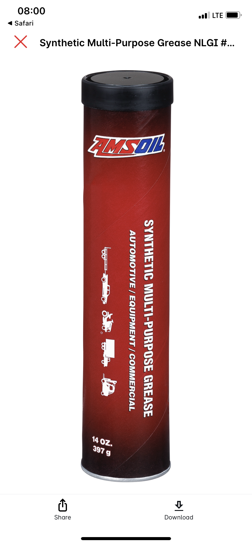

went on the Amsoil website and there are a bunch of different Greases to choose from- For a Tractor which one? I was thinking of the :
AMSOIL 100% Synthetic Multi-Purpose Grease
would this be the one to get??- thks

That’s the grease I use on my CK30HST, my JD lawn tractor, my Tacoma etc. Have for over 10 years and like it. This is the one…

I have used Amzoil grease and after about two hours of use I could hear the pins rattle, I switched to Mobil Delvac and don't have that problem, the best grease you can buy.
My front end loader and backhoe operate super quiet. This grease is a lithium based extreme pressure grease.

It depends on where its going? Amsoil makes greases for different applications depending on where it is being used. If you need it for bearings, then yes, then I would recommend the GPTR2 (Polymeric Truck, Chassis & Equipment Grease #2). If you need to use it for the bucket pins then use the GPOR2 (Polymeric Off-Road Equipment Grease). These greases have moly in them and work great. The multi-purpose grease you are looking at is what I would use for car bearings and other "basic" applications.

Njoiler is correct, Amsoil makes different grease for different purposes. I don't remember exactly which one my dealer recommended for loader pins but it seems to stick to the pins better and withstand pressure better than what I had been using in the past. I always say some grease is better than no grease but it actually helps to make sure you are using the correct grease for the specific purpose.
