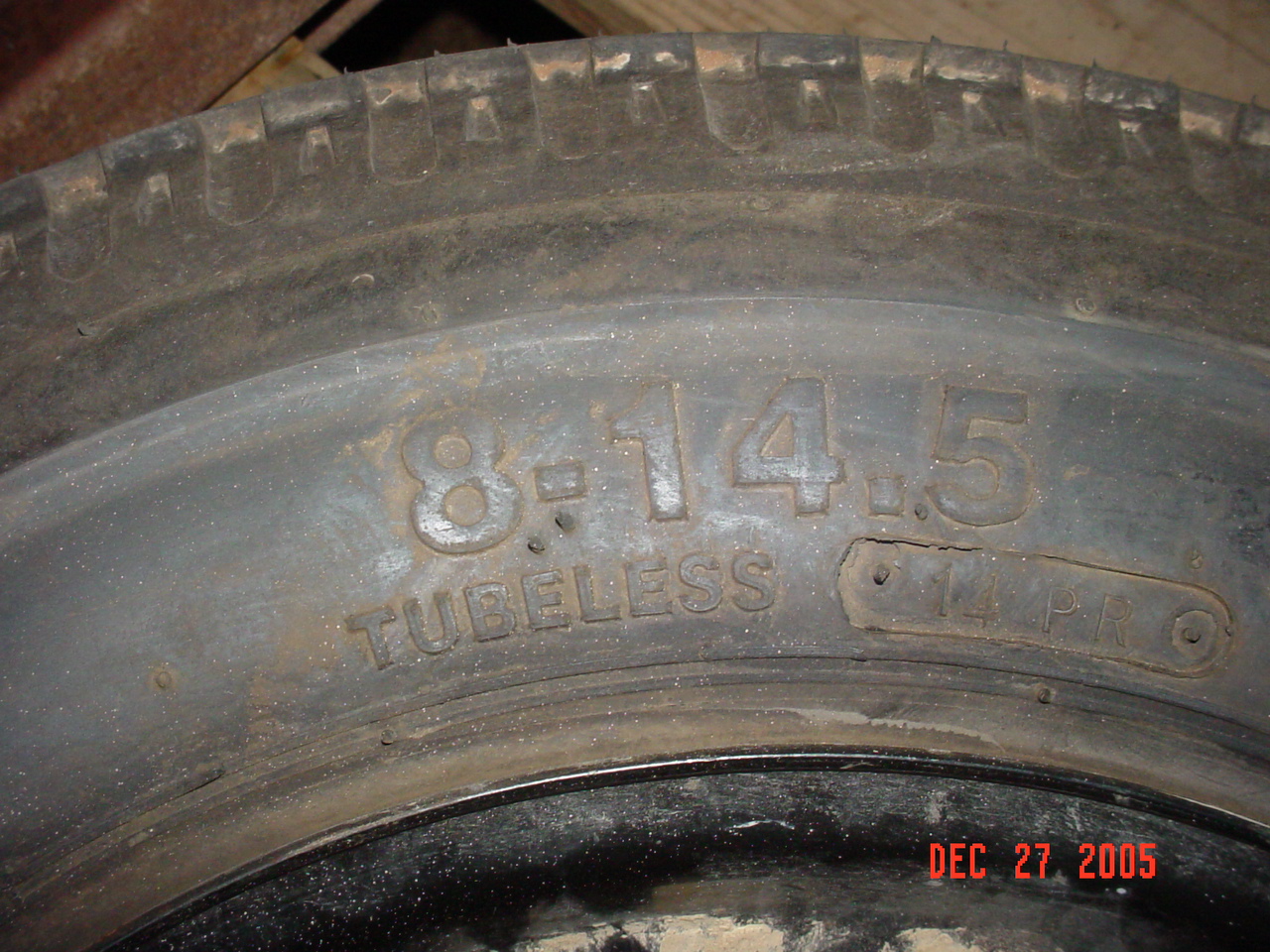

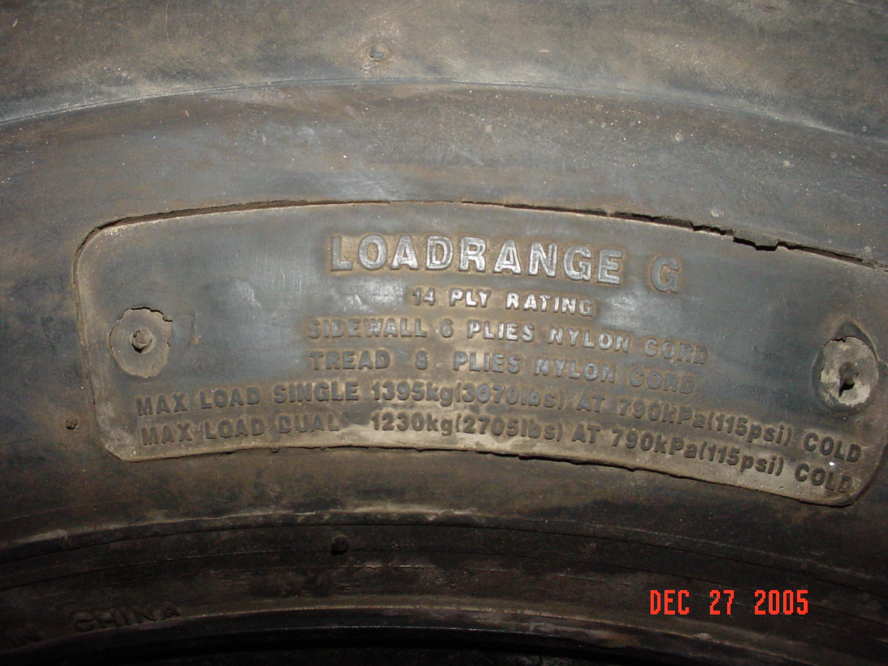

yes UTG but i could have sworn i have seen them refered to as UMH either way they are still demountable hubs UTG is still the hub with 5 bolts and rim clamps. i find what Dexter states in that link as funny. it sounds as to a way to cover their asses. in the following link you will see where you can get service parts for the UMH or UTG "demountable" hubs and notice that they call for the same bearings and brake parts for 5500#-7000# they say that they arent servicable but yet they have parts listed. they say the backing plates are welded on yet the illustrated parts breakdown shows it using the same 5 bolt backing plate. with the bearings being the same part numbers and the brake asseblies being the same it seems to me that the axle beam itself is the same including the spindles and the hubs are interchangable from the UTG/UMH demountable type to the standard 8 lug brake hub or the 8 lug idler hub. all of mine are the "servicible" type and i use the 14.5 wheels and they are DOT stamped
Im not saying that all mobile home axles are the "servicable" type but alot are. i would say that if they have a bolted on backing plate instead of a welded on one then they are meant for more than "one trip" and they are field servicable.
attached are some pics of the wheels and tires that i have in use. I will get some of the axles after the holidays.
Maybe the ones i get are actual UTG but i know they come out from under mobile homes ???????????
Podagrower: What is the differeance between UTG and "mobile home" axles??
