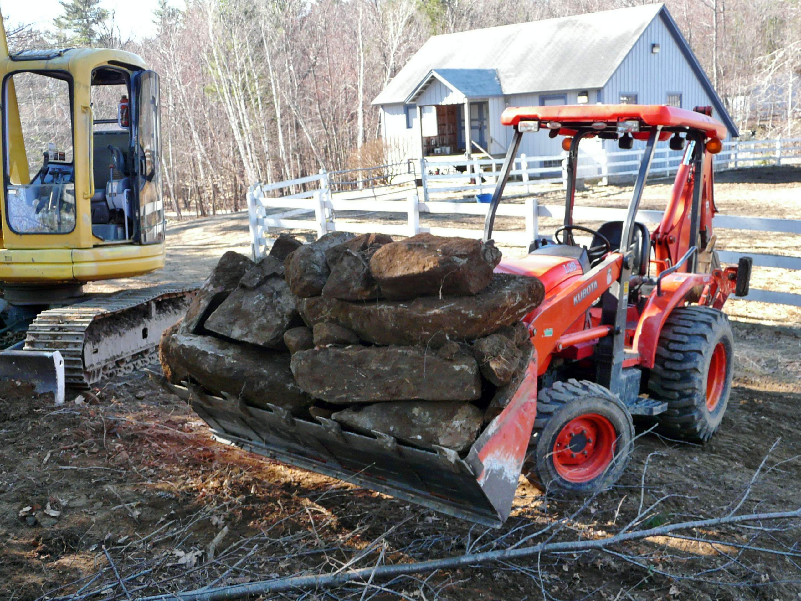

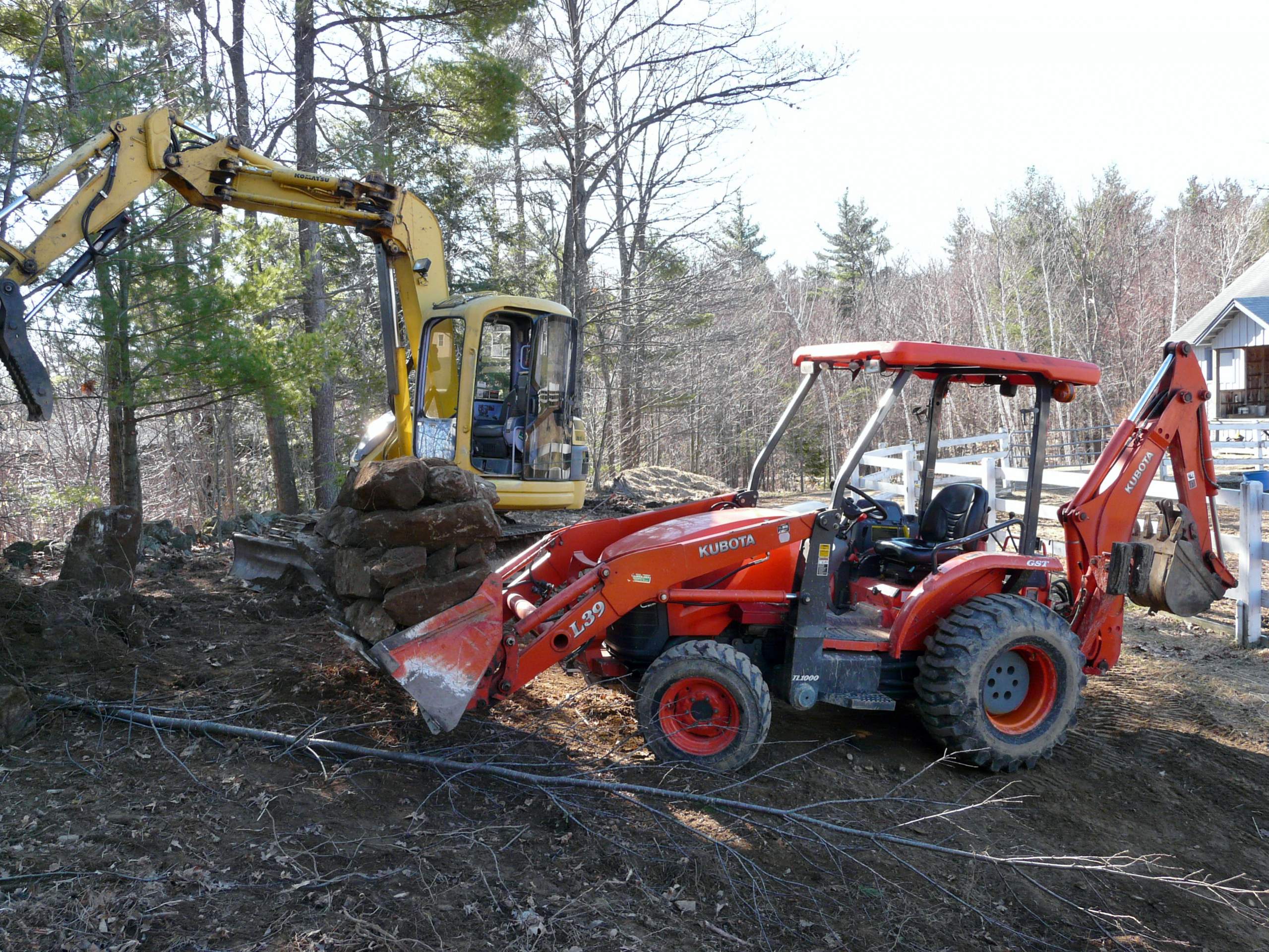

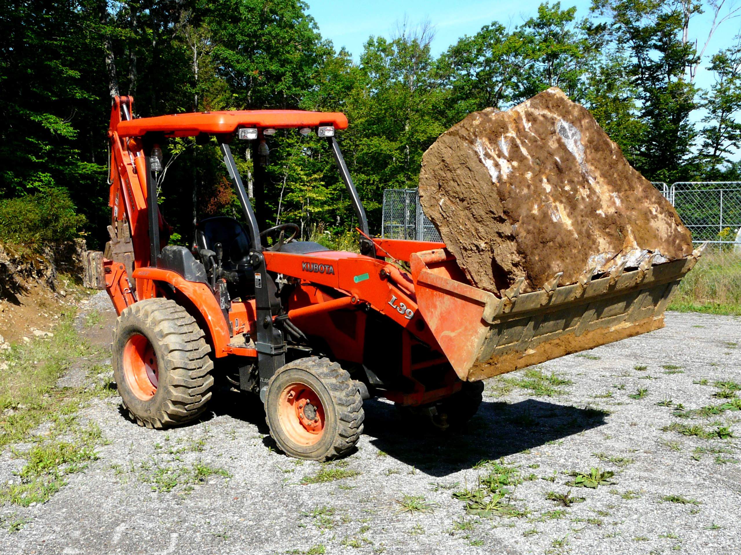

   / Which Bucket to buy for LA805 loader #19
   / Which Bucket to buy for LA805 loader #20
Yes I was, thank you.
An I thought I was nuts, those are some heavy loads!
And look to me bore than 1/2 yard capacity if you fill it like that :thumbsup:
