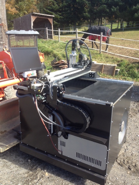

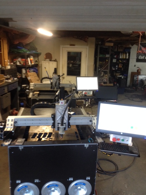

Jim,
Do you have any details on the custom 2x2 machines you are building? Gantry, motors, software, etc?
   / which cnc plasma #25
The machines I built for the trade shows are for demonstrating Hypertherm's products.....Air Plasma, CNC, CAM Nesting software. For most that are looking at low cost machines....these would not be the perfect fit, however they are great for being able to see and understand all of the mechanics, electronics and software involved in a CNC plasma machine...and that is what they will be used for. I am attaching a couple of pics, I'll have more after the shows in November.
The gantry was customized for my needs by Ron at Precision Plasma LLC . I needed a special 2 x 2 machine strictly for low volume trade show use that looks cool.
The motors and drive electronics are very high end Kollmorgen AC Brushless servos with a Ethernet like (new technology that I cannot yet discuss) interface between the CNC and each drive amplifier. These motors normally would not be found on an entry level machine as 4 of them with cables and electronics were about $8k.
The CNC control is a Hypertherm cnc as used on high end industrial machines. It is designed specifically for 3 shift a day high volume manufacturing.....very little time is spentpushing buttons, a lot of time devoted to cutting. Most low cost cnc's are designed to design draw and cut at the control...this one is designed to cut. It uses Hypertherm's Phoenix machine control software.
The CAM is Hypertherm's ProNest 2015. Again designed to improve productivity in very busy cutting operations.
First pic is being built in my home shop....second machine in background. Second pic is loading in my truck using Kubota!
