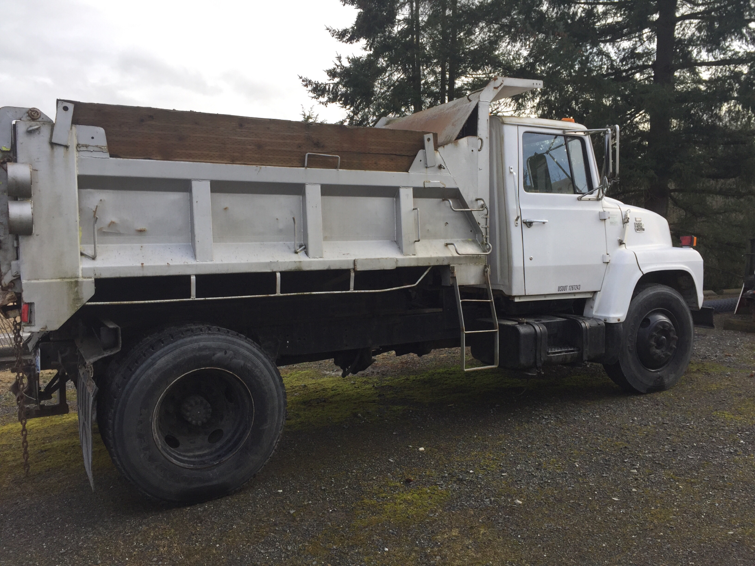

I have an 85 Ford LN700 dump running 28k GVW. Use it under an Agricultural exemption so no CDL required (with many limitations)-very useful for road work etc.
/ Which dump truck #11
Now that is a dump truck..
Thanks-gotta love an old Louisville Ford w/8.2 DD at a whoppin’ 190ish Hp !! Not winning any speed or acceleration titles!! I may only go 5-10 mph up some grades, loaded but I get there eventually
