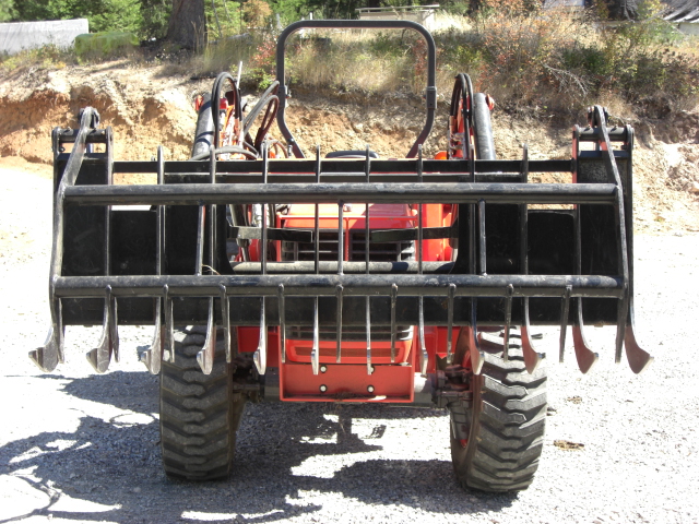

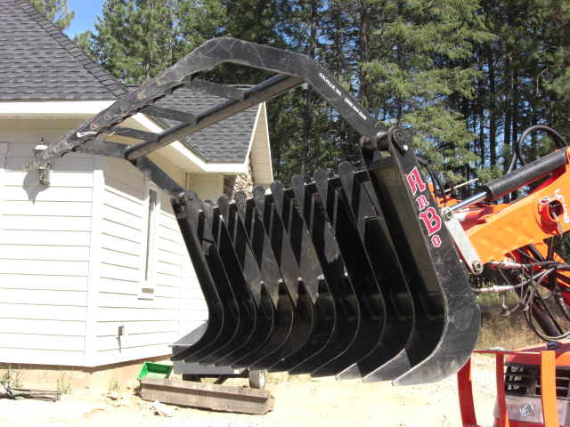

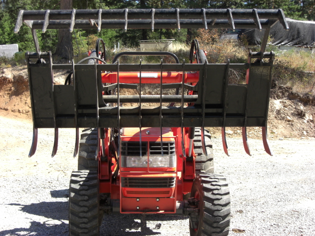

I have the Anbo grapple. It worked great at first. I would grab a pile of debris and would notice the tines would bend, but then they would spring back to the original position. After a few months, tines started bending and would not spring back and would keep the unit from closing. Being under warrantly, I called Anbo and they were pretty obnoxious about it. At first they told me my tractor was too big for the grapple (a JD 4720, funny when I called originally to get info on the unit they said it might be too big for the tractor). Then they basically said they weren't going to cover it period. I got my dealer involved who techinically bought the grapple from them. Long story short, the dealer heated and bent the tines back and put in steel reinforcements. I had to pay about half the cost (a couple hundred bucks) and either Anbo or the dealer ate the rest. Anbo specifically said that they denied any liability whether they paid any of it or not. After heating the tines they, of couse, lost their temper and most of them are bent again. Unless you are doing really light work, I'd look at another brand that has stronger tines.
From looking at Hammy's pix, it looks like a 2 X 3/8" flat bar across those tines near the tip would solve the bending problem. I'd cut a notch on the back side so it would be flush to the back edge. Any kind of side load will bend that much tine hanging that far in the wind. I had to add a gusset to the tip of my grapple's claw for the same reason, but the tines on the Millonzi are braced pretty well.

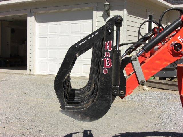

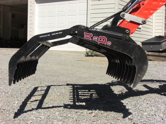

Redrocker,
I have had no issues whatsoever with the AnBo grapple. There are different models. I'm not sure which one Pokeboate had but I'm guessing it was their light duty model.
I think I would be hard pressed to destroy this one. The way they constructed it is excellent.

Hammy said:
Redrocker,
I'm not so sure. The issue with these wide top grapples is that you can crush an asymmetric load in such a way that it would torque the top piece. Imagine having a boulder on the left side of the grapple with only air on the right side. The two hydraulic arms, mounted at the far left and right, would try to close the grapple and the left one would stop when it hit the rock but the right side would continue to try to close with 3000lbs of pressure. That would twist the upper grapple arm. I suspect that is what happened to Pokeboate's grapple which was likely the same model you have given his tractor size.

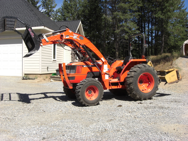

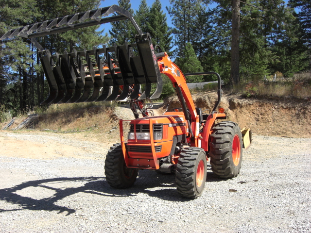

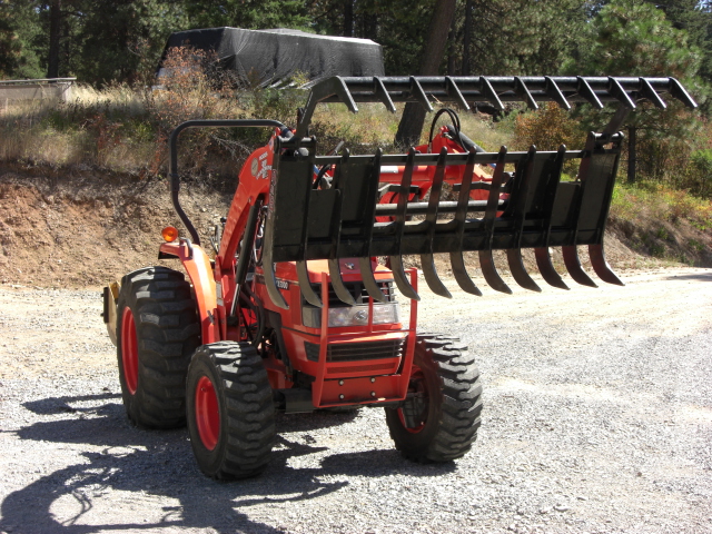

I understand that it seems logical that two arms would hold a log more securely than one. However, remember that you are not really holding the log with just the upper arms but rather by pressing the log into the bottom of the grapple. A one arm grapple therefore has essentially three points (top, left and right) and three points is pretty good for picking stuff up and holding it securely. Regardless of which style grapple you get you will always want to grasp a log or group of logs so that they are balanced left and right anyway. Otherwise your tractor will be unstable and you'll put undue stress on the FEL. If the load is balanced, you are really not needing that much force to hold the load in place. I have simply never had an issue getting adequate purchase on a log or tree.
As I don't find the lack of two arms a disadvantage, it is fair to point out the advantages of one arm. As I've noted before, it allows you to "surgically" grasp something right in front of you and automatically have the load balanced. If you grab something with one or the other of the two grapple arrangement you need to reposition if the load is heavy. One example is when you put the bottom tines under a bush that you want to pull out. With one upper jaw you leave the jaw open, stick the grapple under the bush by driving forwards with the lower tines pointed just a bit down and then curl to pop the bush out. Once it comes up you simply close the grapple and you drive away to the burn pile. See photos. With a two jaw grapple you'd do the same first steps but then you'd have to reposition the load, probably even working around to the side of the bush in order to get the root ball under one grapple arm and the body of the bush under the other. More complicated but if you don't do that then you've got an asymmetric load.
I suspect your loader is about the same capacity as my new loader. I've stuck the grapple under things that are heavy enough that I've lifted my rear wheels off the ground (4000lb tractor and 600lb mower). Did not bother the grapple at all. I don't think logs are really much of a challenge for grapples. Construction debris might be but brush and logs just don't seem to fare well when they challenge even 3/8inch steel. I haven't had any trouble lifting pretty big rocks or slabs of concrete either. The main thing that will damage a grapple is an asymmetric load or a sideways load. The point I keep raising is that I think having two upper arms makes it much more likely that you'd have an asymmetric load.
Regarding the grapples you listed: I've always liked the WRLong clamshell. It's cute and for brush alone would be the best choice. For using the grapple as a sawhorse to hold trees while you trim or cut them up it would also be nice as it closes more tightly than a traditional grapple. For lumpy things I think it would be fine but it looses it's advantage over a single arm traditional grapple. It is not as effective at being able to use the upper arm "surgically" because the upper arm is too wide to do that except by using one end which gets you back to the asymmetric load/torque issue again. I find that being able to come over the top of an object and use the upper arm to dig it out or just clamp down right in the middle is very useful so I'd miss that with the clamshell type. Wish I had one of each.
I don't know the Wildcat but based on the weight I'd say that it is too heavy or at least heavier than optimal for a CUT. If you are slamming the thing blindly into piles of construction debris with a big skidsteer or , worse you have an hourly employee who is doing that for you, then maybe such an overbuilt grapple makes sense. Lifting logs and tearing out brush or moving rocks just isn't that tough on a decent grapple so I wouldn't advise spending the extra money.
I've never seen the 60" Millonzi but I believe it has exactly the same construction as the 48" I have except for the two upper jaws. Enough written about that issue already.
I have over a year's experience and probably 70hrs work with my 48 on a smaller tractor and now about 5 hours or so with it on the DK40se. If I were to buy another right now I'd just get another 48" "light duty" from Millonzi. I just haven't seen anything that comes close in bang for the buck and I haven't ever felt there was some other grapple feature or type that would do the all around work I do any better. I'm not sure I'd even want to get it customized by beefing it up as that would make it heavier. Maybe, maybe using 1/2 inch but the weight penalty would probably deter me. I don't see the advantage of T1 steel though it is clearly stronger because it limits your ability to make repairs by heating and bending. Really, I'd just get another stock 48 LD and save the rest of the money for a new toy.
