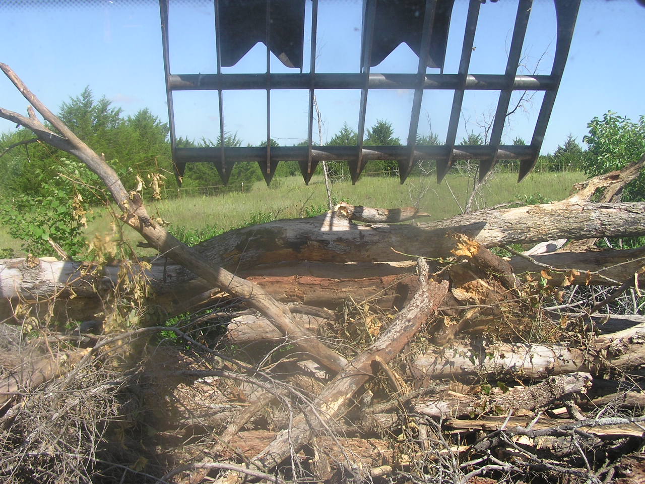

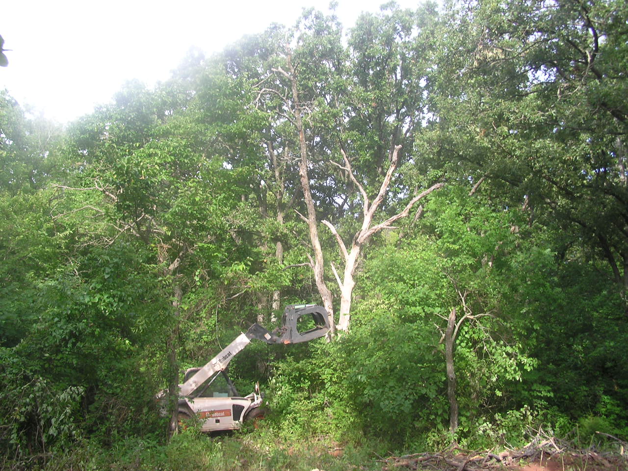

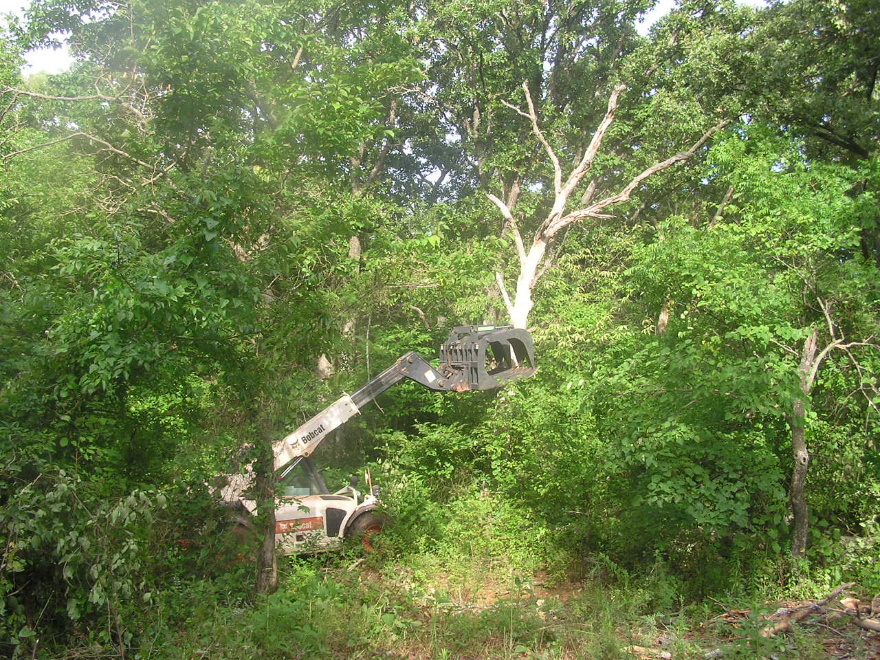

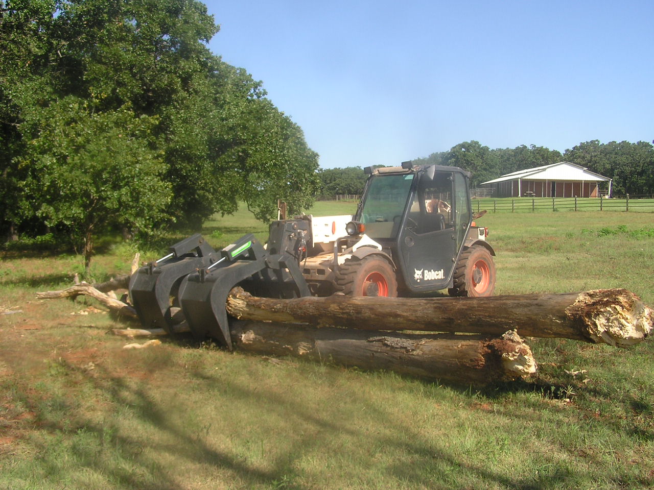

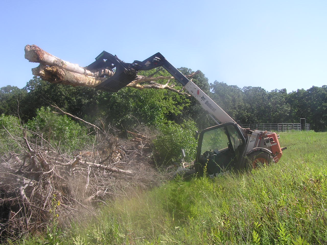

Actually my V417 is basically the same, just slightly smaller. For my uses, mostly dead trees, I have never wished for a wider grapple.
Pushed over two dead ones:

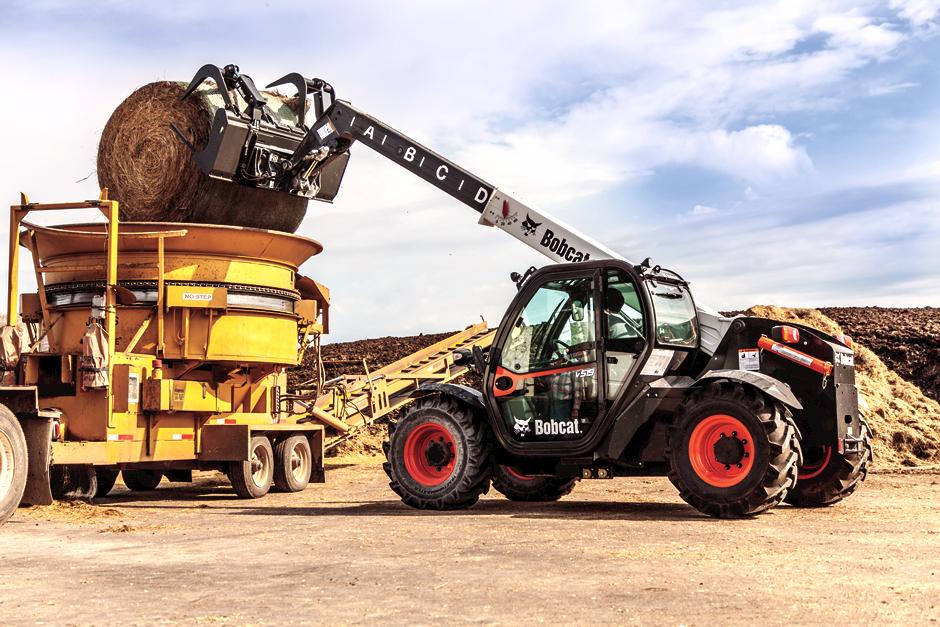

Armydoc,
Your putting this on a telehandler right? You would absolutely pretzel a 4' wide, 3/8" mild steel grapple. Do not let anyone talk you into going with a narrow lightweight grapple with this machine. Many Many Many people have been talked into this, and it's a fine option, but for your machine, you would be simply throwing money away for scrap steel if you went with the infamous $500 Millonzi 48" grapple.
(I understand that I.T. is not recommending this, but just want this to be clear in case it's a little misleading)
Piston is right. I wasn’t aware this was to be used on a big telehandler.
   / Which grapple? #86
It isn't a big telehandler, it is a small compact telehandler, the new Bobcat V519. 6.9 feet wide and 6.9 feet high about 15 feet long.
Only rated to lift 5500 pounds. :D

Armydoc,
