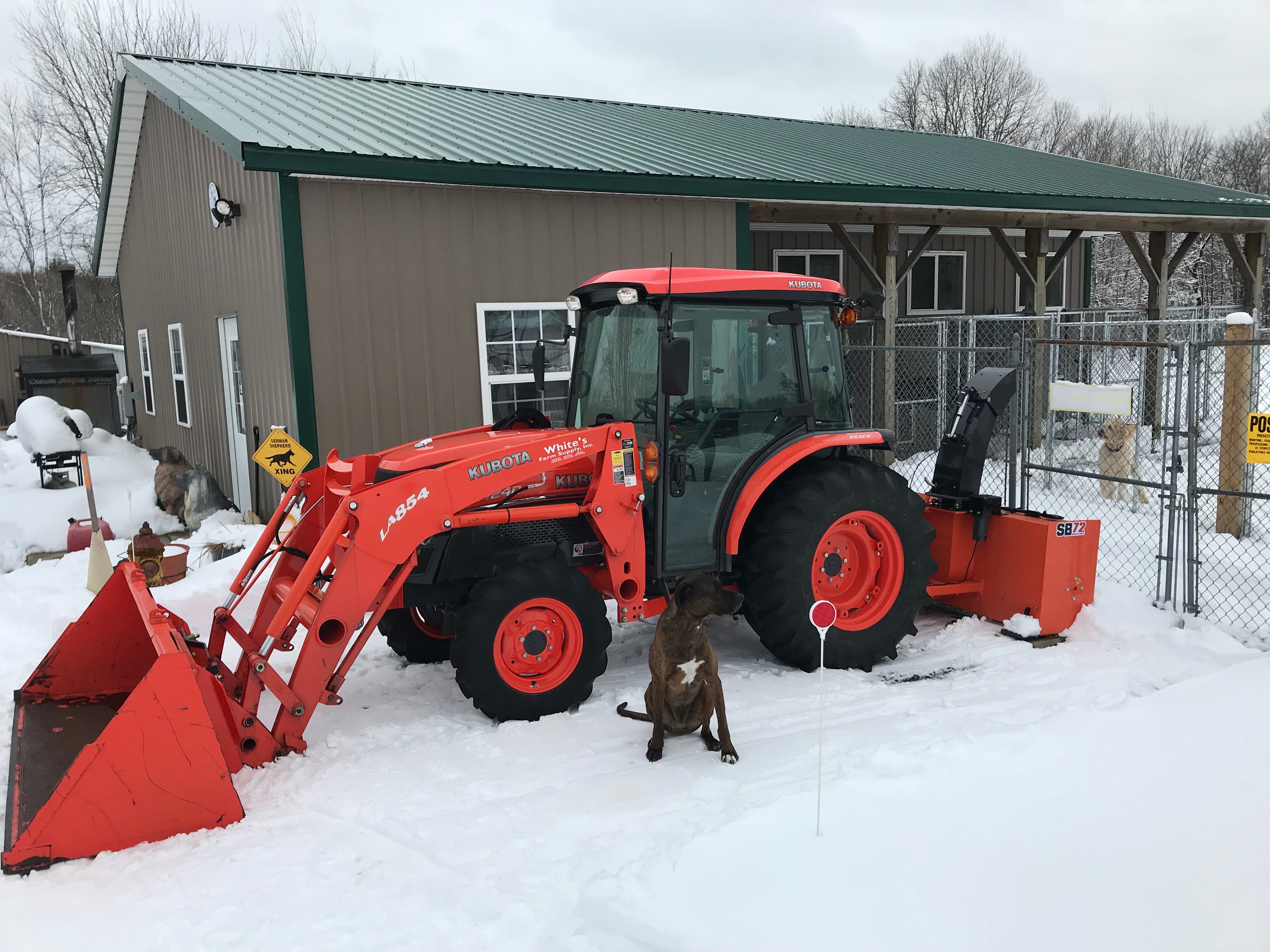

   / Which Implement #26
I live in upstate NY and used an open station tractor with a snowblower last year. The light, fluffy lake effect we get will coat you completely and it ain't no fun! I now have this set up and use the snow bucket for anything under 1.5 feet. The benefit over a pusher besides being able to use it for light materials off season, is if the pile of snow in front of you grows too big to push(I do a long driveway) you pick it up and dump it off to the side. IMG_1820.jpgIMG_1822.jpg
