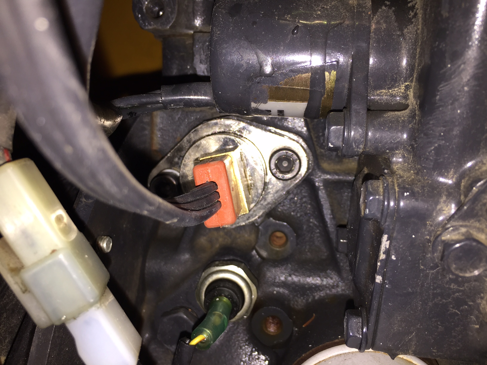

The picture is from a sc2400 that belongs to a coworker of mine, it didn't take him long to install nor was it complicated. It works well from what I hear. I have a different model, but same brand, heater for my LX, that works well. Only an hour so use is needed prior to startup. Before a storm I'll leave the LX block heater plugged in the garage, but breaker off. The morning after a storm I flip the breaker to the garage, drink some coffee, check TBN, then go out and start the tractor. 0 to 20 degree temps are common here.
Edit: I would probably add, some coolant will dribble out when you install the heater, just top off the coolant when you're done. Don't bother draining the whole block unless you're due for a fluid change.

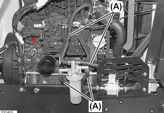

Got the heater and was looking at it today. On my sc2400 there is no place to bolt the heater in. His looks like a direct bolt in? Mine must be different I guess. Not sure. He did not drill for the bolts did he?

It should bolt into where the red X is, after you remove the freeze plug. No drilling.

I see what your saying but mine is different. I have no bolt holes.

Nuts. The bolt holes should already be there. Can you confirm the engine model in your SC2400 and upload a pic of the freeze plug area?
