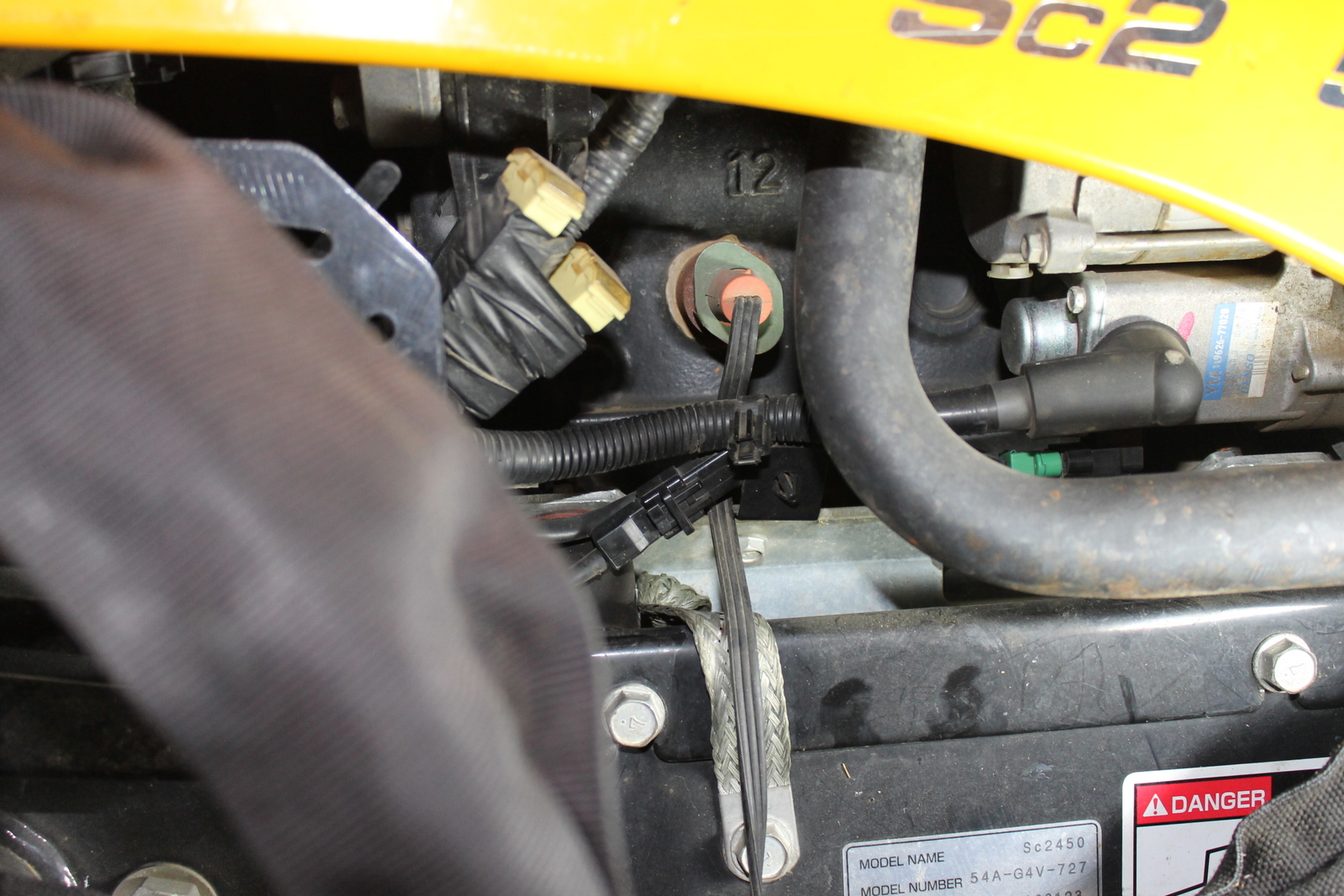

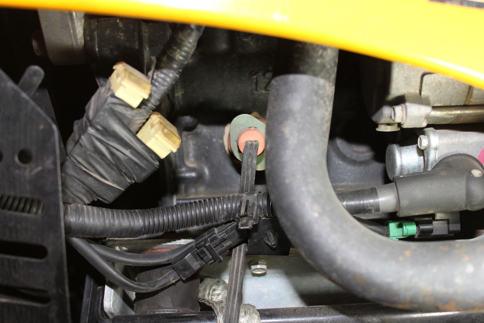

I went out and took pictures of of the block heater on my Sc2450.
The end is the orange circle with 3 wires, just to the left of the starter.
Hpoe this helps.
   / Which oil pan heater for Yanmar sc2400? #12
Thank you msb1766, I'm wondering if screamin400 has that same engine block, which doesn't take a bolt-on block heater. Can you tell us the make/model of your heater?
I feel bad about this mixup. My friend has the a 2400 and I helped him track down that other bolt-on heater for his 2400. I was not aware of any block variations in the 2400/2450 models. Doh!

I do not know the make or model of the block heater my dealer installed it when I bought the tractor.
I will try an look at it more closely to see if it has any markings on it.

My dealer may have put in a universal block heater in my tractor, I know for sure the block heater is installed in the middle freeze plug. I do not know if
it is a threaded freeze plug or not.

Have you looked at the opposite side of the engine block? My JD2520 (Yanmar engine) has the heater on the same side as the starter-operator's left from the seat. However, my JD 2305 (also Yanmar engine of similar size) had the block heater installed on the same side as the oil dipstick- operator's right from the seat. I would look closely at all of the "freeze plugs"- there should be 2 on each side. I would want to check that none of the 4 have the pre-existing bolt holes ...
