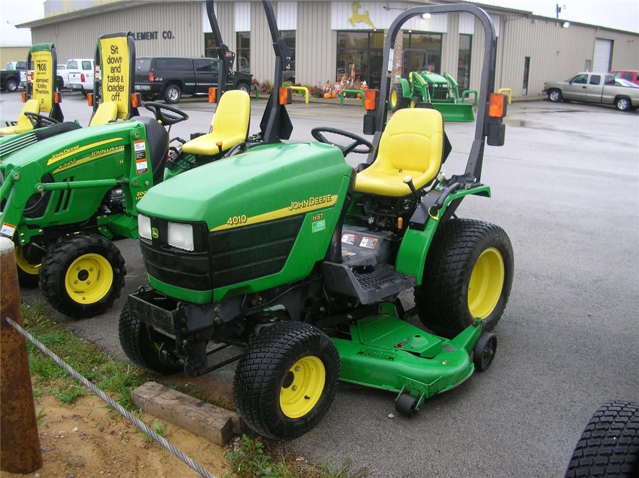

Have you seen a JD 4010? Its a lawn mower and is not going to do very much work.
Chris

my first tractor was a 4010. good machine but the hydraulics were pathetic. my 2305 is much smaller but could run circles around that 4010. the 18hp wasn't enough to get any real work done, so I stepped up to a 4310. kept it for improvements, then sold it to a buddy, now I have a 2305. great little machine. hydraulics are MUCH better, engine is more powerful, and the loader can actually get something done.

It's a nice looking lawn mower. I can't get over the cost of that used. I know someone who just bought a Montana 4940 (49HP 4x4 with FEL) 2 rear remotes and shuttle shift and it was only $19275 brand new. I guess i'm used to having a tractor with a cheep poulan lawn mower for the yard. I dislike my poulan, but it was only $800 and i've had it for 10 years so I can't complain too much.
