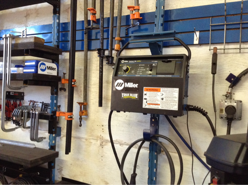

OK. Back on rack here. Neither of those units turned out to be available. I wish when people sell something they would take down the ad or at the least call or email back. Rant off. Now I found a 375 miller spectrum plasma cutter. Thoughts? $650.
Carol, I have the older Spectrum 300 ( also 27 amp). I bought it new over 15 years ago. I think it is rated 3/8 inch but I feel that it grossly underpowered. I leave it as a dedicated machine for cutting sheets of material 10gauge ( a little thicker than 1/8") or less as I don't have a big shear.
