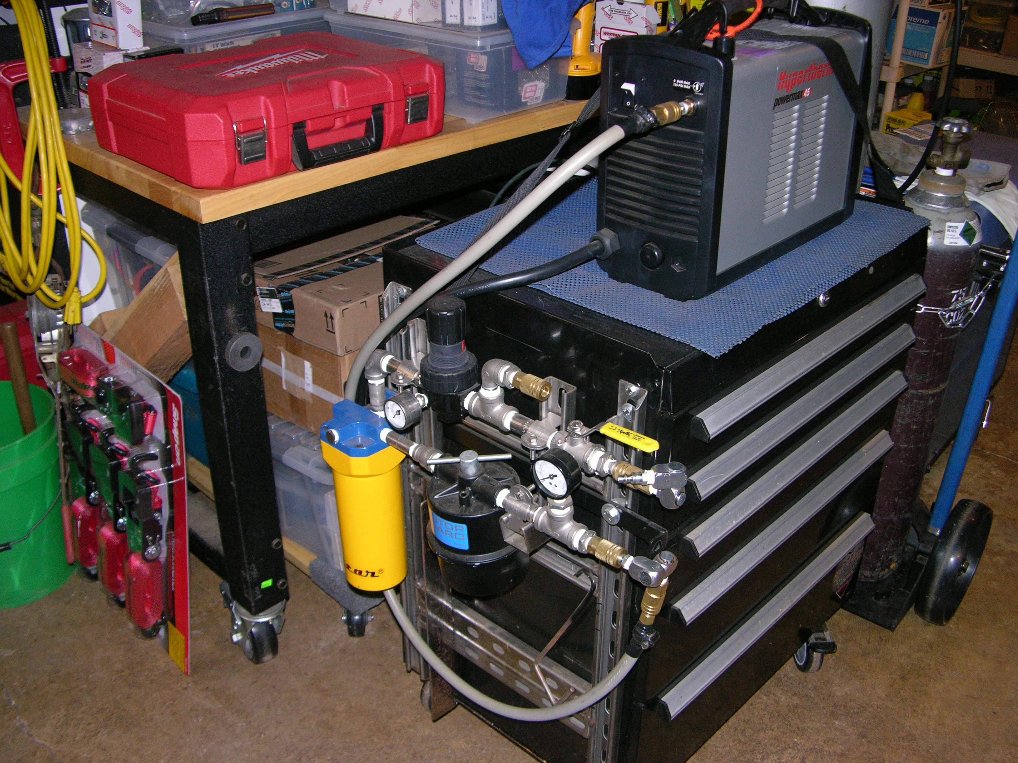

Carol, I have a PM45 - you'll need to get thicker projects than the ones you're working on before you want more. I've cut up to 1 inch stuff with mine, it's kinda slow at that thickness but does a good job if you practice controlling your torch travel speed.
Just when you thought you were home free... Whatcha got for air? You'll need CLEAN DRY air, at least 6 CFM @ 90 psi minimum.
This is what I did for mine - The yellow thingie is a painting filter, and the fat black thingie is a Motorguard filter - air from the compressor goes thru the painting filter and then the Motorguard, and the combo gives me very dry clean air. I'm stll on my first set of consumables - not that I've used it a LOT, but I bought the PM45 just over three years ago. The smaller black thingie with the gauge on it is a pressure regulator, because the PM45 wants less than 135 psi input, and my compressor puts out 175.
If your air isn't clean and dry, you will go thru consumables quite a bit faster, and they're not real cheap.
Any other advice I could give has already been mentioned here, enjoy your new machine... Steve

Steve I like your setup. I don't like the use of gear type hose clamps on air hoses but I did notice you taped over the sharp edges for protection on the regulated side. Just wanted to mention that a buddy of mine working in an auto body shop got permanently disabled when a 'repaired ' air hose let go and the edge of the stainless gear clamp went whipping around slicing his arm and leg in the process.
This was a couple of years ago and he was retrained and now works as an estimator in the same industry.
Didn't mean to derail, but felt that I should mention this.
Terry

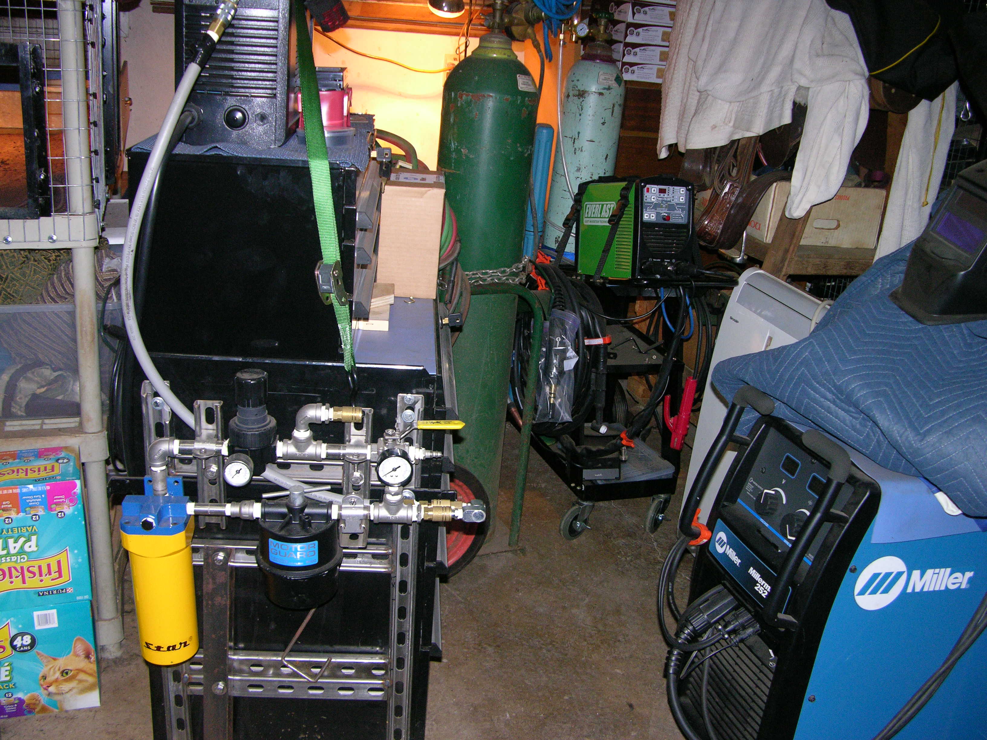

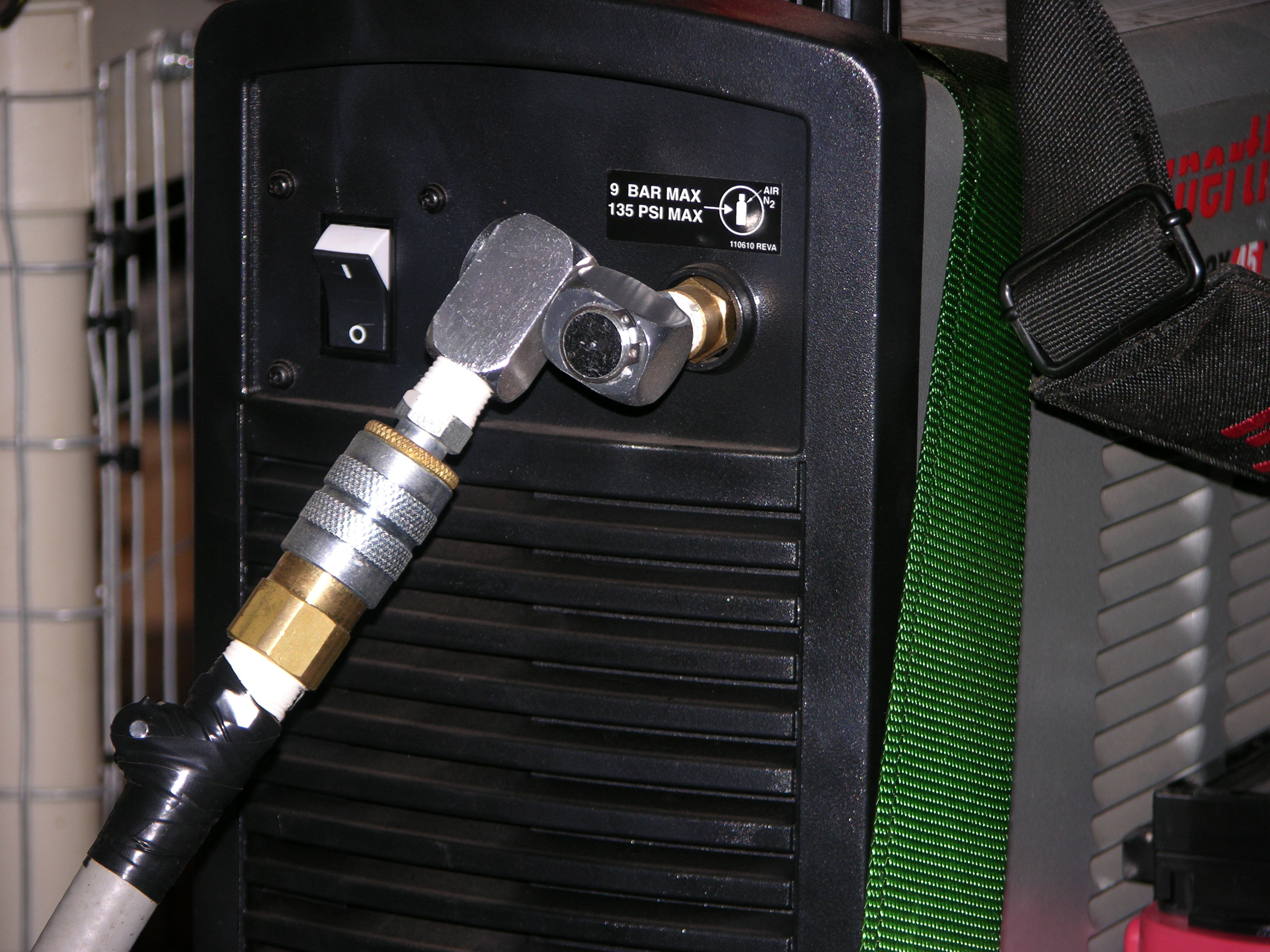

Terry, I don't like hose clamps much either, but sometimes they are the lesser of two evils - that pic is an old one, since it was taken I've added a 3 drawer "intermediate" section between the PM45 and the roll-around -
But more important, I shortened the hose to the cutter and ran it BEHIND the filter/regulator assembly - I also removed the QD fitting from the rear of the PM45 and added another of those swivel fittings - I didn't like that much "lever" on something that attaches to the internals of something I'd rather not have to repair :rolleyes: -
It's much neater now, and if the hose ever lets go it will have less free length to whip around :thumbsup:
Eventually I'll get around to making a different retaining setup - I know how much you hate straps, kinda like I hate "Un-shiny" metal :D ...Steve
Carol, sorry if we shanghai'd your thread but you may wanna borrow some of these ideas for YOUR new "friend", if not just tell us to MYOB :hissyfit:

- But more important, I shortened the hose to the cutter and ran it BEHIND the filter/regulator assembly - I also removed the QD fitting from the rear of the PM45 and added another of those swivel fittings - I didn't like that much "lever" on something that attaches to the internals of something I'd rather not have to repair :rolleyes: :
Carol, Shiny Steve makes a good point concerning leverage on your plasma's air inlet. His swivel fitting choice is a good one, but if you are like me and not as financially endowed as Steve, here is my cheaper alternative.
Terry
