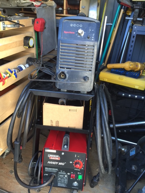

Love the pictures, guys. Picking up many good ideas. Keep'em coming. I don't mind the banter.
Tomorrow I'll get the machine on the cart and start a list of what is needed in terms of filters, fittings, hangers, etc. And I'll get a picture or two. :)

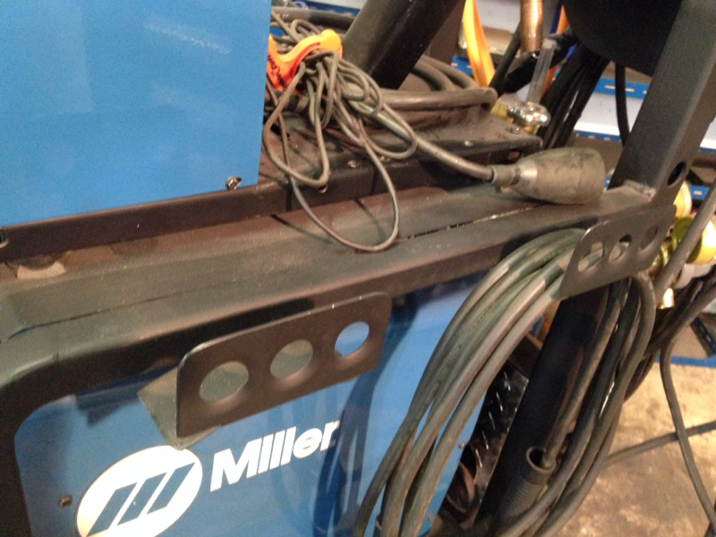

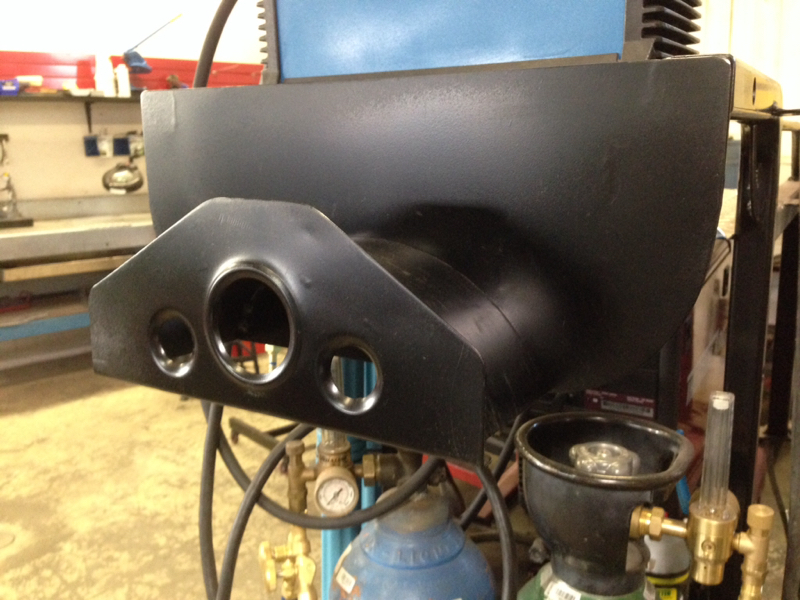

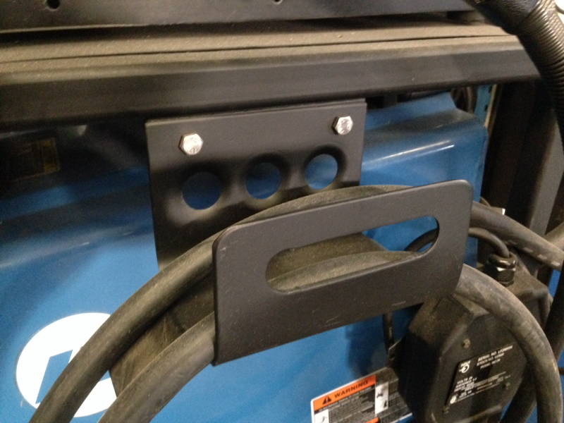

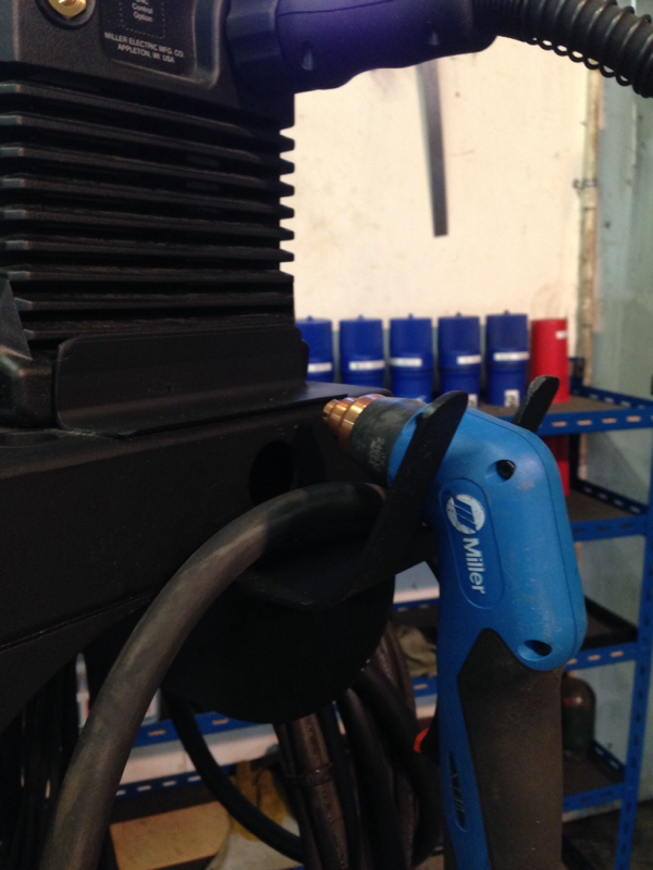

Here's a few pics for hose/cable management ideas, Carol. All were cut from 10 and 16 gauge sheet stock with my plasma cutter.
Terry

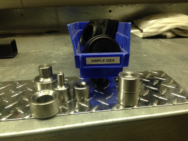

Back atcha... - all seriousness aside, how'd you get that "punched out thru a piece of balsa wood" look on your "cooling holes" ? Looks pretty neat... Steve
   / Which plasma cutter? #57
Steve I went back to the shop to snap this pic for you. The holes were cut with Roto Cut sheet metal cutters or hole saw, then punched with these dimple dies. They will work on thicknesses up to 1/8". I have a 2"D. one that punches the hole and dimples in one operation but haven't got around to building a jig for it yet. image-2920686989.jpg PS. If you require a response that may involve a photo please try to have your request in before 4PM PST. :D :D Terry
