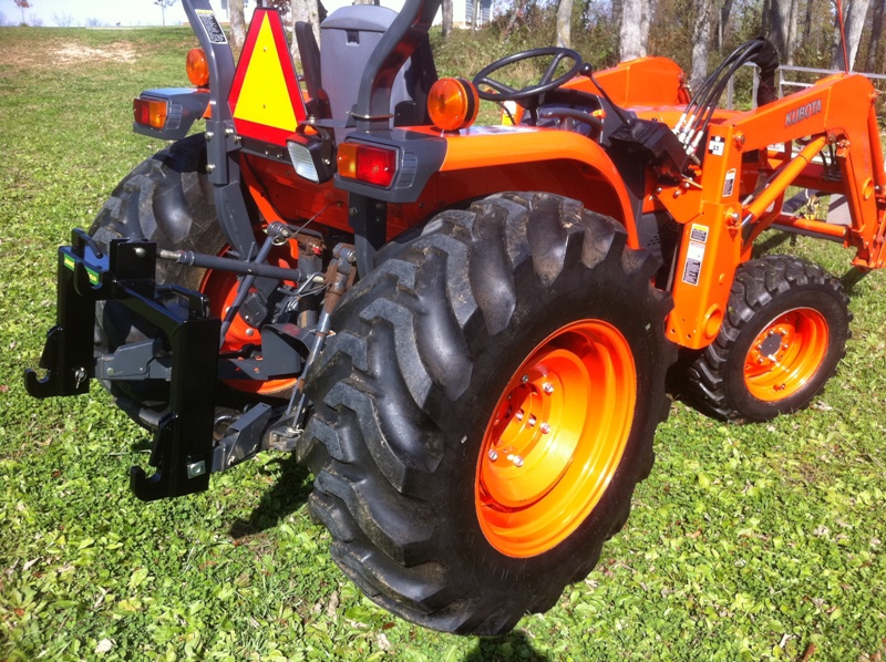

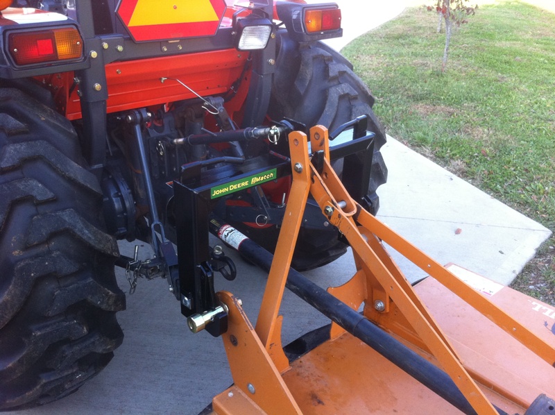

I love the JD iMatch on my L3830. Painted it black so it didn't clash with my orange. :thumbsup:
I do not like the cheap imported HF and TSC quick hitches. Deere or Land Pride were my only options. :cool:
