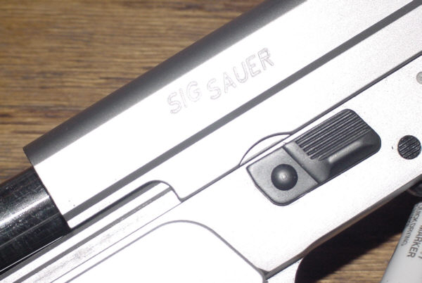

"Doesn't SIG also run the slide inside the frame rails? They have a good reputation (again, book learnin') for accuracy. "I am not certain but I don't believe they do. For my money the Sig is a little over priced, but does have a good reputation. They are accurate, but I have only shot the 9mm."Hawk, are you talking about competition when saying they are "a little rough" out of the box? "I mean the fit and finish as well as accuracy. Accuracy in any Browning designed pistol is very dependent on the fit of the barrel bushing to the barrel, and the slide to the rails, There is really a lot more to it but you get the idea. For mass production these parts are made to tolerances like everything else. If you replace certain parts with custom parts that truly "fit" together, you will usually see improvements in accuracy. The trigger group suffers from the same problems. If these parts do not fit right, or are improperly polished you get a heavy, "catchy" trigger, and accuracy suffers. Almost ALL of these things can be fixed. Unless you have some experience in reworking triggers I would send this out to a qualified gunsmith, you can buy a matched bushing and barrel for drop in fit, or do the lapping yourself.Now opinions vary here but I would recommend you get the trigger reworked to break "clean" at no less than 4 pounds for a .45. For carry purposes you may want the trigger to break a litter harder at say 6 pounds, but it should break clean. There should be NO creep. Some people like a "staged" trigger where you take up a little slack before things go solid and finally break clean. This is a personal preference thing.As for TZ they have really been coming on as competetiion pistols in the last few years. They start out reasonably priced, and are good right out of the box, and custom parts are available to really trick them out. Their compact .45 is in the $00 range but I have seen them for as little as $385.

<font color=blue>Doesn't SIG also run the slide inside the frame rails?</font color=blue>
Not if I understand your question correctly. At least not on my 220S. See attachment.
