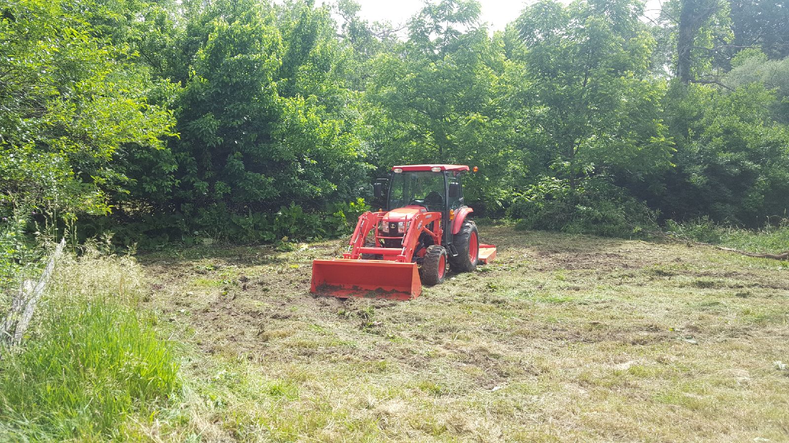

I have a Kubota Grand L3560 (35HP) and use a LP RCR1272. It has the clutch. I have mowed some thick grass with it. I can tell you in thick grass, I pull slow, but now that we have some of the areas mowed back, the second cutting I was able to do in medium gear, without any issues. You can get an idea from the picture that type of area that I've been mowing in.
