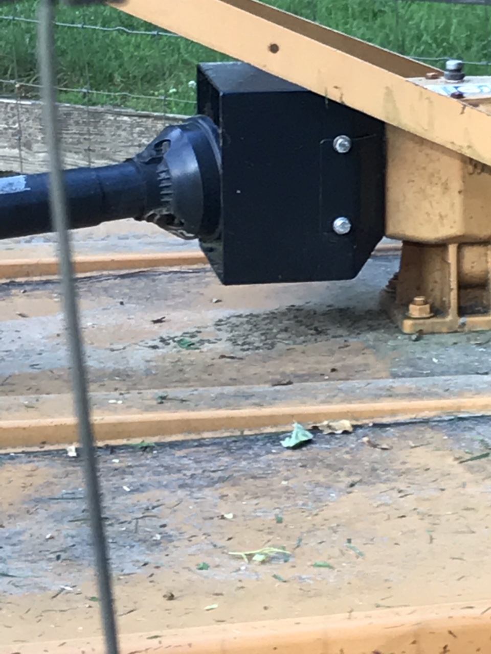

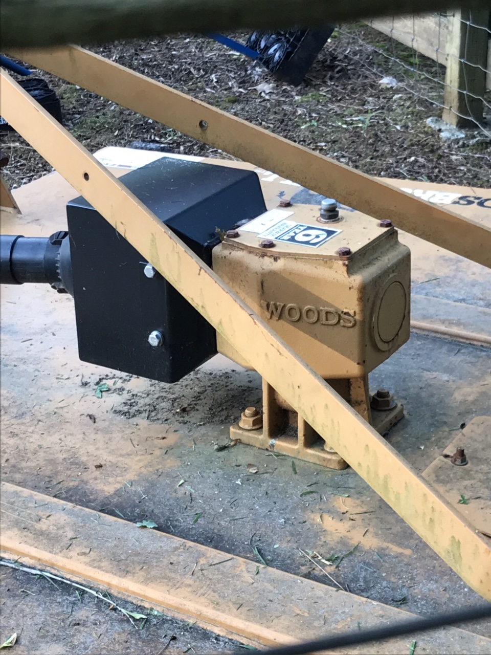

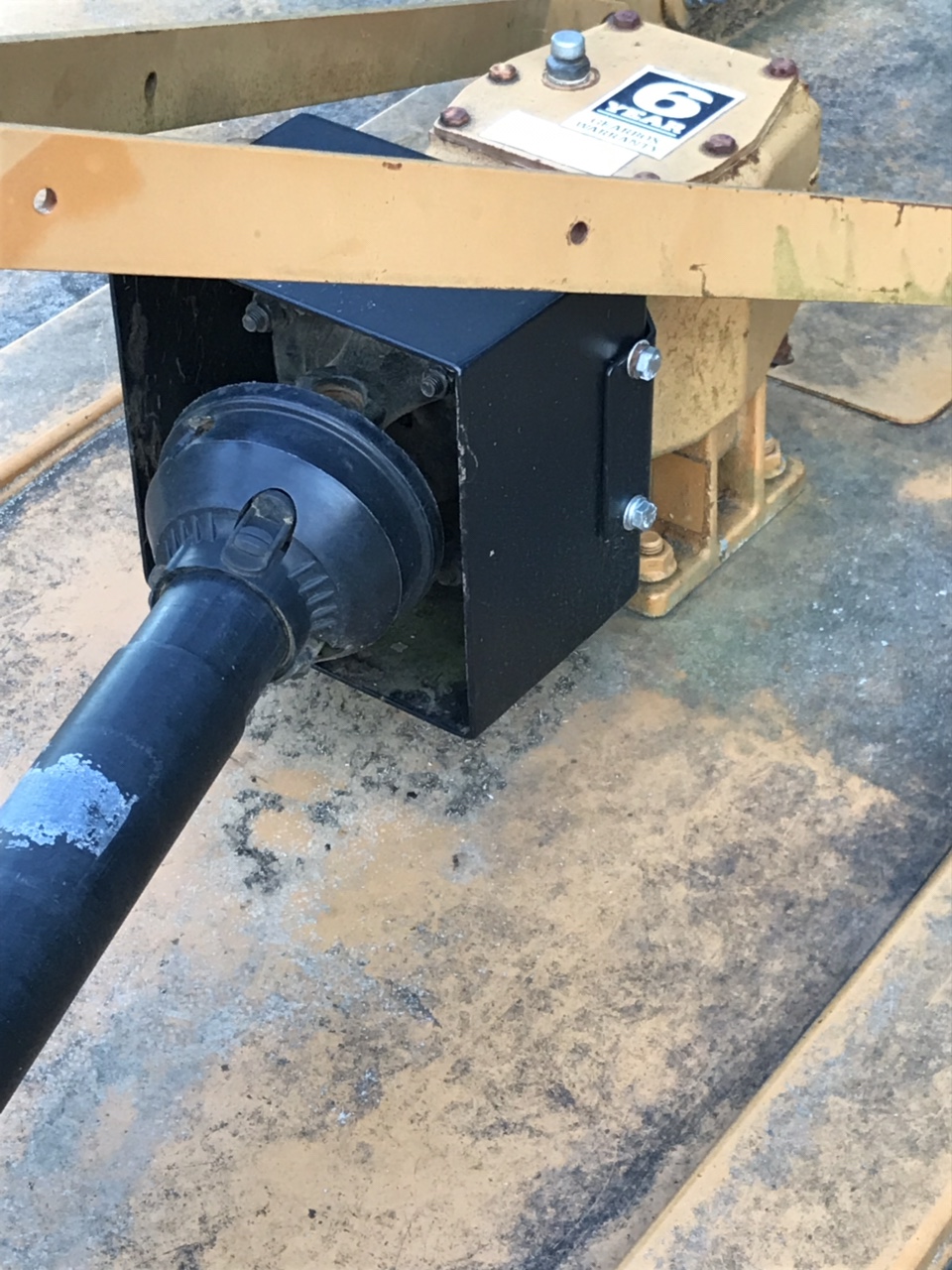

I made a metal guard to cover the clutch in place of the broken plastic one. There’s a small door on each side so I can access the bolt that holds the clutch to the shaft.
