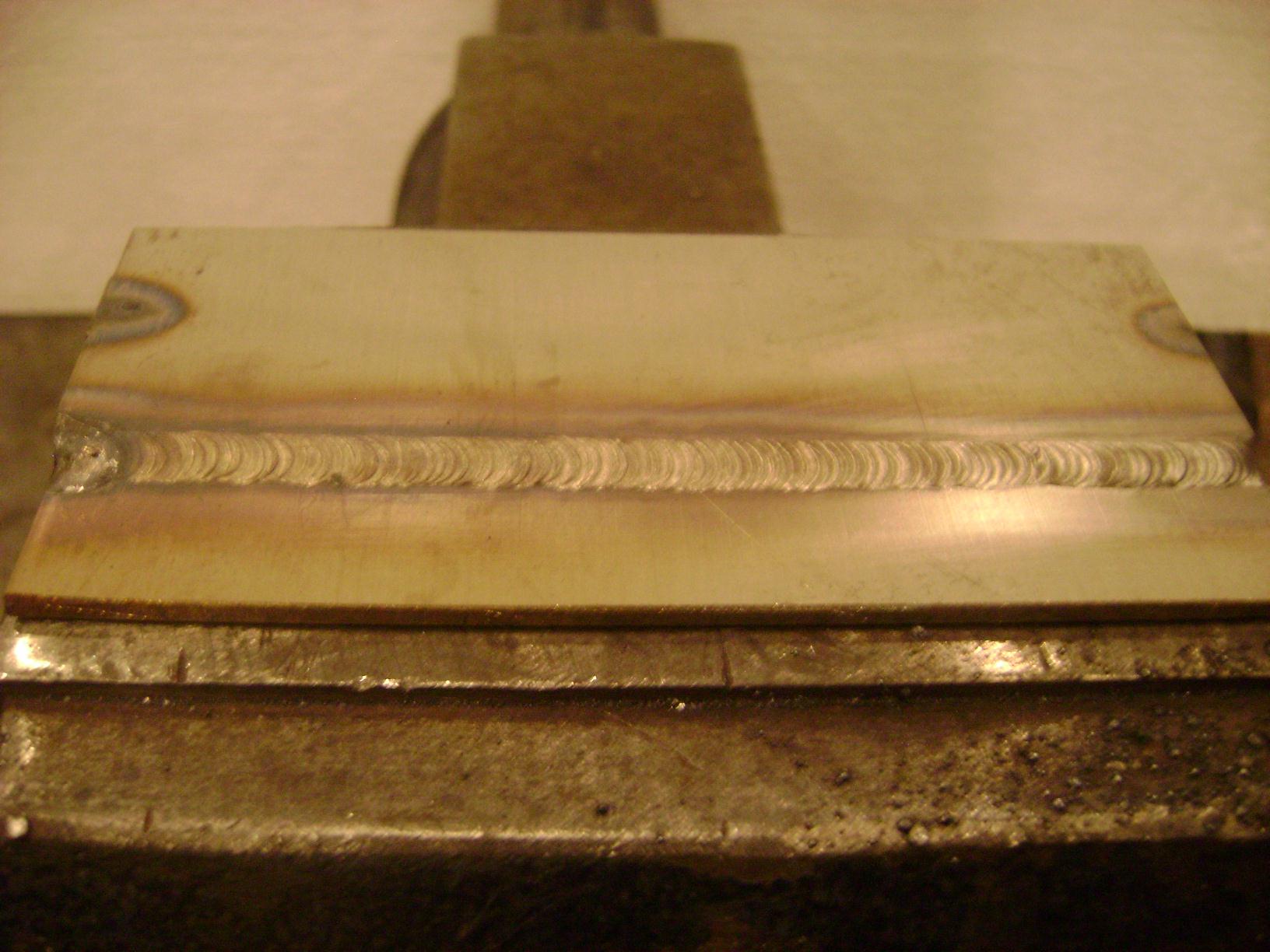

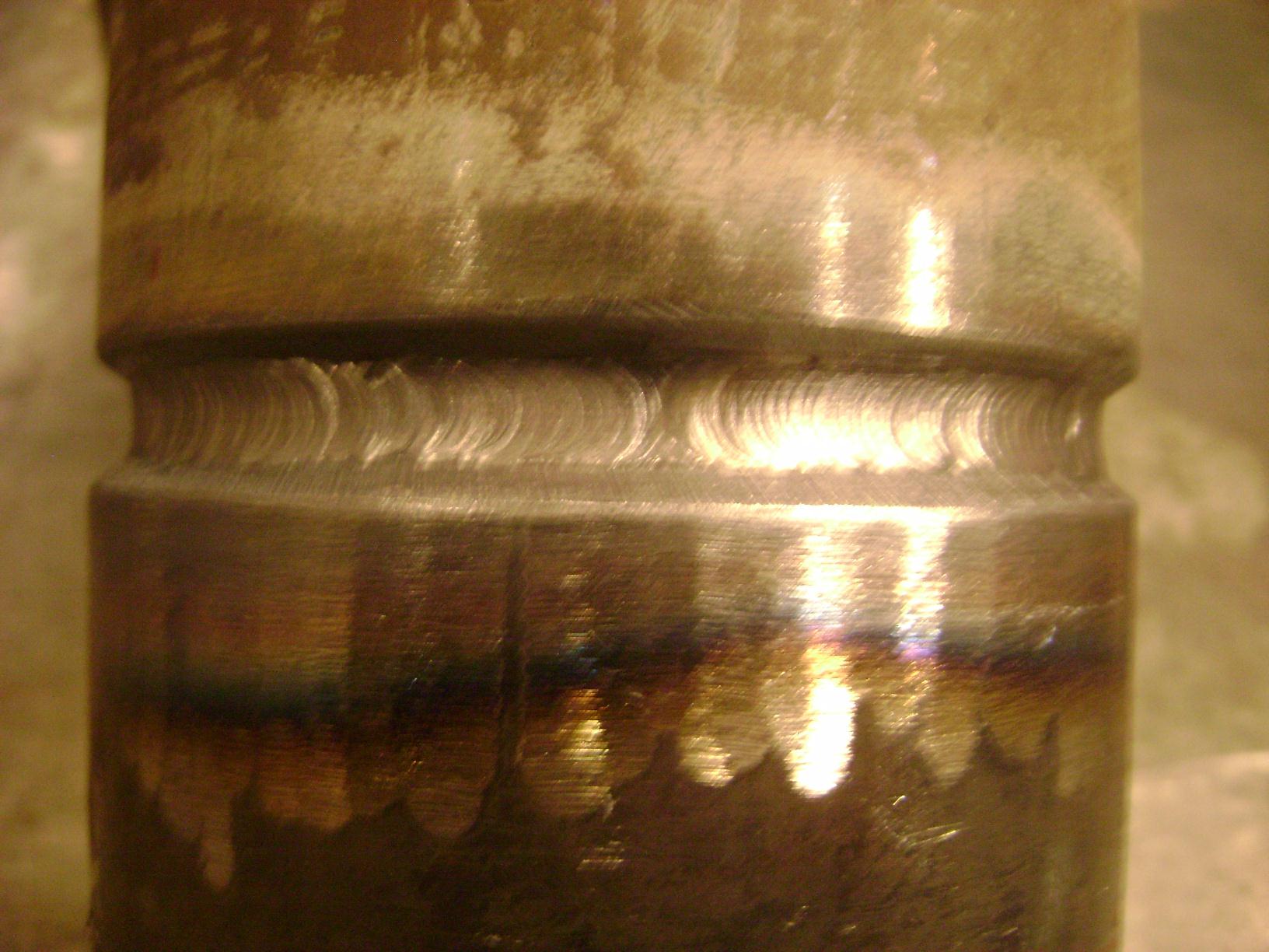

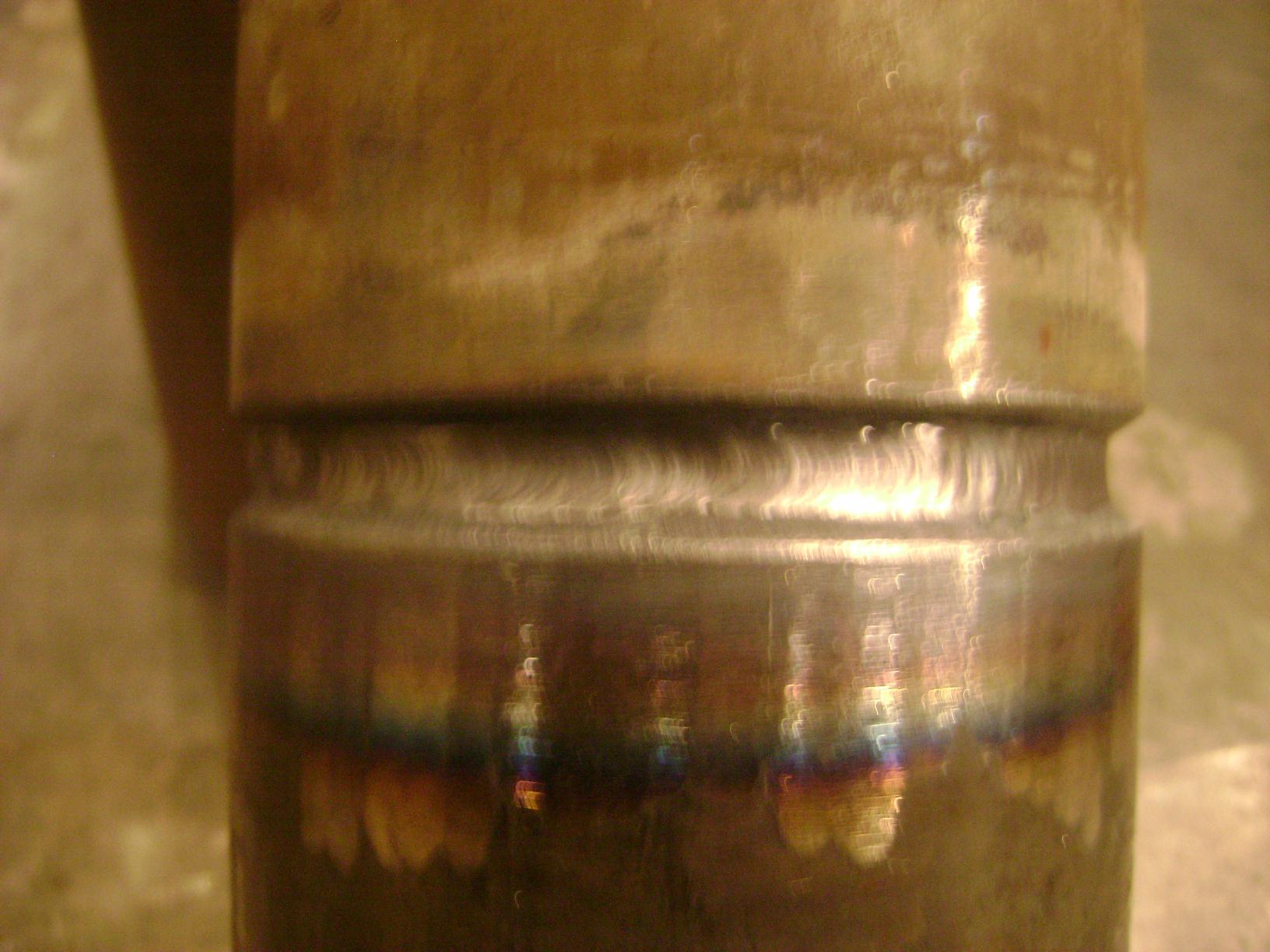

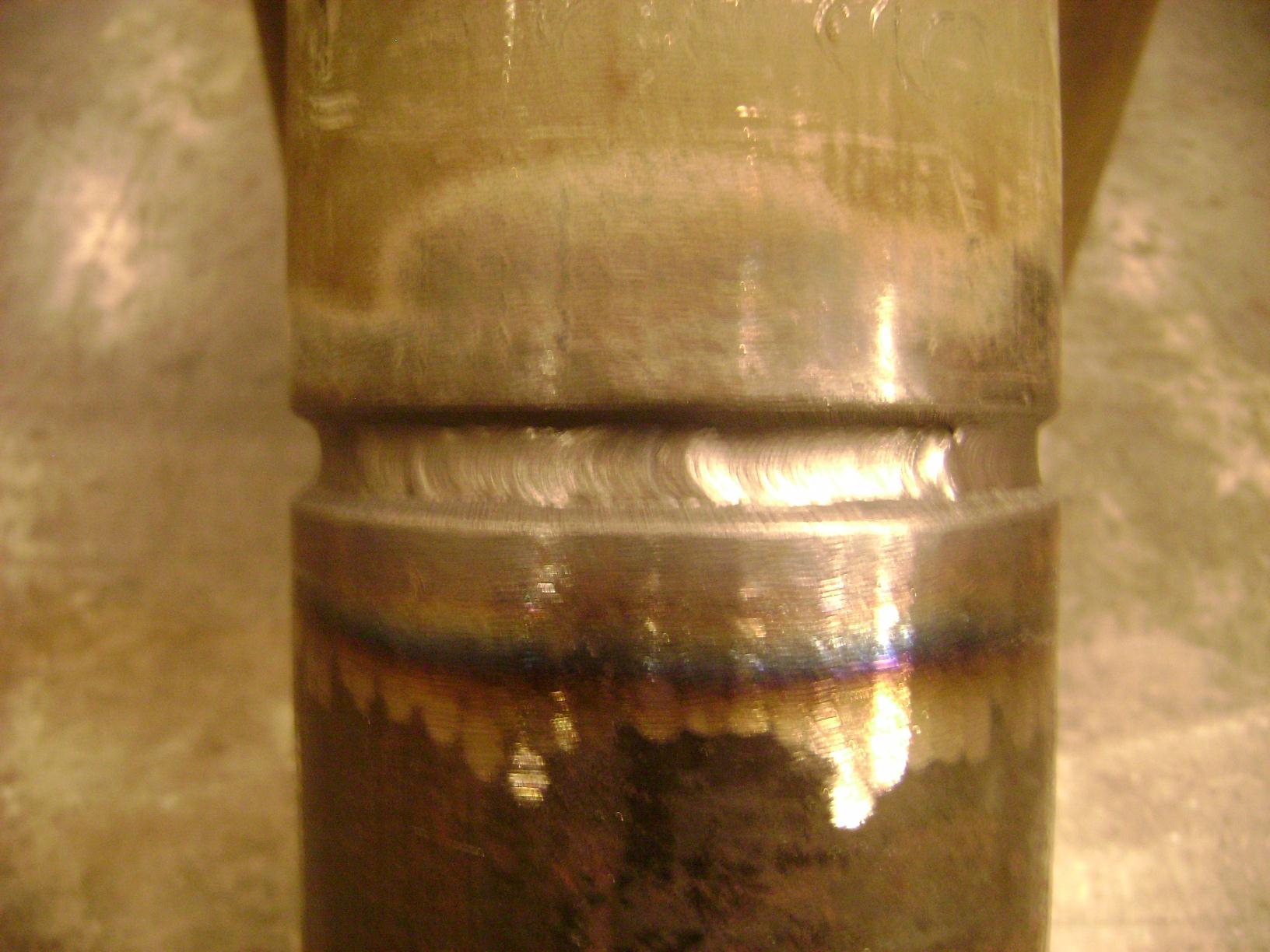

k0ua, Shield Arc, or Haywire (or anyone else that has an Everlast PA) - have any of you used yours for TIG?
   / Which Stick Welder for a New Welder? #86
I have, it has a really nice crisp arc. Here's a stainless Tig weld, and some pipe welds with the PowerArc 200.

No, but I have though about it pretty hard, and priced the stuff. about 300 bucks, which is more than I paid for the welder.. hopefully some day..
James K0UA
