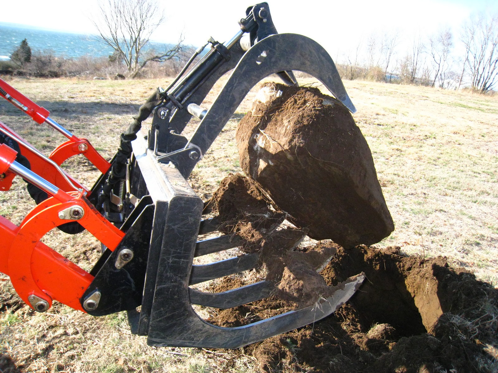

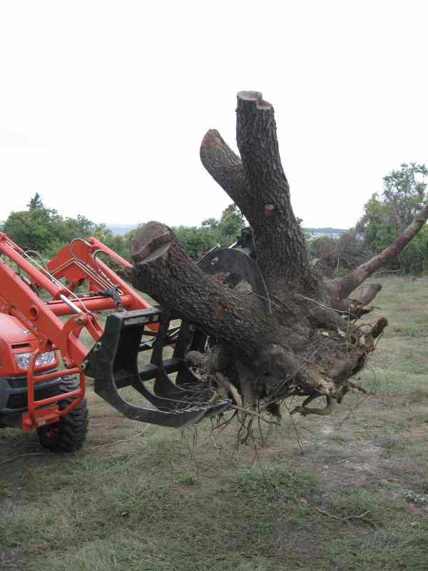

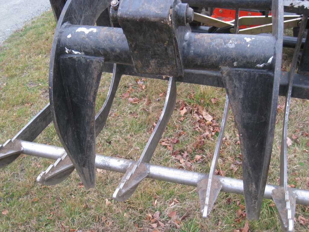

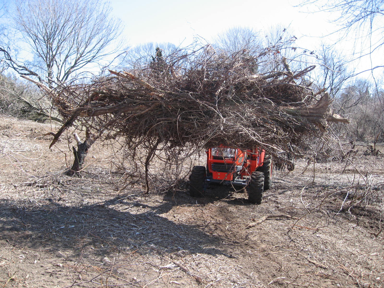

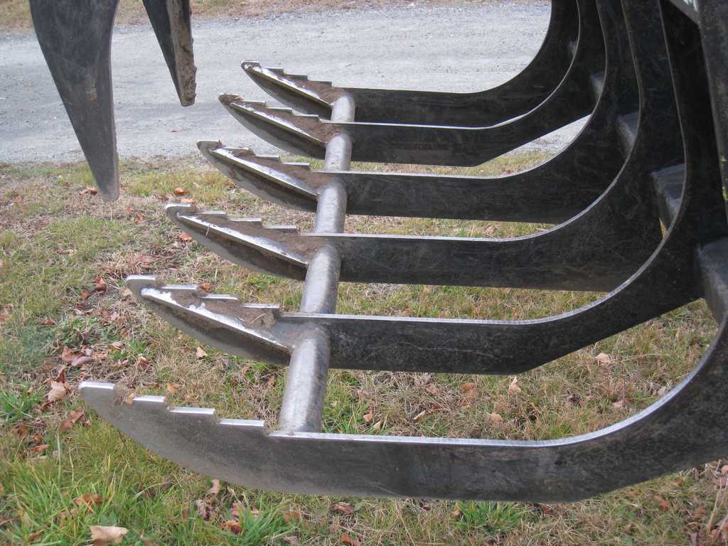

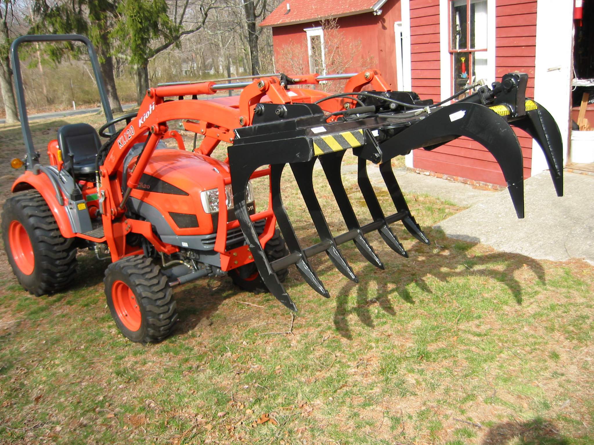

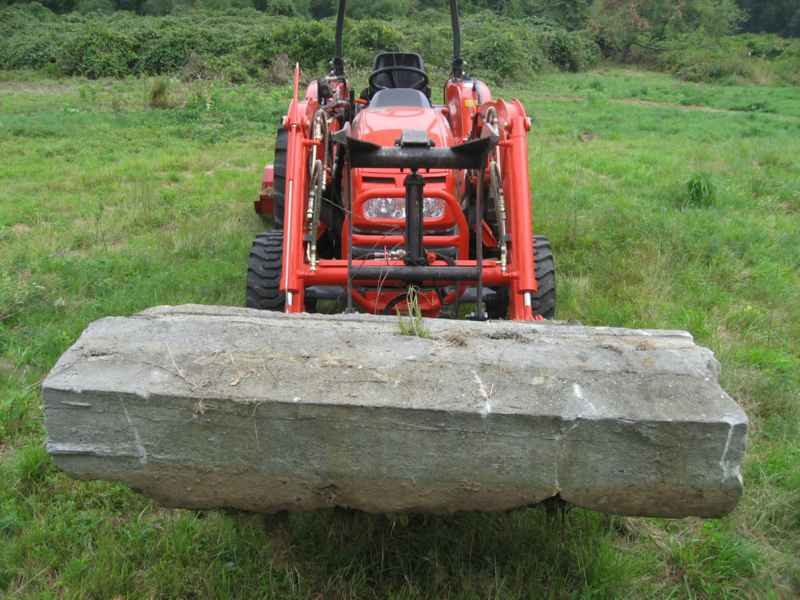

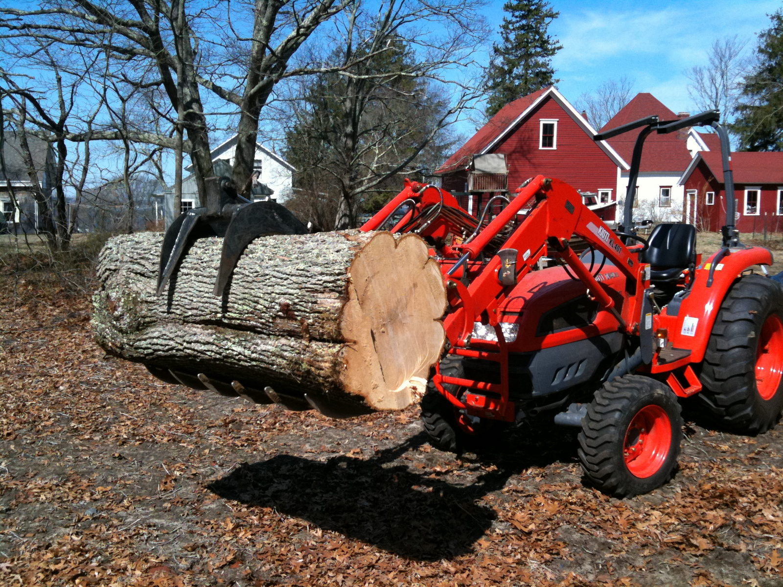

Sadly they went out of business a few years ago when the owner John Millonzi died. The style of grapple they made was very similar to the WRLong OBG2 except that the bottom tines curve up slightly. I would change little if I were getting another grapple. Probably would make the top grapple a little wider (mine is about 15'-18") and I would beef up the top grapple arm a bit with gussets (which I have added) and add more protection for the cylinder but otherwise I wouldn't change it. 3/8" mild steel on the tines, 4x4x.25 on the square tubing and ?Schedule 80 pipe on the intertine spacers. Tough little bugger but pretty light. Millonzi claimed 280lbs but I think something around 325lbs is more accurate. It worked very well with my CK20 with 1070lbs of lift and does equally well with my current 2700lbs lift loader on the DK40. I've bent the upper grapple tines a bit (now reinforced with gussets) and busted one hydraulic hose on brush but otherwise it is just fine. It is the standard attachment on my FEL for about 80% of my work which is mostly clearing brush. Cannot imagine being without it.
