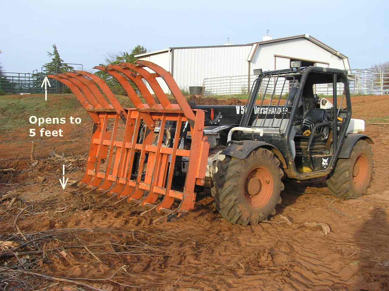

You are right that MOST grapple work doesn't require a jaw opening over 36" but depending on the type of task, this is a case where "more is better" with relatively little downside (assuming good engineering). Kind of on the same principle that most pickup truck work can be done with 2/3rds of the bed or towing capacity but it's nice to have the extra and it does get used. Again, you're right that picking up brush piles is probably the task where the biggest opening is most desired.

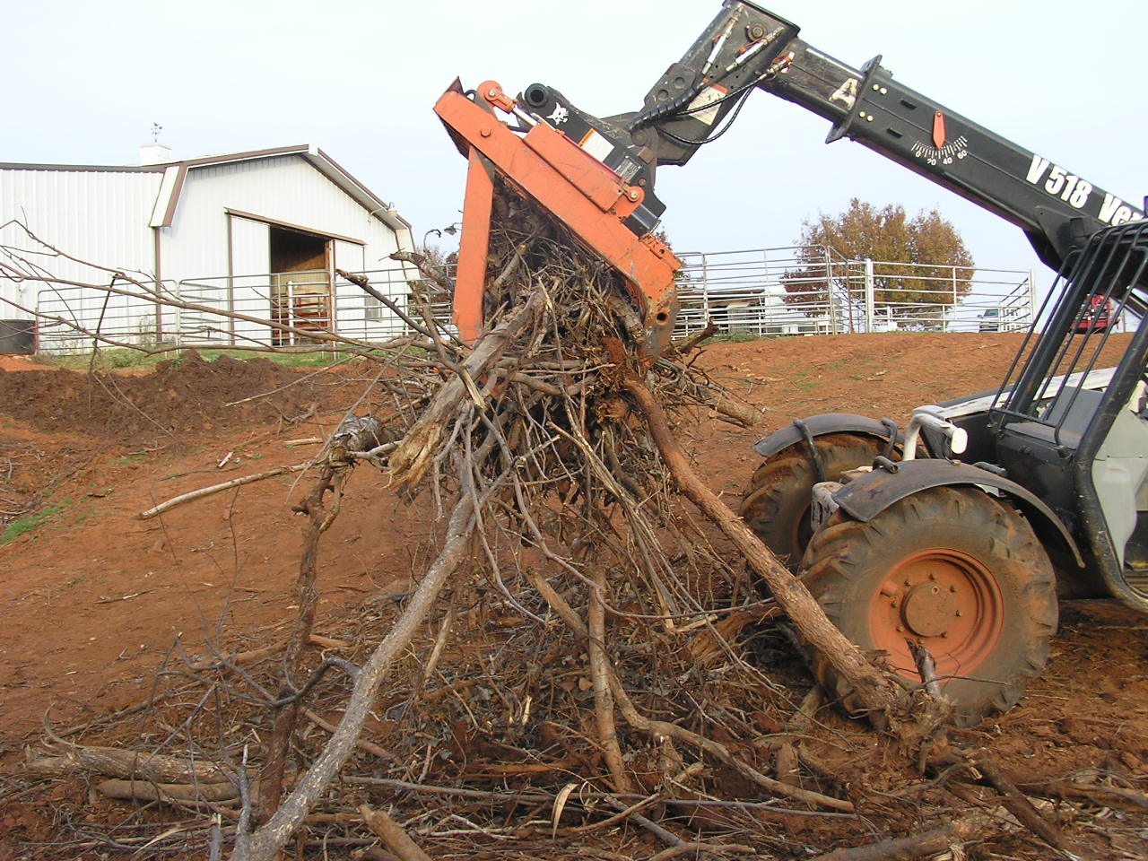

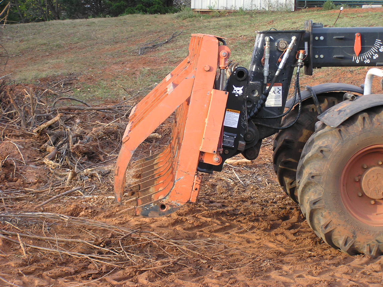

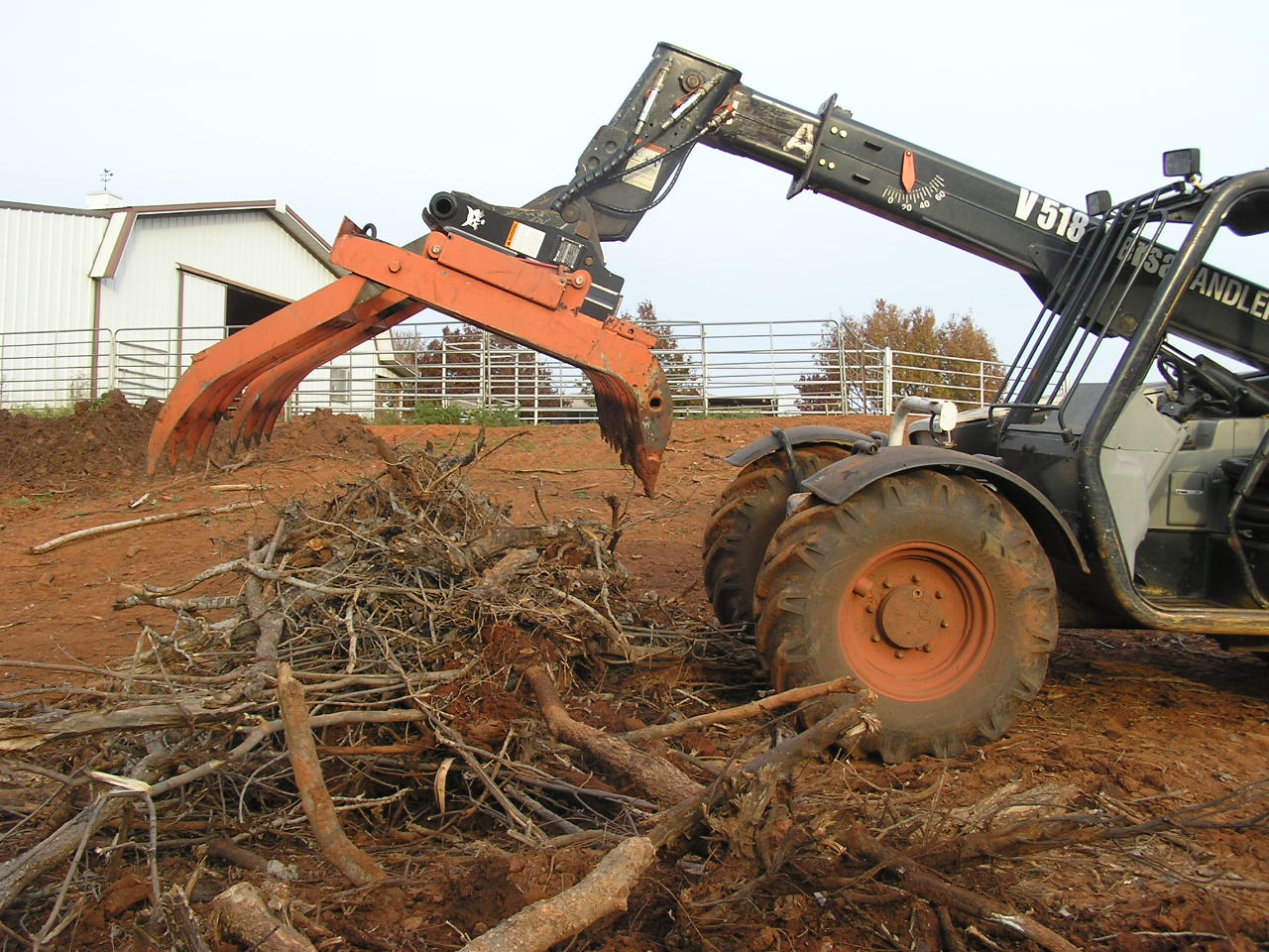

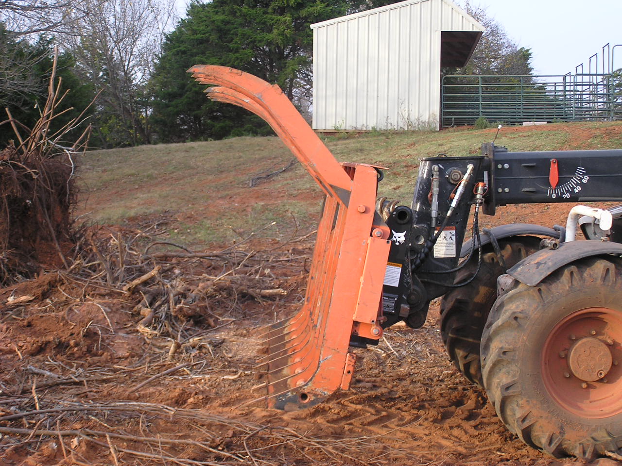

You are correct about not needing more than 30" for lifting trees or logs but brush is a very different issue. Brush capacity for a grapple is almost never limited by lifting capacity but rather by the volume that can be wrangled into the open jaws before closing. That is why the clamshell style grapples are popular for brush removal despite being very heavy for their size. Clamshells are king when just measuring max opening.
Yep, clamshells have no belly, it relys on the brush sticking together. That is why I sold this one!
   / Which type of grapple is best suited for... #243
I have used both grapples on the Toolcat, that is smaller than some compact tractors, so I think the pictures I post apply to the discussion.

Xfax in reading your posts here I can understand what you are getting at (brush related). Judging by your equipment it appears you have a business where these grapples are used OR you have a large spread that requires a lot of maintenance and up keep. Either or time is precious and valuable. I could see why you would want or need that opening to max out each load you grab. I on the other hand will probably be fine with my 40" opening. It has not been delivered yet, so we shall see.

I have a full load of brush on almost every bite. If I am clearing, I push into the brush until I have a full bite, clamp, then back out and stack. Then go in for another bite and back out and stack....... Once I am done clearing I have a heap usually the size of a school bus. The county regs allow only a 10' x 10' x 10' pile on fire at any one time so I have to feed it as it goes out. I need as big a bite as I can get to save time. 30" is kid size, way too small. I would say 45" would be adequate. 51" would be heaven.
